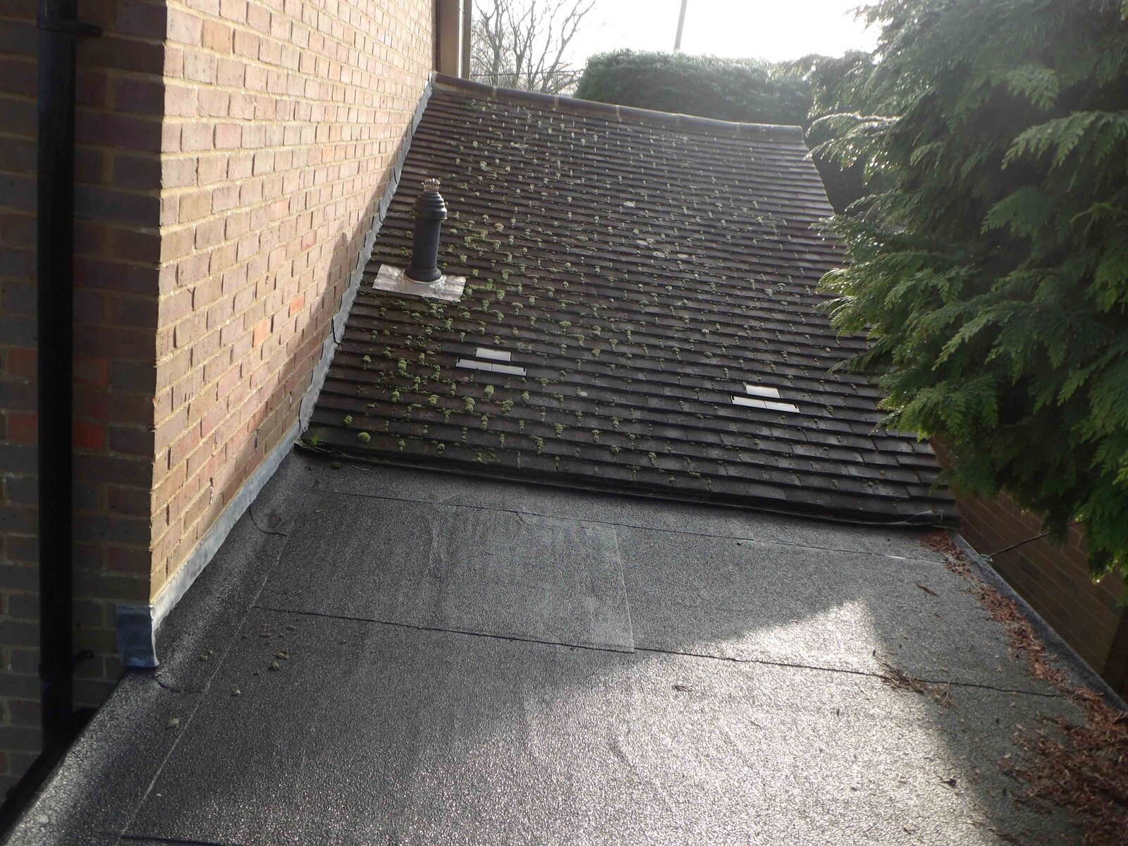

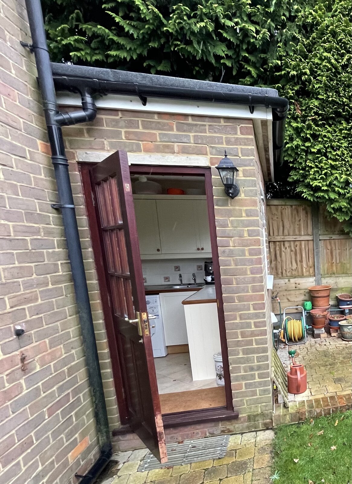

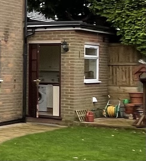

Hi,
Would really appreciate any experienced view on an approximate price range to convert a 9m2 ‘cold deck’ flat room to an EPDM 'warm deck’.
The roof is in good structural condition but I’ve been informed by a surveyor that this should be upgraded to a warm deck standard.
I'm working on the assumption this would mean stripping right back to the joists with new boards, membranes and insulation added.
I’ve attached a couple of pictures. Any thoughts would be highly appreciated…
Many thanks!

Thanks that's helpful, had not considered the potential for additional planning reqs to raise slightly. The 1970s roof was recovered in 2018 by the current owner. There are some moderate damp issues originating from the roof and my surveyor is suggesting that it should have been converted to a warm deck when it was replaced, in line with building control standards. So I'm trying to gauge 1. whether the people that recovered the roof ignored modern standards/controls 2. roughly how big a job this is to rectify (££). It's a fairly small roof section over a 3x3 utility room. Many thanks.
It can be a cold roof and vented as part of the garage roof. There was no requirement to make it a warm roof
Any leaks from a roof two years old should be able to be repaired, not the whole roof replaced. Are there leaks or is it a condensation issue?
