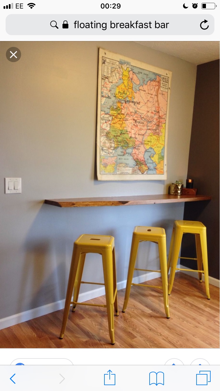

This is what I was thinking about
One in pic is around 30mm thick , suggested fixings you linked too require 15mm hole in your 18mm shelf? Leaving it supported on less than 2mm of timber .?

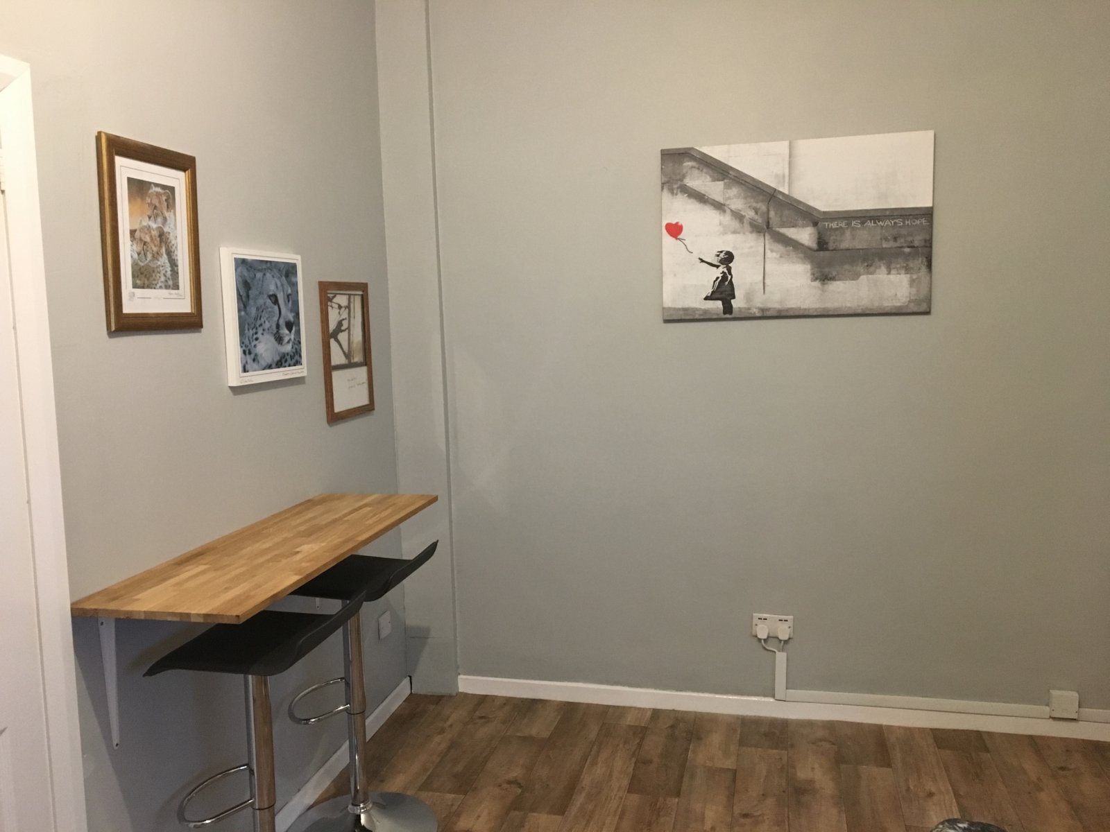

Got a hobby board from HomeBase and a few brackets.

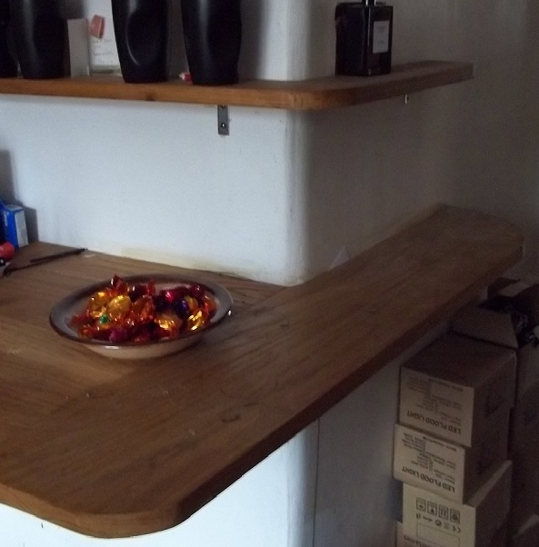

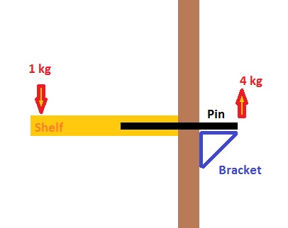

Two options for a strong "floating shelf"
In a thin wall if space permits use a bracket on the other side of the wall to take the twisting load of the pin in the wall. Either just pin and bracket or extend to have a shelf on both sides of the wall.
Or as in my kitchen, wrap the shelf round a corner.
Cheers. Tbh I don’t mind the brackets. I have three and they are going into a really sturdy brick wall so it’s extremly sturdy.
