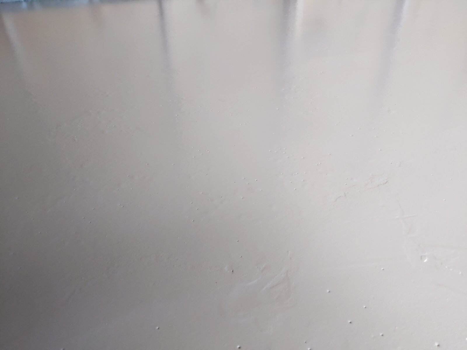

I've got a floor I want to paint to hide some imperfections and pin holing.
It doesn't need to be perfect - though I did go and get some floor paint from the local industrial supplies and it seems to have just highlighted everything. 90% it's polyurethane will have to check.
I've done a few coats so far (4), and if anything it seems to make the pin holes worse, or at least stand out more.
Any suggestions? Or should I go and find a harder paint like the epoxy resins? Considering it would probably have to go on top of this paint though...
Why do you just fill the pin holes, quick sand off, and carry on with the paint you already have?
Fill with what? If I hadn't have painted it already I would have assumed a bit of filler or so - but as its painted i'm not sure. There is also a lot of them!
Looks like air bubbles in the paint that are popping.
There were pin holes in the surface below. I had hoped the paint would have been thick enough to cover it up.
are you using a roller?
Yes - I was using a woven roller and when the paint was thinned was causing some on bubbles the surface, so changed to a foam roller which is much better. Though without thinning the paint it rolled on well enough.
I would probably bung in some 2 part wood filler, although I expect there is something better.
If you use filler, scrape off all excess immediately, so the filler is only in the hole.
You DO NOT want to mess about sanding loads of excess off - you will not not like it.
I actually have some 2 part wood filler on order, so will give that a try.
I had started on this though people may not have realised this is all over ~26m2 and not just a bad batch.
I'm going to look at putting a fresh layer of self levelling down (with a spiked roller) - hopefully will raise the low end of the workshop at the same time.
Will the PU paint need to be taken off before the new layers of self levelling go down?
