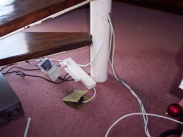

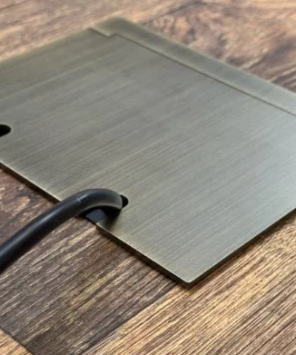

A problem I've seen once with floor boxes in a multi-use space was careless use leading to damaged flexible cords. The room had a supply of "socket posts" which were plugged into the floor boxes and frequently moved around, but people did not take the time to properly route the flex and close up the floor boxes after moving them around leading to flexes being trapped under the box lids.

People are idiots. I keep hoping that those sorts of idiots that leave an extension lead trailing through an aluminium patio door then slam the door on the wire would succumb to Darwinistic weeding out of the gene pool but somehow they manage to evade it!

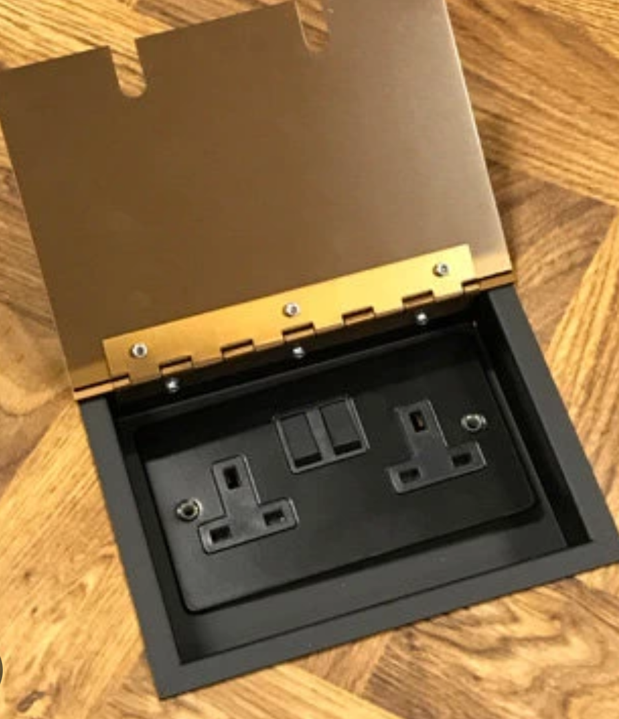

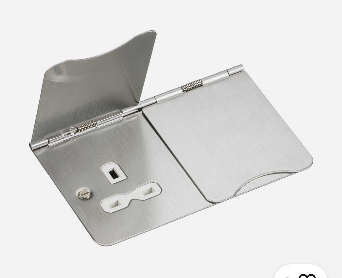

There are two groups of people in this topic.
One group is posting about floor sockets like this:
Flush mounted and usually all metal in my experience... also in my experience an accident hazzard and not commonly permitted in workplaces

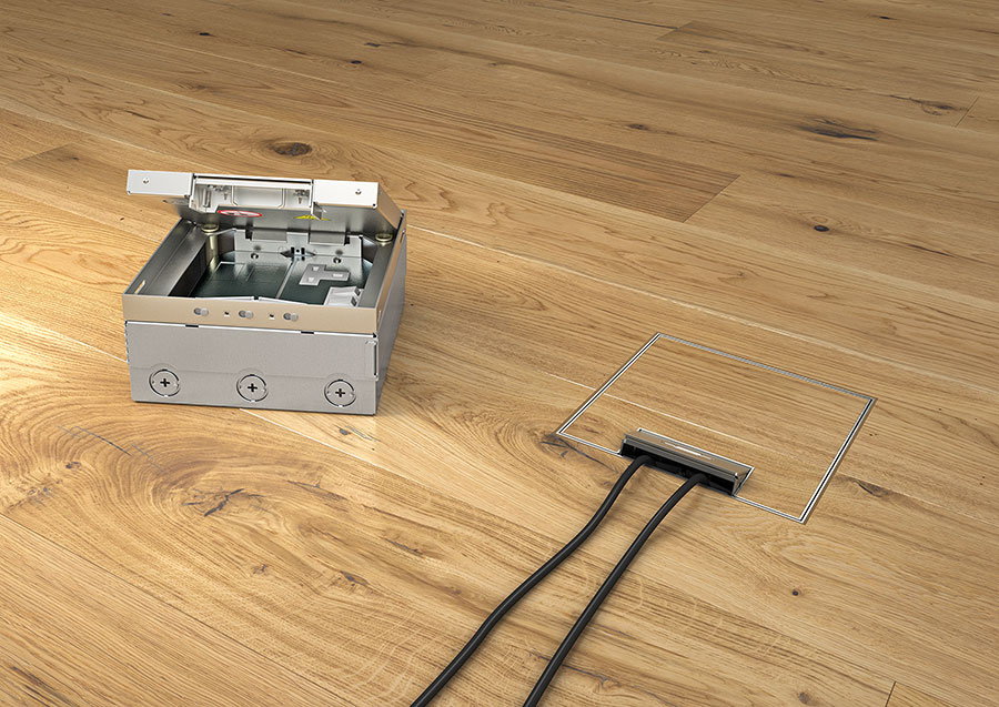

The other about floor sockets like this:
Some of the 2nd sort do indeed have plastic lids.
The recessed style where the plugs are below floor level and significantly safer than flush mounted.

Yes, the second sort must have a metal socket inside I would think?
Different manufacturers, different arrangements. Lower cost versions (not in any way a criticism) tend to accept standard double width accessories so yes commonly white DSSO's, more expensive versions tend to use bespoke metal back boxes and faceplates and no compatibility between makes.
