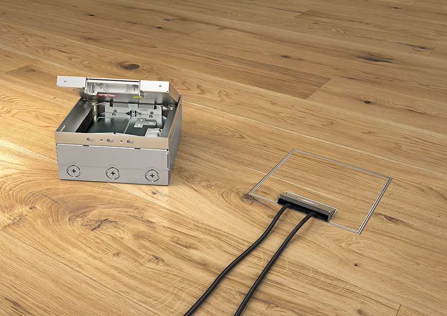

There are two groups of people in this topic.
One group is posting about floor sockets like this:

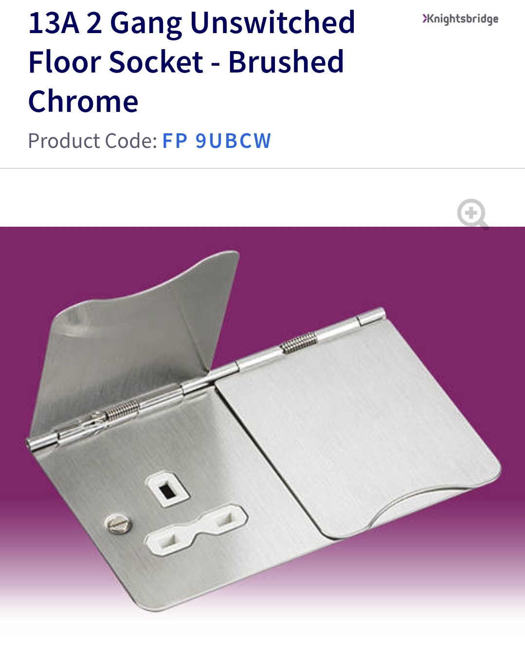

The other about floor sockets like this:
Some of the 2nd sort do indeed have plastic lids.
