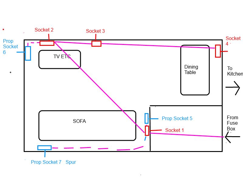

Is this Socket Extension OK?

Don't worry about a diagram, I think I know what you mean. If you don't know which legs socket 1 has, you have two options, use a multimeter to carry out some continuity tests (also know as belling out the cables) will require you to strip down the sockets you think it may feed and testing to see which cable goes where (with power off of course)
Or, as I suspect you aren't going to use these sockets for heavy load items (correct me if I'm wrong) just add a fused spur next to the socket, then your new socket, then chase across, add the second socket. Jobs a good'un for that section.
Keep it simple. Don't worry about keeping it on the ring, so long as you do it properly
Ha sorry, ive done the diagram lol Here is is, our living room with the sockets. Its all plasterboard barratt house style and im literally looking for the easiest way of adding those sockets. 2 of which will be the new USB charging sockets for obvious reasons. Your right, there not heavily used, particularly the sofa ones but it would be so much better if I can add an extra socket (socket 5) while I was doing it. Ive certainly overcomplicated things and im now just thinking about spurring off socket 1 for proposed socket 7 and just having a double socket for socket 1 leaving proposed socket 5 out completely. Anyway, i'll post this so you know what im trying to do lol

This bit sounds promising! So I add a fused spur to socket 1. Then connect that to proposed socket 5 and again to proposed socket 7? I didnt think I could do that so i bet im confused again shock!
Yep, it's a method that gets used all the time. Existing socket -> 13A FCU -> New socket -> New socket
You can add as many sockets as you like this way, but you're limited to only 13A total on the sockets supplied by the FCU, this means there are situations where it works, and others where it won't. I suspect it will be perfectly fine for your living room.
Oh thats great cheers Iggifert I didnt realise I could do that! Thats what i'll do then!. Yeah your right, the new sockets from socket 1 will primarily have just iphone chargers, the electrics for reclining sofa, table light, nothing power hungry so im sure that will be fine!
A massive thanks Iggifer, EFLImpudence and others for your patience and your help. Like I said im not the best at explaining things and im known for doing everything the hardest possible way but i tend to get there in the end lol and if its too much i have no problem getting someone qualified in....Thanks again for taking the time to help me, i'll let you know how I get on! :D
The best thing to do would be to forget the link from socket1 to socket2 (rip it out or partially rip it out and use as the link from socket 1 to socket 7) and link the proposed sockets 6 and 7. That way you have everything on the ring bar the proposed socket 5. That said you give the impression that socket 1 is a single socket, so you could just replace for a double.
