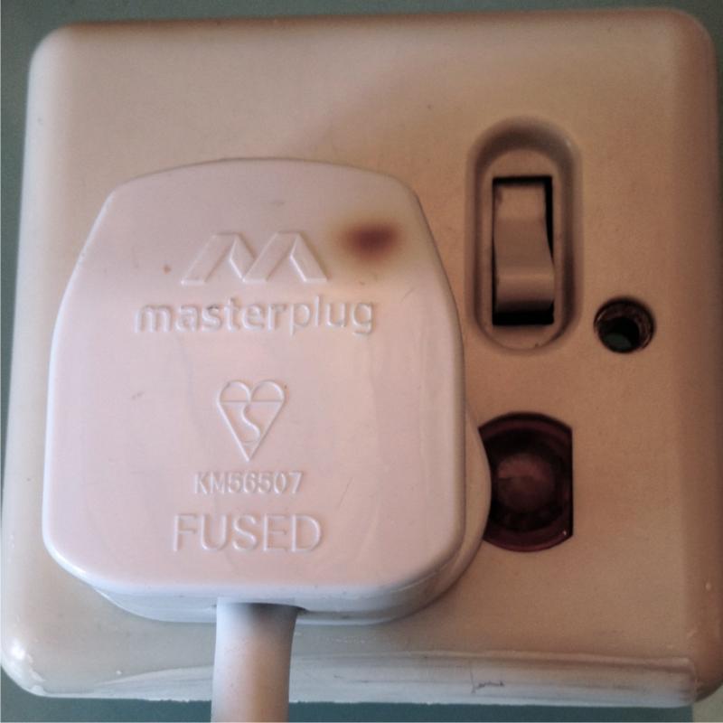

from an extension lead, inside looks much worse
Any idea what sort of load was going through the lead to cause that?
More than 13a for definite. I think there was a 2kw electric blanket, laptop, hair straighteners, phone charger & a desk lamp.
Gonna take a punt and blame it on the electric blanket (who still uses those?!)
