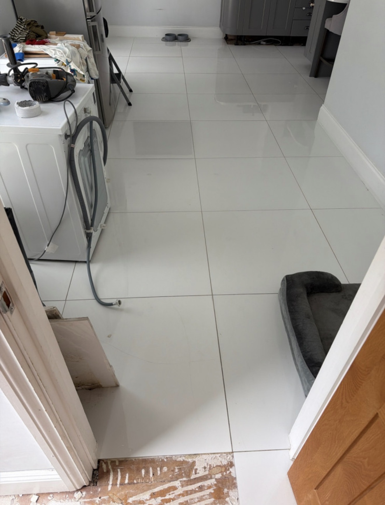

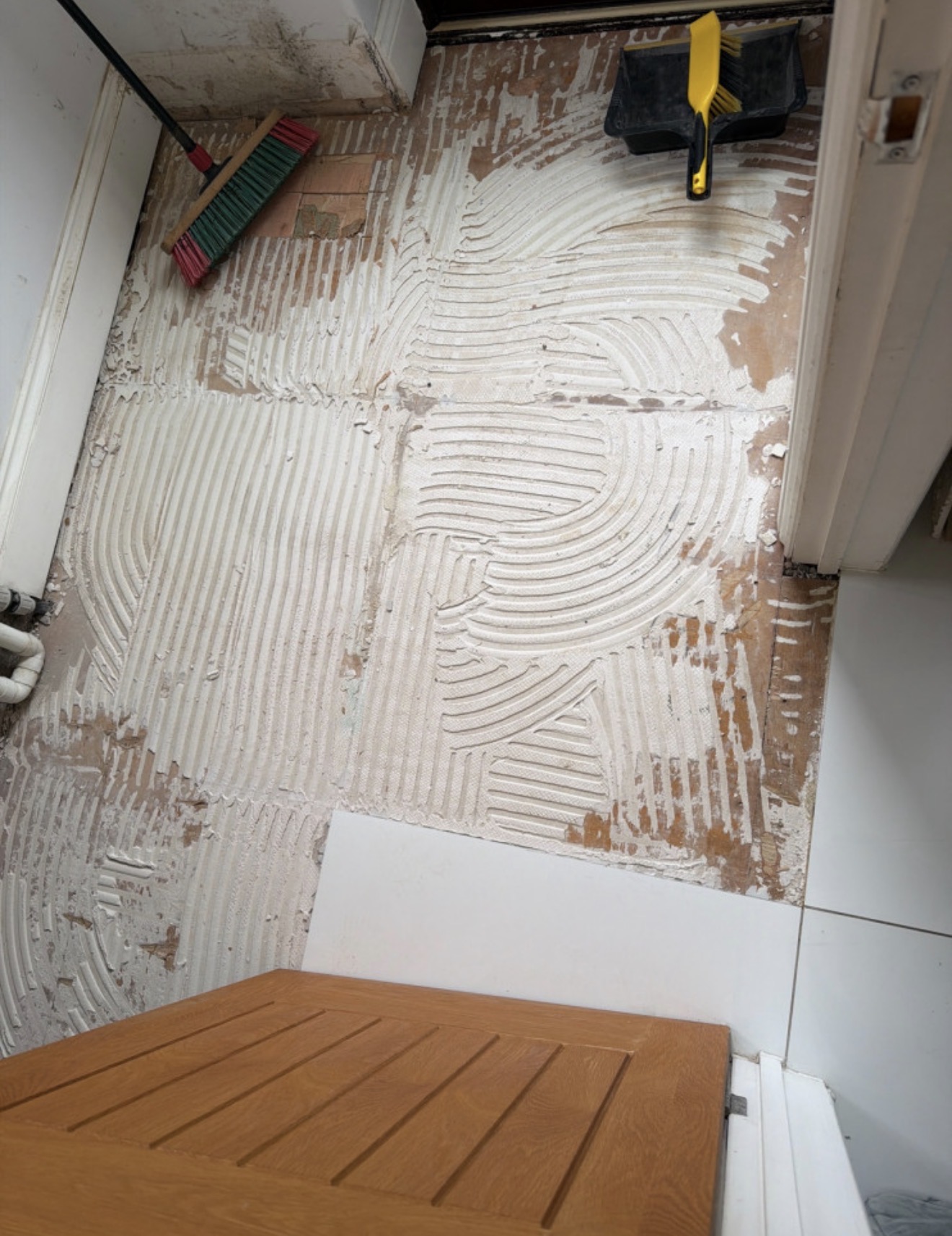

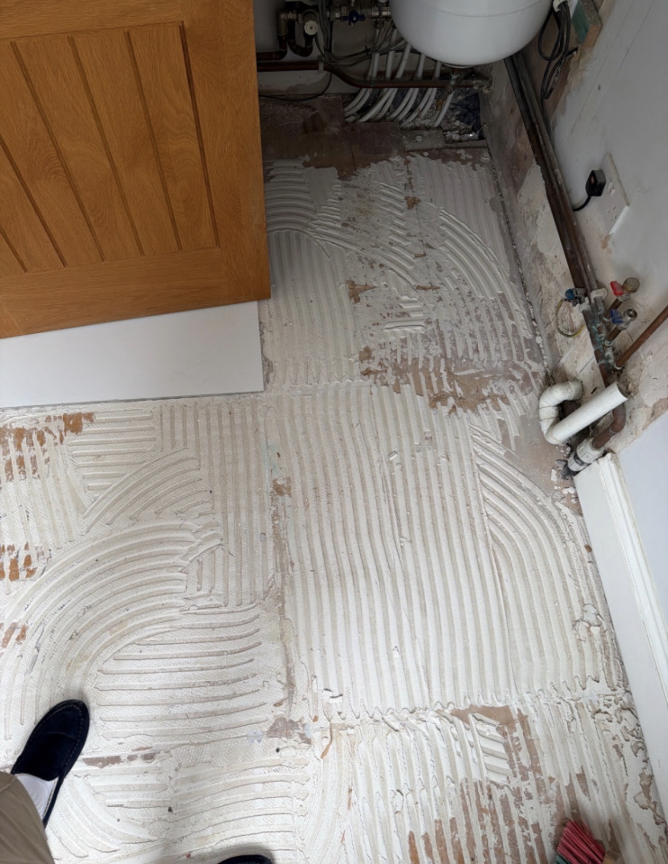

Hi all.
We are currently in the process of trying to remove 800x800 porcelain tiles from our open plan kitchen.
The tile are coming up no problem but it's leaving a lot of adhesive behind.

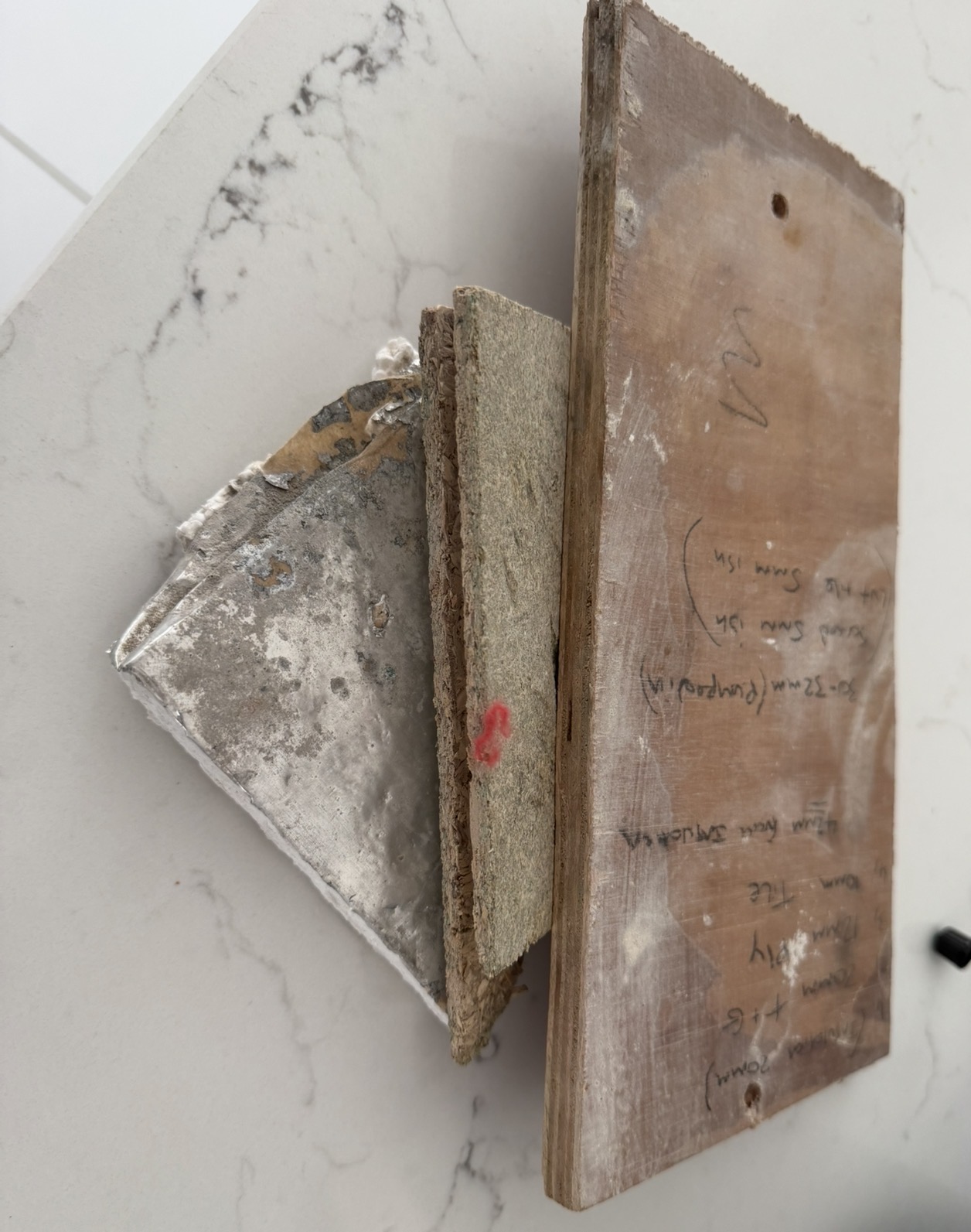

Our plan we to uplift the tiles, which are laid on 20mm EPS150 Wet UFH system, 20mm T&G and 12mm ply.
The adhesive is sticking to the ply, also the ply and OSB are stuck together with screws and possibly adhesive.
Ideally I want to get back to down the insulation and
UFH pipes and pump a screed sub floor back in removing the floating floor system.
What would people opinions be about best approaching this?! We've started in the ultiity and haven't been able to uplift a section of the sub floor yet.

Imo, I would look for existing cuts/joins in the plywood and attempt to lift that, but it’s likely screwed down.
Depends what tools you have, but a cut down jigsaw blade (with a new "point" cut onto it) will allow you to cut the ply into strips that will be easier to get up.
I would say about 20mm (depending on the thickness of the tile adhesive) and you need a firm hand as jigsaws aren't really made for plunge cutting. The chipboard will break up with a hammer if you lift a bit.
