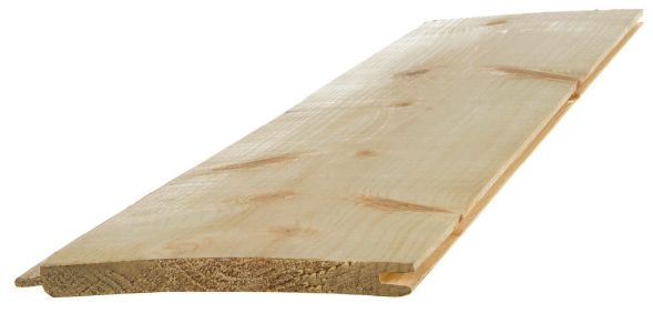

How can those boards be use for flooring when they are tongue and grooved? They will cup, shrink and end up uneven and with gaps all around.
They are not floorboards
If they really were 6" x 1" PAR you'd be fine.
22 x 150 finished would be OK
18 x 144 finished they're having a laugh, as woody said they'll not last long.
Oh crap, I did not notice that! Does anyone know where I can buy appropriate floorboards?
The current floorboards in my old house are 18mm x 154mm
Any real timber merchant. General builders merchants will have stock sizes, a timber yard will be able to thickness/rip boards to your exact specs. Are your existing boards tongue and groove- 18mm PAR would be be very flimsy

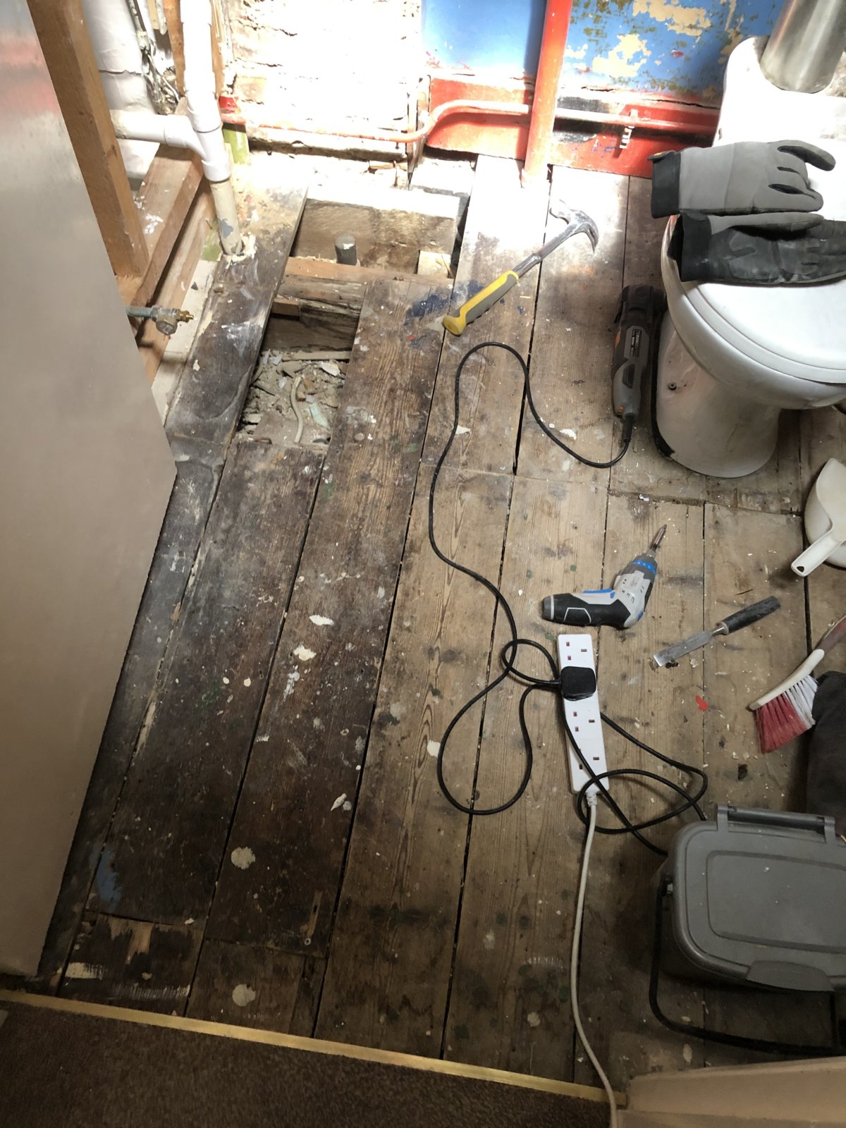

Just to confirm, we are talking about the floorboards which go over joists? I need to replace a missing/damaged section.

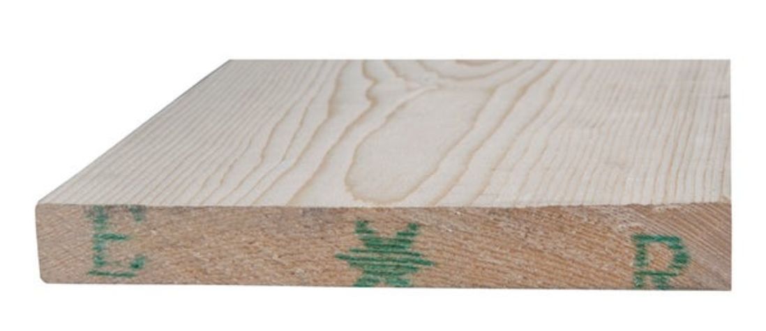

OP Have a look at the end of your existing floorboards and see how tight the grain is (it'll be very fine slow-grown timber). Trot along to Builderdepot & have a look at the end of their boards- if the grain is similar them you're in with a shout, wider grain will not be as stiff
You've got nice tight-centred joists so the 18 won't be as baggy as it would be on a modern floor. If your existing stuff is 18 then your options are limited- either try that stuff from BuilderDepot or get some thicker (22mm finished) from a proper merchant and reduce them where they sit on the joists (you'd need a router for that unless you're very good with a saw and chisels)

Just to confirm, we are talking about the floorboards which go over joists? I need to replace a missing/damaged section.View attachment 192300
Ok, if it's just a repair then use that board. You don't need any treatment.
But bear in mind that the timber used nowadays is fast grown and soft compared to what was used 100 years ago. So whilst it may shrink or try and cup, it won't be too bad I'd just one or two boards.

..... and here is the picture from the OP's BuilderDepot.co.uk website link -- looks to me as though it may have already started to cup. Was that the best piece they could find for the photo?
