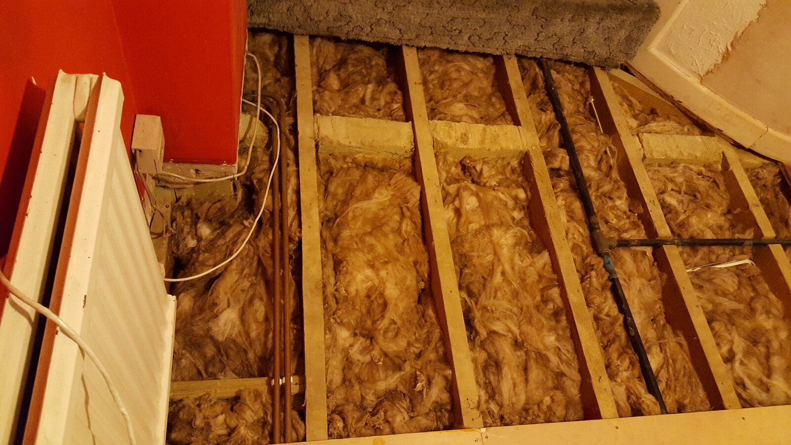

Hey all, DIY noob here!
Second floor flat in a converted house, currently has stripped open floor boards.
Right now there is no insulation between the joists, just empty space. I was going to add rockwool, but before I do wanted to check, should there be space between the rockwool and the floorboards, to allow for airflow? It's a rather mold cursed flat on the outside walls.
Secondly, there are gaps between the floorboards and its drafty, when there is a strong wind outside you can feel it inside. So I was thinking of laying chipboard before putting the flooring back, will this mean there is no airflow thus cause damp issues under yhe flooring?
Thanks for the help
Fix battens to joists to lay insulation on, leaving gap beneath for ventilation (the draught suggests you may have external air bricks, these should not be blocked off). You may need to bead the skirting too.
The process will inevitably split crack or otherwise damage the boards, thermal underlay and laminate flooring is an alternative.

Thanks for the advice. What about the gaps between the floor boards, to stop the wind coming through them. How would you fill them?
You can buy wooden slivers/shims off ebay, but for smaller gaps a mix of sawdust and glue is the traditional way.
if you pack between the joists with mineral wool, it will block the draughts. Pay extra attention to the edges of the room, where the wind blows in through airbricks, gappy brickwork, and joist ends, and comes up under the skirting. you can put plasterboard caps over holes, e.g. light fittings, cables and pipes.
This is a room over an unheated garage, so there was a ceiling below to lay the wool on. In my case there was no need for the dense sound batts but I am working round the other floors as I rip out the horrible cracked and squeaky chipboard. Also fill any gaps you find, preferably with pink firefoam or fire caulk.
Cables can be on top of the insulation, or underneath, so heat can escape, but must not be surrounded.
