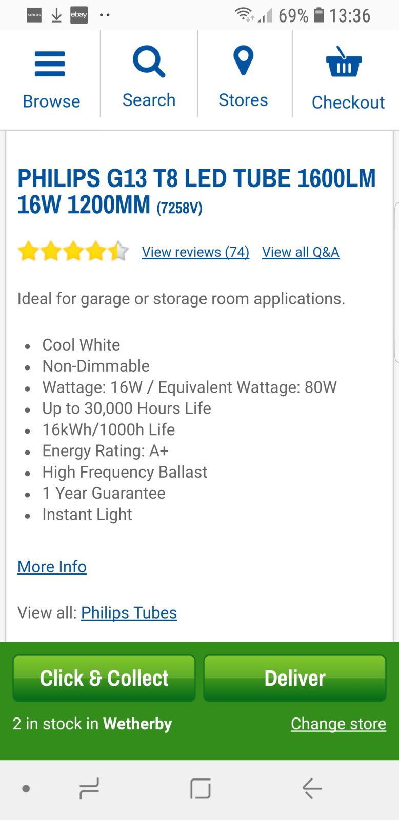

I've just changed our 4ft florescent tube for an LED, straight fit with new "starter".
Night and day different.
Thanks for that @Keithmac . I have an account at Screwfix which is where you got that from. Do they do the starters if I need one ? And what am I looking for in the unit as far as starter and ballast is concerned. Sorry for the ignorance but I'm not an electrician. :rolleyes:
This came as a kit, you fit the LED tube as a direct replacement for the florescent tube and it comes with a starter replacement in the box.
You have to fit the new starter.
Not as cheap as a normal tube but very good light output.
But only any use if you have a traditional ballast and starter. You cannot use this with a starterless system without completely stripping out the existing ballast.
