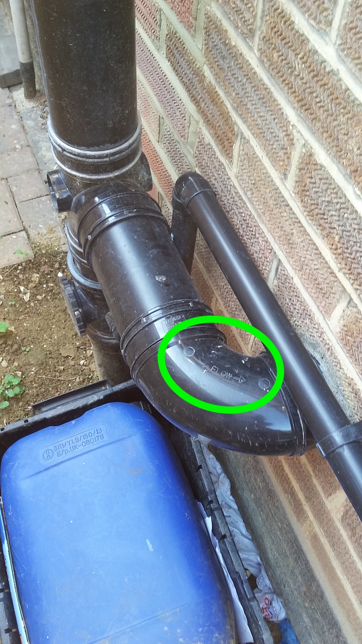

I noticed this weekend that there is the word "Flow" and an arrow on a soil pipe bend, but it appears to be pointing the wrong way. Or am I reading this incorrectly, and it indicates where the flow should come from? Please educate me.
The plumber still has a few snags to sort out before final payment. Does this pipe need to be fitted so that the soil flows in the direction of the arrow? (It does not appear to leak, but there is a small leak where the upstairs bathroom connects to the soil stack in the photo.)
Yes that is technically backwards, but not overly concerning as it's a glued fitting so it should be fine

As long as there is a small fall between the bend and the T it will be reet.
Rub the writing off with some wet and dry sand paper.

Doesn't it indicate the prefered direction which would be from spigot to pipe which almost eliminates the risk of something catching on the end of the spigot ?
But as said in this case probably not important.
