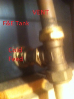

If you use a separate vent
As Madrab said that I don't know what I have; sealed or OV as I thought of this system as OV so I bought a OV boiler (but PRV,NRV and no vent tell a different story). I think it would make sense to stick to OV and do the pipework and installation as per OV standard which is Vent,Feed, pump.
Can an OV boiler be used in a sealed system (by installing a exp vessel)?

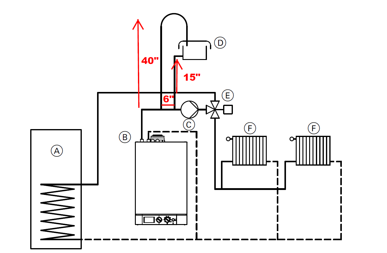

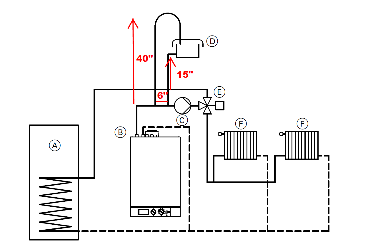

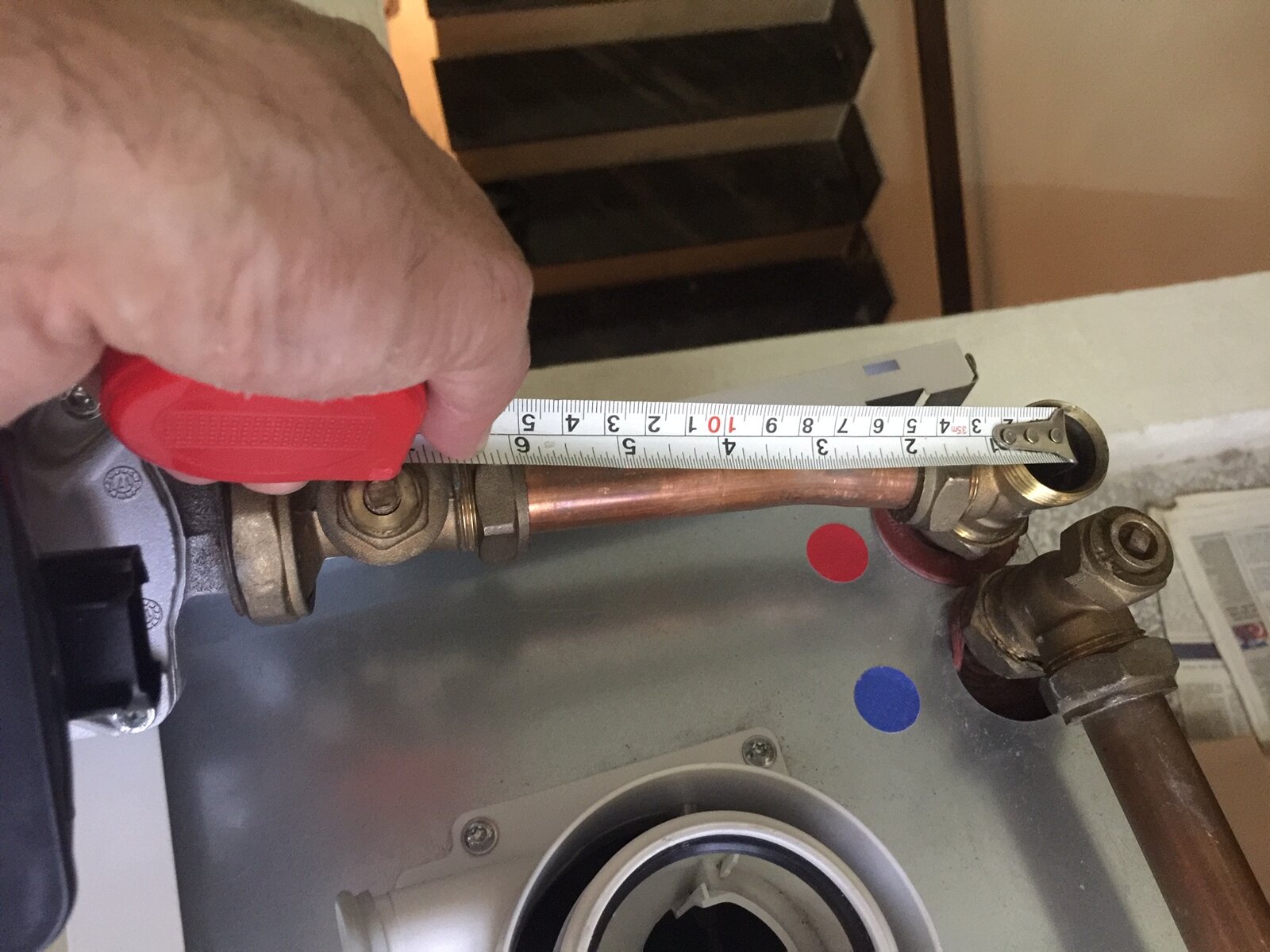

The balcony where boiler will be installed is only 7 feet high so having min vent length of 40" from boiler + 24" boiler height would make me shift boiler just 1.5ft from floor. Are these lengths a must for hydronics and safety. Can these lengths be slightly less than this e.g why feed has a minimum distance of 15" from flow line?
Your sketch looks OK to me. Perhaps Madrab will comment. The top of the vent loop must be minimum 18" above the F/E tank water level, probably is but can't be sure from the dimensions given.
My boiler manual says minimum 18" from the flow pipe to the F/E tank water level (roughly same as your 15" to tank bottom) so I'd stick with that unless your boiler wants something different.

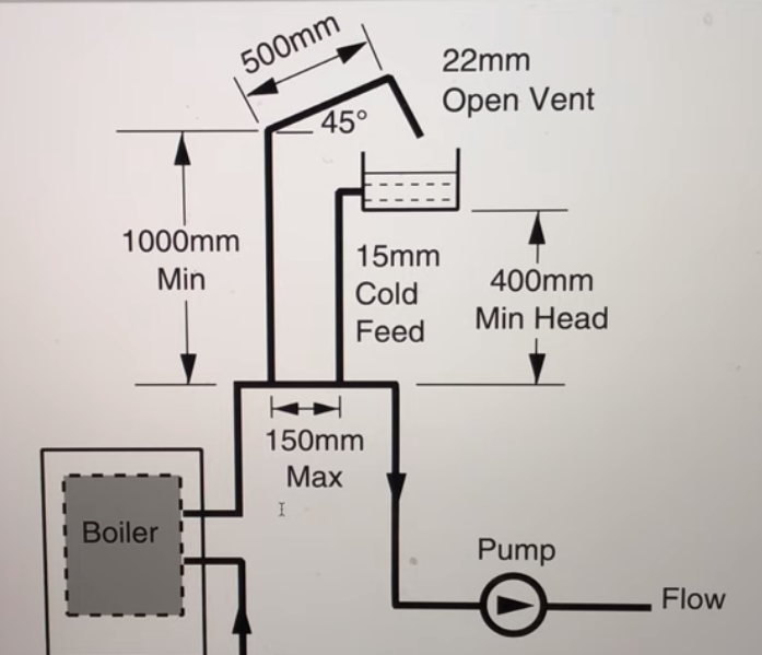

Got the dimensions from net for OV.
Those dimensions don't tie down the important one - 18" minimum from water level to top of loop. Not enough care taken IMO! But if you ensure you meet the 18" you could do it that way. Though I don't see any need to use 45° and 90° bends as shown. An inverted U as in your earlier post would be fine.

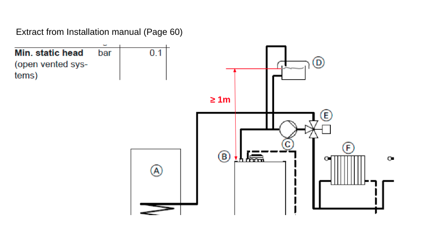

Min height F&E tank to system is to provide min head allowing the system to be fed properly from the cistern, vent min height above the cistern to stop pumping over and allow for expansion. Max distance between feed and vent is to ensure pressure differentials are kept to a min, again to avoid pumping over/air drawn in/reverse circulation back up into the cistern.
Do it this way, remove the "H",no more problems.
Combined F+V , not everyone agrees that it's the safest approach as it can interfere with the safety vent. Also allows expansion back into the cistern when ideally that should be handled by the vent. Needs to be designed in quite specifically IMO. A properly designed OV system shouldn't need a combined F&V IMO.

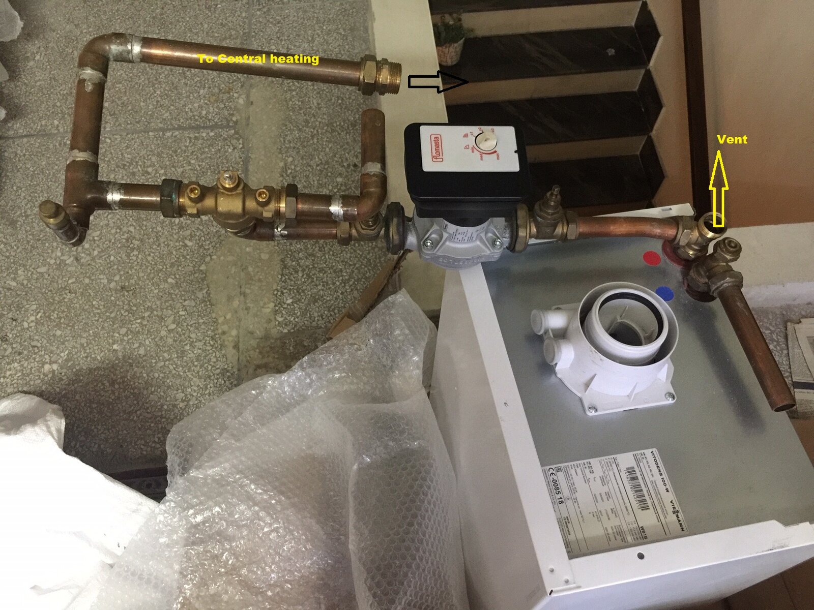

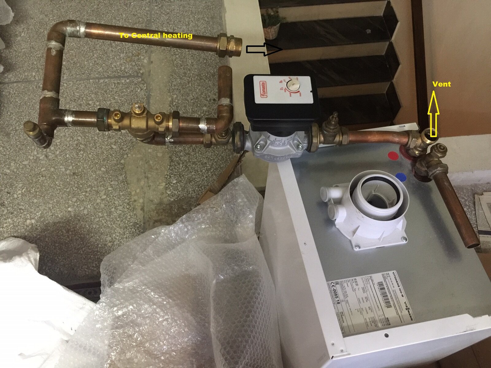

- Will put pump on flow (see pic);
- it will be OV system with separate vent and feed.

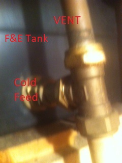

Have I got this right in terms of min 6" or 150mm gap between the pipes?
A pipe from boiler flow will serve as vent as per spec 40" high over F&E cistern.
Last thing I want to ask is what would be the layout of Feed into this pipe?
Max between, not min, keeps pressure differentials to a min.
Feed could be cut into the middle of that pipe just before the pump inlet but I would provide say another 100mm of pipe from the feed to the pump inlet to minimise direct suction/draw.

Sorry, max 150mm.
The pipework and rads are in place and central heating worked with previous boiler fine (with integral pump; it was Grundfos with 5m head).
I have never used an external pump in my system so this will be first experience. My initial estimates suggest that with 30k btu load the system would be requiring 3gpm or 11lit/min (all theoretical). I would appreciate any pointers or reading material if you can refer.
This Flomasta pump is Delta P pump so is more adjustible to varying heating loads?

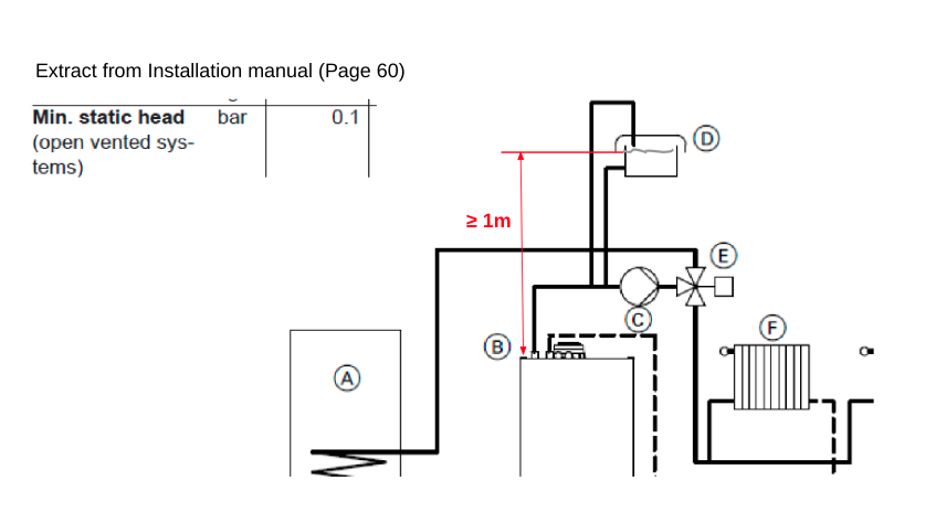

Message from Viessmann technical support about height and static head for feed.
