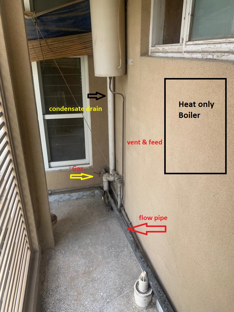

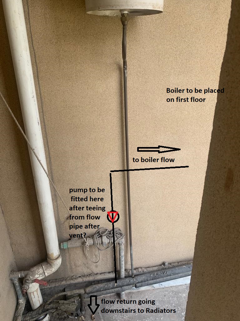

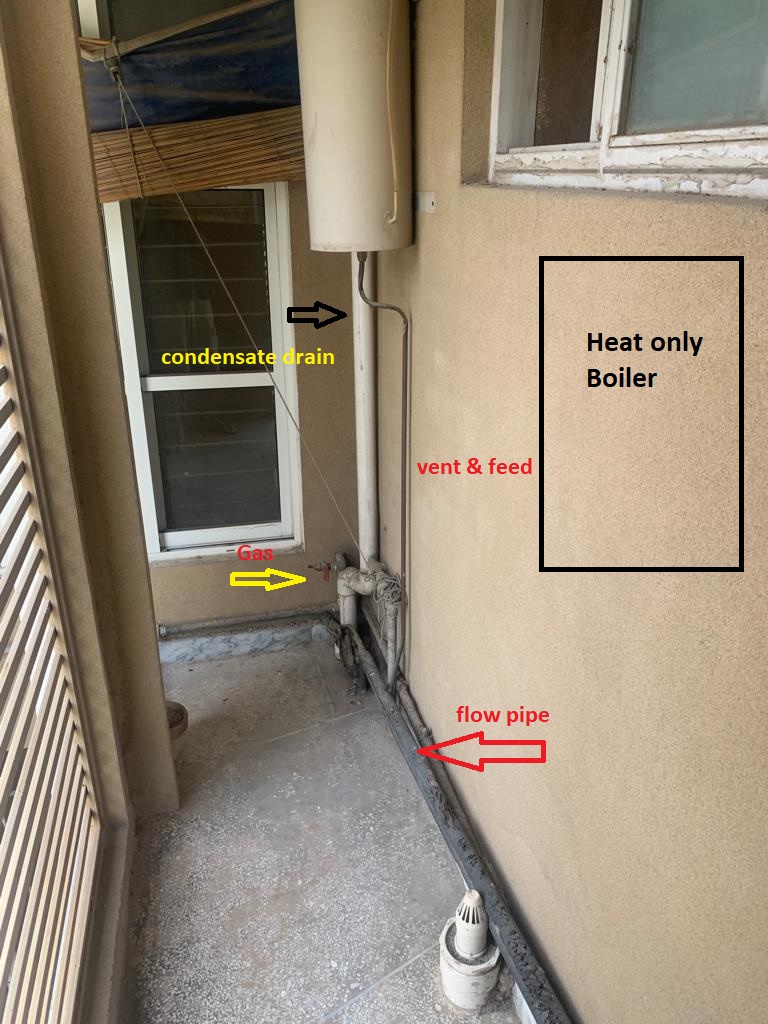

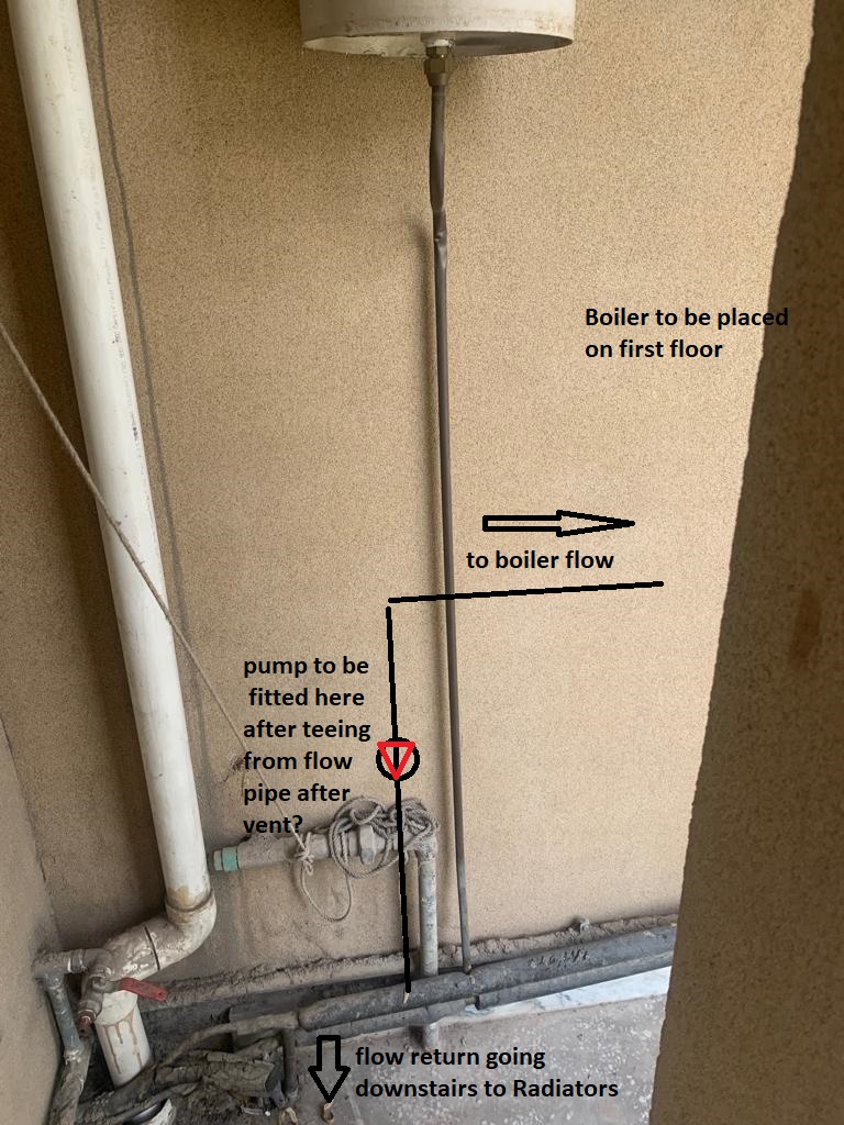

I thought, I'll start a new thread for clarification. Does this look right? If I have understood it clearly, it is a flow loop from boiler to rads?
I have selected this loation for new boiler on first floor. Gas connection, condensate drain, feed pipe (serving as common vent as well).
My previous boiler was on ground floor just below this location and had a pump inside boiler, in 2nd photo you can see pipes going downstairs to rads.
I am slightly careful about where to place the pump and based on VCP principle, would I be alright in terms of pump location (after vent), marked on 2nd photo? I understand that I have to raise the feed tank above the boiler but other than does this look correct for installation. This is not in UK so UK laws don't apply here but will try to learn and follow best practices used in industry for OV system.

It's not about UK laws. it's about the laws of physics. The connection setup you have in pic 1 is the ideal to ensure proper circulation, venting and feed. Any other orientation will alter the system pressure characteristics and could cause problems.
The pump needs to be placed after the feed and vent with the flow away from them to keep the system under positive pressure. The boiler can really be fitted anywhere in the chain, if it's a HO but there are more favourable positions for it, depending on the system layout. The vent also needs to be a certain height above the F&E cistern to avoid pumping over and the cistern needs to be the highest point on the system.
Can I advise that you do a fair bit of extra research if you a looking to plan and fit an open vent CH system, lots of OV design stuff available online. It is level 3 stuff for an experience professional but not so much for a novice DIY'er. The basic design principles and the standards that must be applied, needs to be know and understood to ensure the systems works properly. Of course, it isn't beyond a competent DIYer but getting tips on a DIY forum wouldn't be the recommended way to do it IMO

That's OK, but don't forget up and under for the cold feed. Also the vent and feed should be maximum 150mm apart, as you've possibly seen if you've been reading up on it.

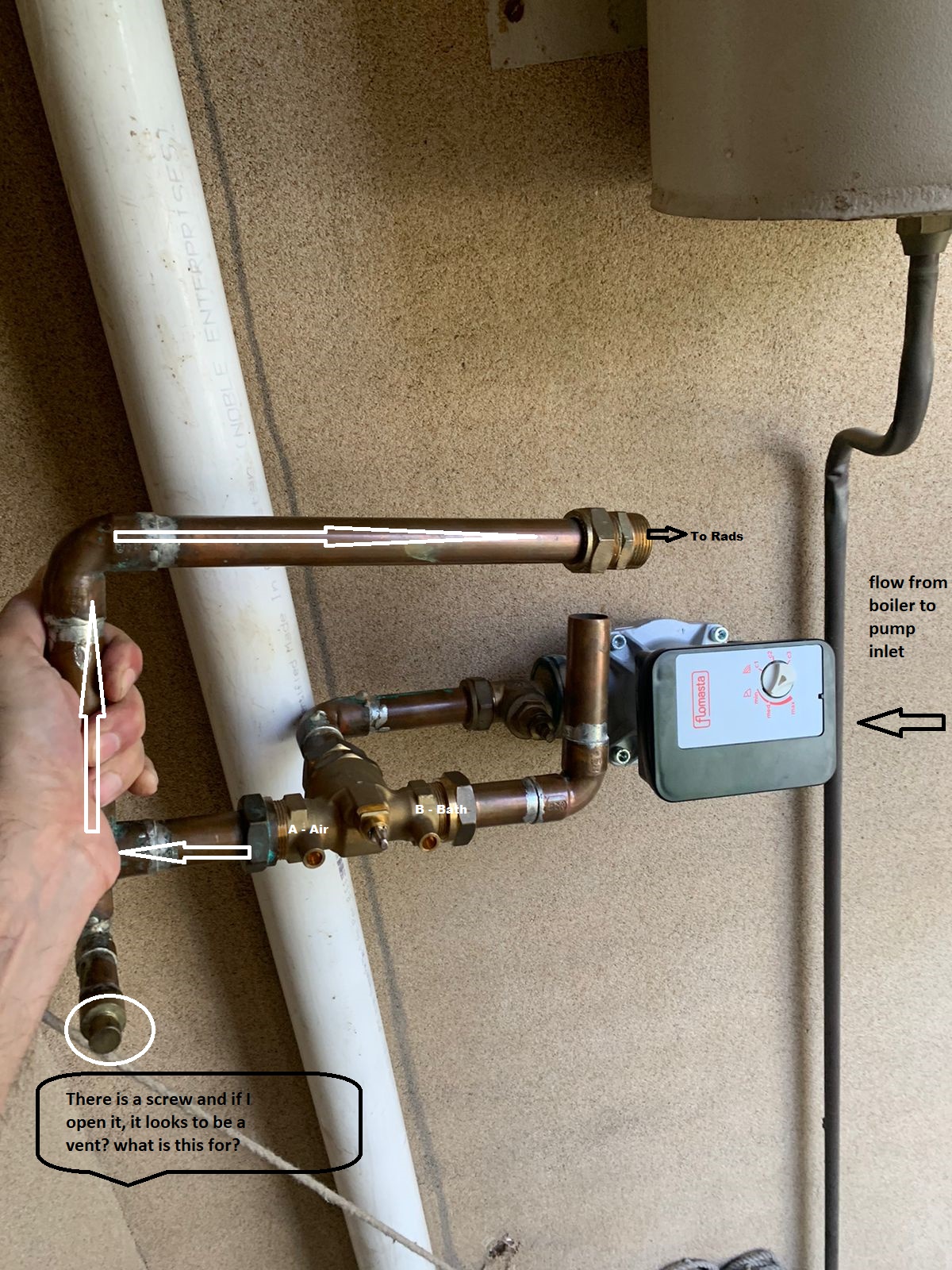

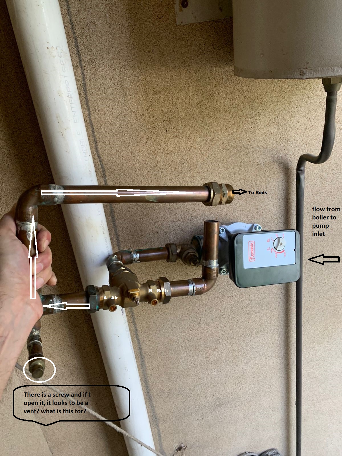

Thanks. I have got a pre plumbed pump and motorized valve that came with the boiler. I have marked the picture with arrows for clarity. What this small screw with a vent for (bottom left on pic) ?
Secondly, Do I have the connections right from boiler and into the flow pipe? Thanks
Looks like a vent but it won't do much venting in that position, but it probably isn't essential. Is it possible to rotate the pipe so it's upwards, or would the vent screw then hit the wall?
Yes, assuming it's pumping from right to left, which it should be if it's a pre-plumbed arrangement

It hasn't been fixed yet, I was just holding it this way to ascertain correct orientation.
you mean the whole thing so pump is facing upward direction?
That's a 3 port valve, so you would be setting the system up as a Y plan with Ch and a Hot water cylinder. It will need a motorised head that would be controlled through what called an interlock, so a couple of thermostats and a programmer. Not the best TBH so be prepared to swap out the 3 port motorised valves during it's life. It would be better as an S plan with 2x2 port valves. Feed and vent would be piped in before the pump even then though, is setting it up as a sealed system not possible?
As the 3 port valve sits then it's AB = the inlet from the pump. A = the outlet to the Rads, B = the outlet to the Hot Water cylinder, forget about the air vent that's on it, it's kinda pointless where it is, either cut it off and cap or just leave it locked off and never touch it.
No, I meant just the bits after the 3-port valve. Looking at the top of the T, towards the 3-port, rotate it 180°
The motorised valve, filter, pump came with the boiler (Viessmann 100-w heat only wb1b). I intend to install it for central heating system only as I have direct source for water heating. If this is installed correctly I intend to get an indirect cylinder (with coil and immersion element) and install it as you say via Y or S plan system in future. If I leave the motorized valve as it is and leave it at central heating it should work fine for central heating?
I am skeptical going for a sealed system (based on my limited knowledge) but I keep reading the debate about sealed vs OV system due to maintenance involved. Are there any benefits in running it as a sealed system, I need to install an expansion vessel for conversion, Correct?
Yes. Obviously you need to blank off the pipe going to the future HW cylinder.
