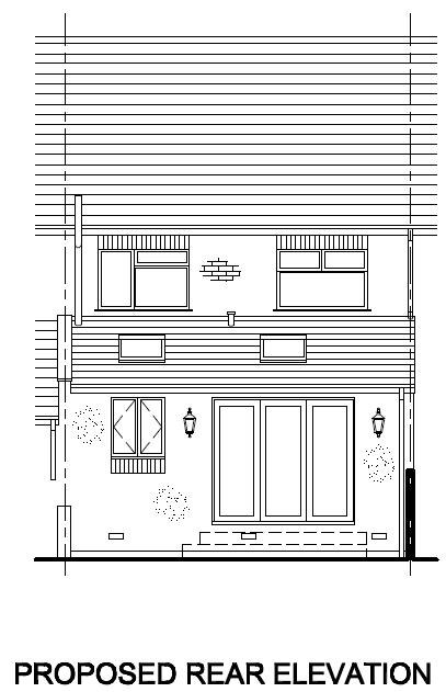

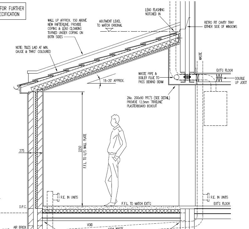

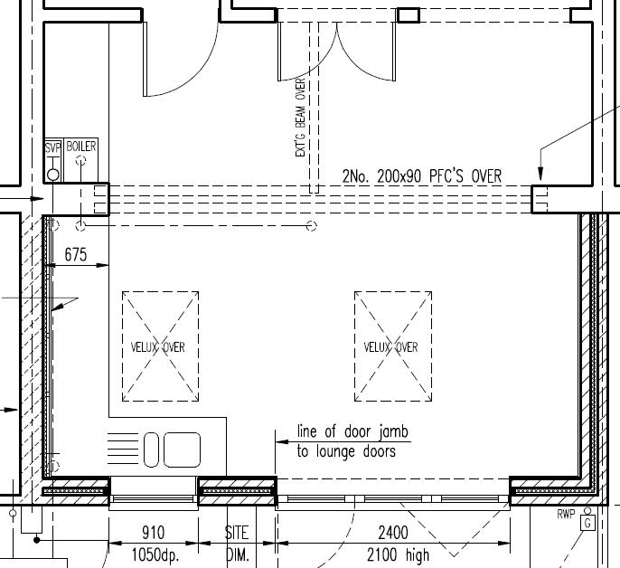

I have a Vaillant ecoTEC plus 837 boiler, and due to an extension build this will need to be relocated. Ideally I would like the boiler positioned as shown in the plans below. (I realise it would be much simpler to have it placed on the external wall near the sink, but wish to avoid this if possible for various reasons.) As I'm now at the roofing stage, if I need to put any flue flashing tiles in I would like to do that now rather than retrofit them later.

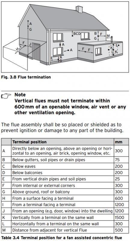

Tony, Thanks for the input, I am well aware that the boiler needs to be moved by a gas safe engineer, but I am going to be roofing the extension this weekend - weather permitting, and I want to put the flue slate in. If I cant have the boiler where it is shown in the plans, then I don't want to have installed a hole in the fabric of my (sarked) roof for no reason. And having looked at the boiler installation manual, I am struggling to see how the flue could be arranged as shown on the plans, the ceiling is vaulted, so 600 / 500 for a vertical flue penetration does not seem achievable.

Looking at your plans, you won't meet the clearance rules on several fronts the way you want to have it.

It was only now the builders have finished the blockwork, and I am due to put the roof on, that I was looking at the details again for the roof. Whilst planning the soffit depth and the placement of the velux's so they correspond with full tiles etc, I started trying to work out exactly where the flue would exit the roof, for the flue flashing, only to realise that It seems unlikely to be doable, and hence my questions here.
So, can anyone think of a way the boiler can be located where indicated? I don't really care how or where the flue gets routed, as long as it comply's and does not look ridiculous - ie supported in the void of the vaulted ceiling.
I was thinking that if you could fit a plume management kit to the vertical flue, and if that can be attached to the end of a horizontal flue, it would be possible to come out of the roof vertically where indicated, and then divert the plume up over the eves of the house.

if there was a suggestion that would make you proposed boiler location feasible, someone would have suggested it already. The boiler needs moving.
