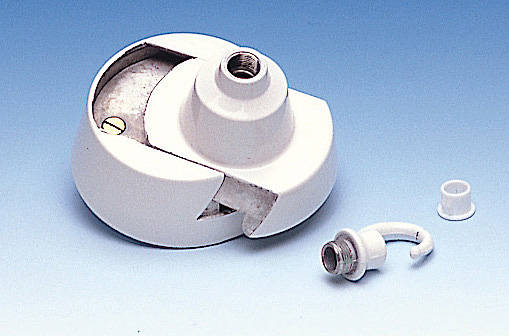

As a ceiling rose and pendent, the plug in units, View attachment 392799 do allow you to work on it on the ground safely, but although others now made, the one shown no longer available

True, those Maestro ones (of which I have many in-service ion my house) appear to be no longer available - but, as you also say, there are (functional) equivalents which are currently available (e.g. the Klik one)As a ceiling rose and pendent, the plug in units, View attachment 392799 do allow you to work on it on the ground safely, but although others now made, the one shown no longer available,
