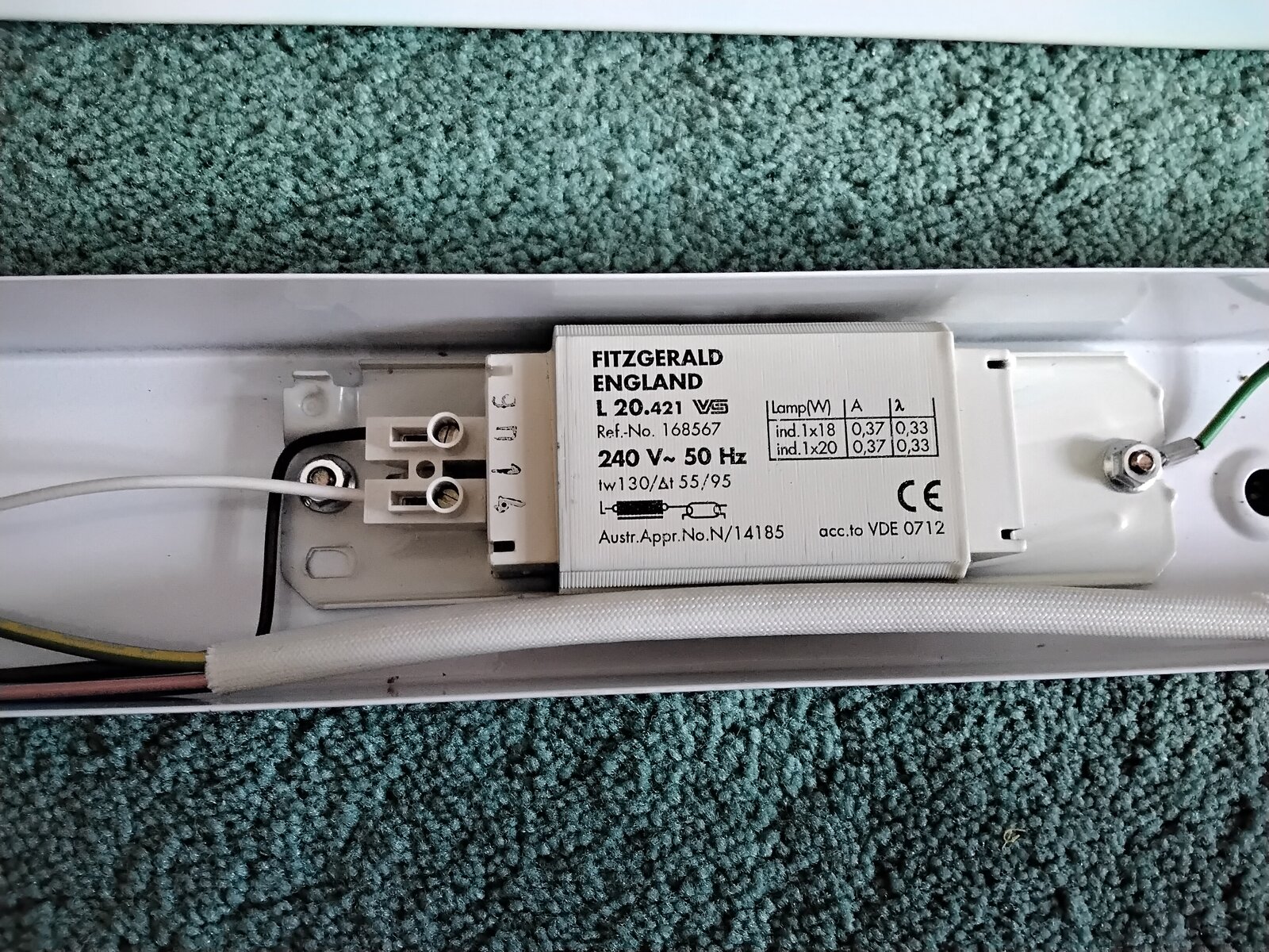

Hi Need help to identify where I can buy this Fitzgerald ballast for fluorescent light Google can only identify used ones
And in retirement not keen to process the alternative spaghetti wiring I do appreciate it is obsolete perhaps different make?
But direct replacement may help me also don't want to go led change thanking in advance I am sure most experienced & knowledgeable
Will have input
Ih
New - nowhere. Fluorescent lighting is obsolete.
Tubes are no longer made, neither are the starters, ballasts, fittings or anything else.
Some places might have some old stock of various parts left but those won't be around for long.
No surprises there.
A used one will work.
What makes you think the one you have is defective?

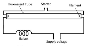

I have replaced starter and new tube no joy hence I conclude ballast it only flickering

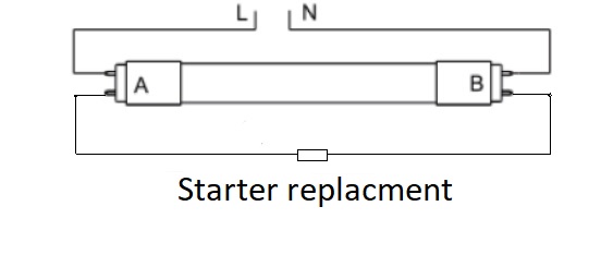

Yes, I also did a Google for "20 watt fluorescent ballast" and result
but an LED tube which allows you to get rid of the ballast is cheaper. So from this LED before converter.pngto this LED tube wiring.jpgeasy enough to rewire.

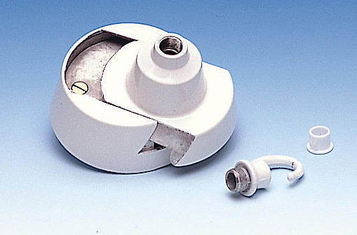

I personally like the idea of plug or screw in lamps, so when they fail easy to replace. So I would go for LED tubes, but likely the integral units do give more light per watt.
As a ceiling rose and pendent, the plug in units, Ceiling rose.jpg do allow you to work on it on the ground safely, but although others now made, the one shown no longer available, and I wonder for how long will we be able to buy LED tubes to fit fluorescent fittings?
  • Thanks
Reactions: ih
