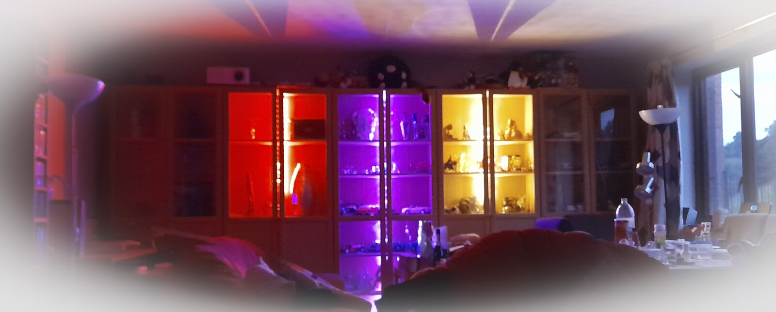

It seems the LED is a big con? OK I like the LED over the CFL which were never really much good, and with built in "Smart" features they can do many things the proceeding lighting units could not do, I have display cabinet lights 20220704_220141_1.jpg which can look good, and also supplement the rooms lighting, changed a bit since picture now cover all 5 units, and at full output around 60 watt, although in the main turned down to minimum. But the point is I could not have done that with tungsten or fluorescent, it doubles as both wall lights and display lights.
But it means the whole way of lighting the home has changed, it is not as simple as unplug one type of lamp and replace with another type, the LED is directional, and so how it is used depends on the direction the light comes out of the unit.

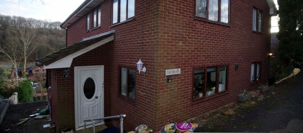

I have three outside lights at the front of my house, Lights top of house.jpg they are all the same size wattage wise, this one is integral LED DSC_7387_1.jpg and the LED's are in the top, shining down through the defuse glass and works very well, but this one DSC_7387.jpg clearly a lot older has an LED bulb in it, which shines up into the lamp, and it rather poor, the last one DSC_7388.jpg has an old compact fluorescent lamp in it, not as good as the integral lamp, but better than the LED bulb, as the light is going out in around the right direction. This shows the basic problem, when using fittings not designed for the LED, since the lights are all used together the poor ones don't matter that much.
But in the main it is better to swap the whole lamp rather than try using LED tubes and bulbs in lamps designed for CFL, tungsten, or gas.
