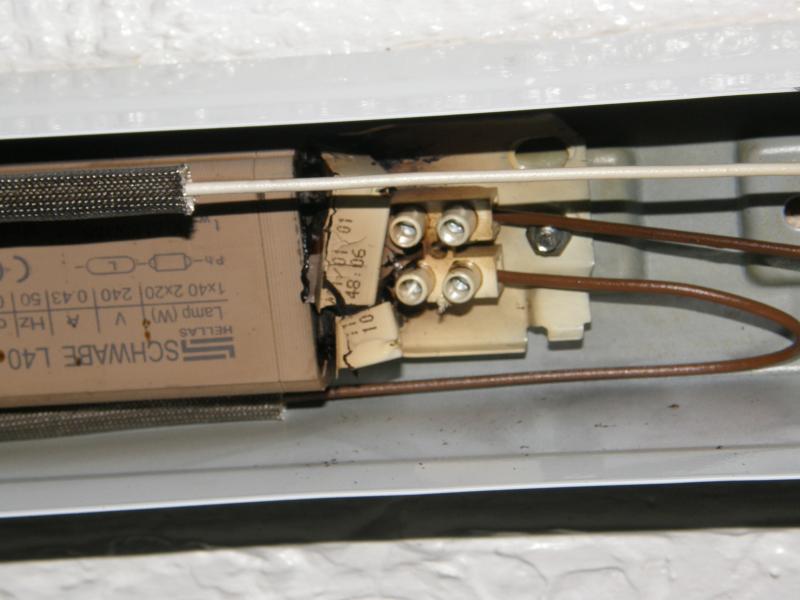

Can someone please give me some guidance regarding the replacement of Fluorescent light part.
My kitchen light has just blown and I need to replace it ASAP.
It has been flickering for the past couple of days at start up, but I didn't think that unusual for a fluey.
When I took the cover off (after removing the fuse at con. unit) I saw where it had blown.
Here's a pic of it.
Is it economical to replace the damaged part, or does it signify that it's knackered[/img]

Looks like it has had a good innings but I think it probably requires replacement.
EDIT: These fittings from TLC are much cheaper. Not sure how aestheically pleasing they would be in your kitchen though...

Does anyone know where I can buy a replacement fused terminal block for a fluorescent fitting?
Should really start a new thread, but somewhere like RS.
However, try ringing the manufacturer of the fitting you have and ask them to post you one.
