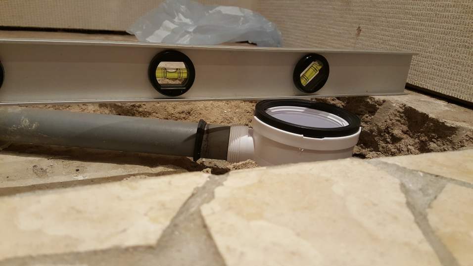

The original tray was fitted flush to the floor (in 1994) – as you can see, the mortar has been chased out to do this. What would you do now to replace it – go down the same road, or have a raised tray, to allow future access if necessary?
My builder cousin (who’s in England, so can’t do this for me) says he’d have a raised tray every time, but would build a wooden frame rather than use those little riser kits. What do you think?
If I stick with a flush tray, presumably there’s some kind of 2-part drain which lets you install the bottom bit, then just slide the top section, sealed to the tray, down into it? Otherwise can’t see how you’d fit it, when there’s no access underneath…

From your photo its difficult to see how high the 40mm pipe is in relation to the floor level but it looks workable,
Most traps can be part fitted from above,just need to position the trap body on the 40mm pipe directly under and just touching the shower tray outlet aperture.
You could use different 40mm solvent weld fittings to alter the angle and raise the pipe if necessary also knock some more of the concrete floor out,when the pipe & shower trap body is in the correct position.Fill in some of the bashed out concrete,make a shutter to keep the concrete away from the drain pipe.
There’s about ¼” or ½” underneath I think. That pipe can swivel from side to side – does that mean it’s a push fit into the bit in the floor? Sorry, I’m pretty handy, but REALLY ignorant when it comes to plumbing…
I was thinking maybe something like that. If I DO use the risers, I'll have loads of room for the trap... the tray manufacturer says attach the trap to the tray, lower it down and screw it together etc – easy to say, but the angle of the adapter thingy they’ve supplied with the trap is completely wrong for that grey waste pipe – would you just make a bend up with solvent weld fittings? Can you buy sort of assorted bags of different shapes of these, or do I need to figure it all out in advance?
I have a McAlpine trap with the little tool, yes – it was recommended. I’ll watch that video now – but my problem I think will be in lining the tray waste hole up with that grey pipe, and getting a good seal somehow.
when you get a chance,put the tray in position and draw a circle through the waste aperture,take tray out and photo the floor.Post the photo here.Helps to work out what fittings will be needed.

Right. Don’t know if these pictures help at all, and I’ll have to do some more careful measuring in the morning I think, but for now… the place where the new trap needs to be seems to be the same as where the old one was, as far as I can tell – I’m guessing maybe all showers with corner drains have them in the same position…?
If that’s true, and I can join them up OK, with welded joints between the pipework so that I can be fairly sure it will NEVER leak, then it’s just a question of making sure that pipe is the exact right length to position the new trap in precisely the right place – then I could lay the new tray flush like the old one, and forget all about risers, front panels etc etc.
The other thing is though, if I get the existing grey waste pipe perfectly horizontal, I don’t think the new trap will be quite high enough – probably only a small gap, but then if I raise it further to mate with the top bit, it’d be at a slight angle, wouldn't it, which might stop it sealing… and if the tray was flush, I’d never know. THAT’S the sort of thing that keeps me awake at night!
