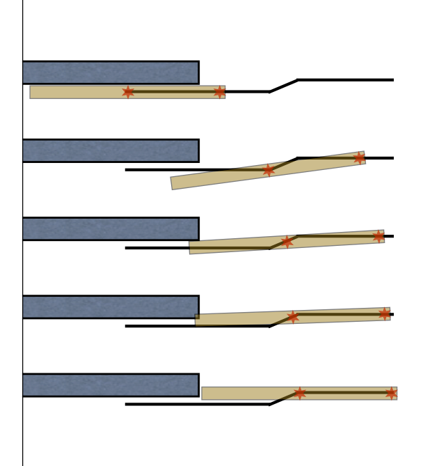

The solution is simple: give a slight bend to the track so that the door slides flush into the hole of the doorway in the last few centimetres. But I can't seem to find a supplier for bendable sliding door tracks.
Does anybody have experience with bending a straight door track a little to achieve this or similar effect?

My design utilises a single track but the downside is that one of the wheels is fixed in the centre of the door instead of the end which may put more strain on it.

Here is an illustration (needs some adjustment but the idea is there):

as i pointed out at a 45% angle the door has no option to move the same amount as it goes sideways as indeed the overlap on your drawing shows
any way i am 100% certain in what i have said
please come back if it works and i will appologize for being wrong
ohh and by the way i do realize a long overhang will effect the amount off throw causing the back to move around twice as much as the forward movement but it still has to move forward once cleared the frame to move sideways
having the back unsupported will stop the door being reliable
any way i step out off this one as i have added all i can :D

I don't worry too much about the small overlap, I am sure there is a door profile that can arrange that. But the unsupported back is definitively a concern.
