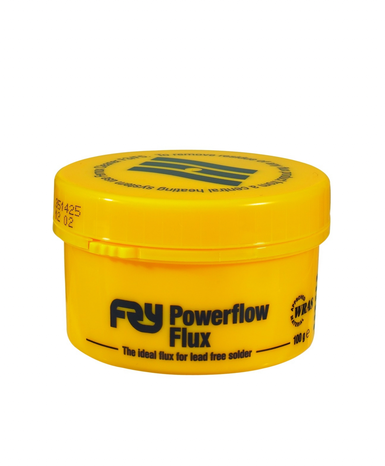

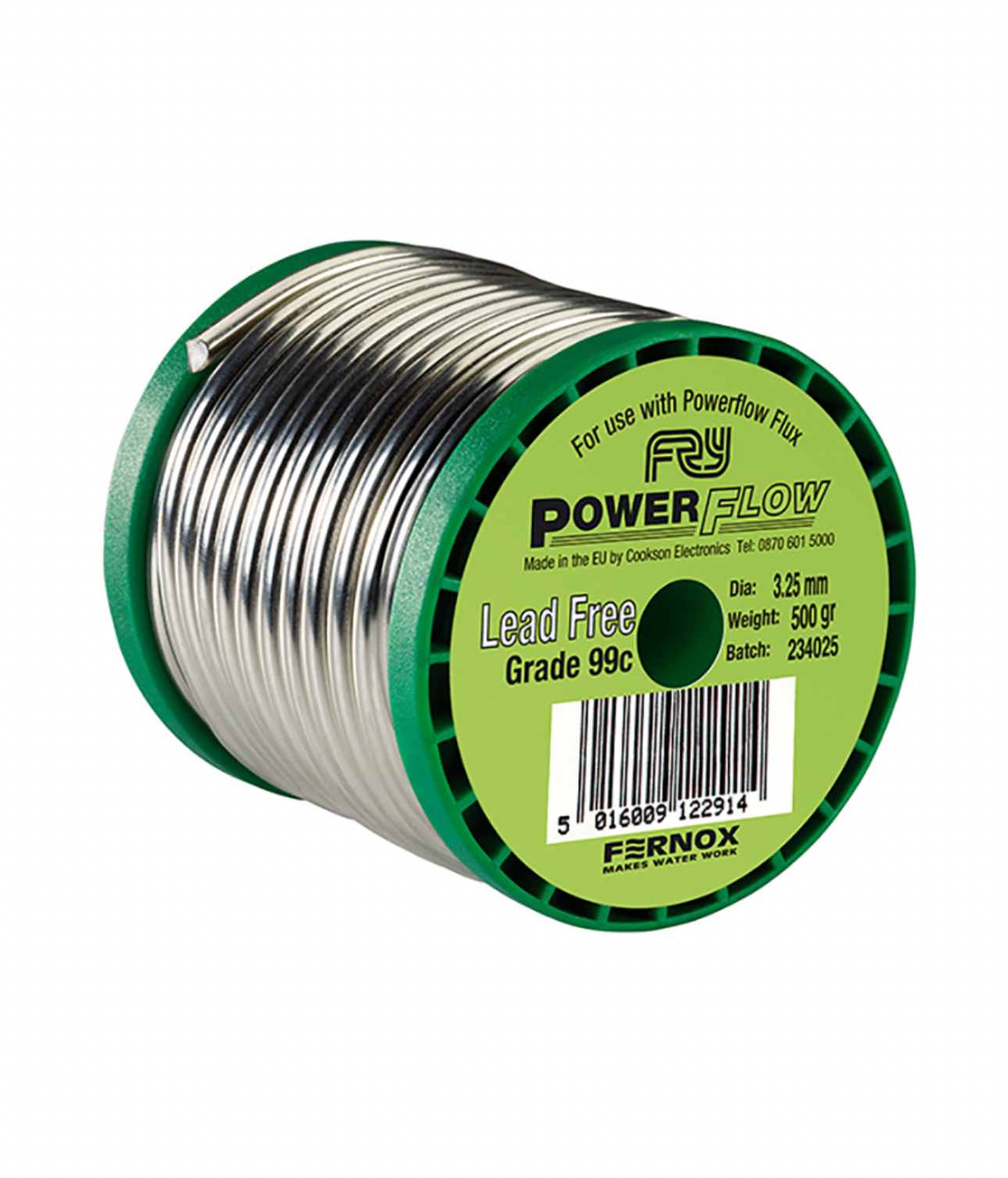

New to flux, do you have to use same brand of solder wire with same brand of flux?
For example I’m looking at Fernox lead free 500g solder wire / Powerflow fry - says use with same branded Fernox Fry Powerflow flux.
Why I ask the question, as was thinking of La Co paste instead! (Cheaper and comes with brush)
Photos attached of fernox solder wire & flux.

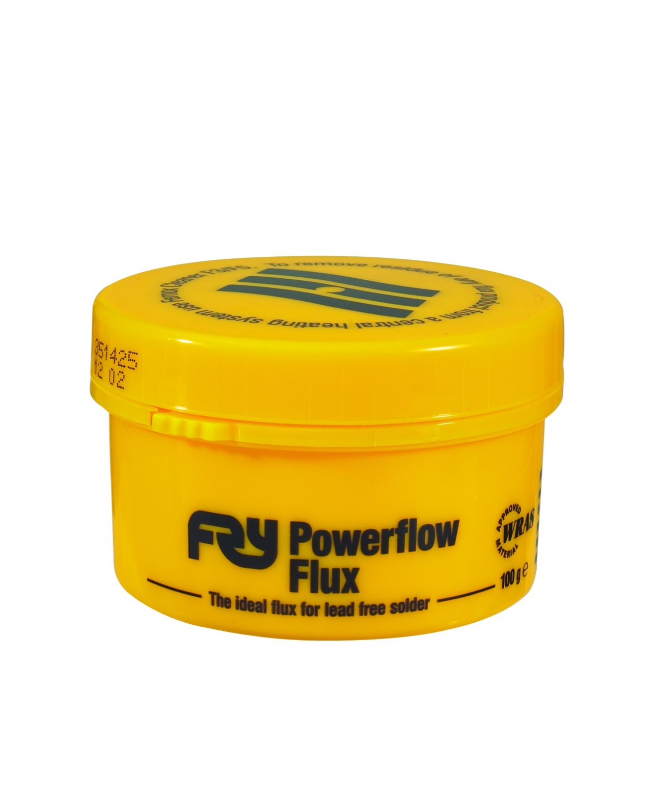

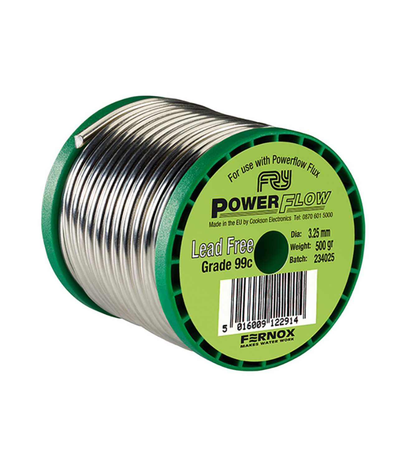

As above mix and match match
My own preference is laco and lead/tin solder (exept for potable water)
Having said that I long since swapped to press fit only thing I regularly solder is air vent cap ends.
