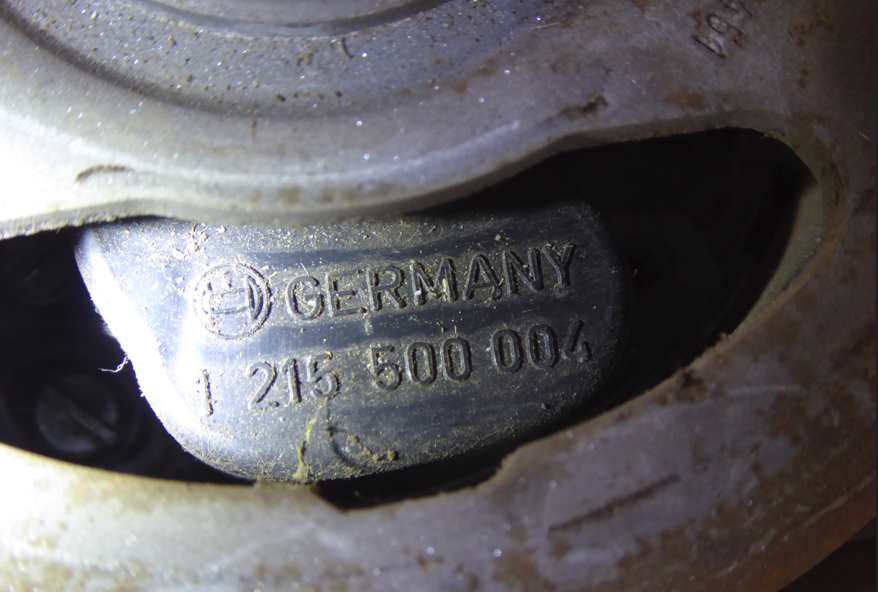

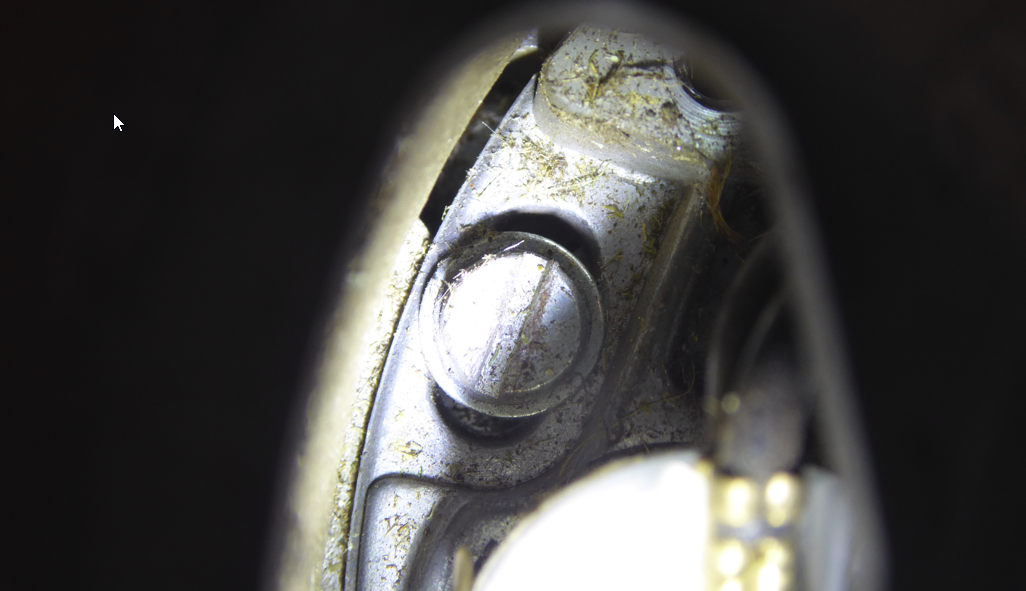

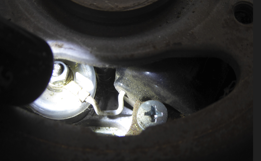

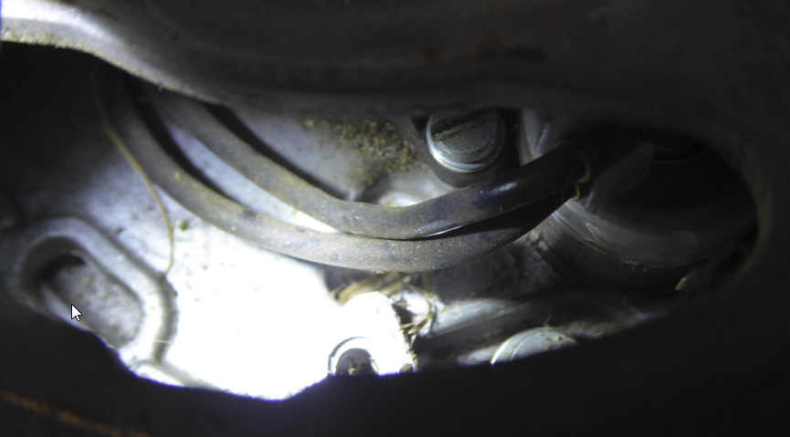

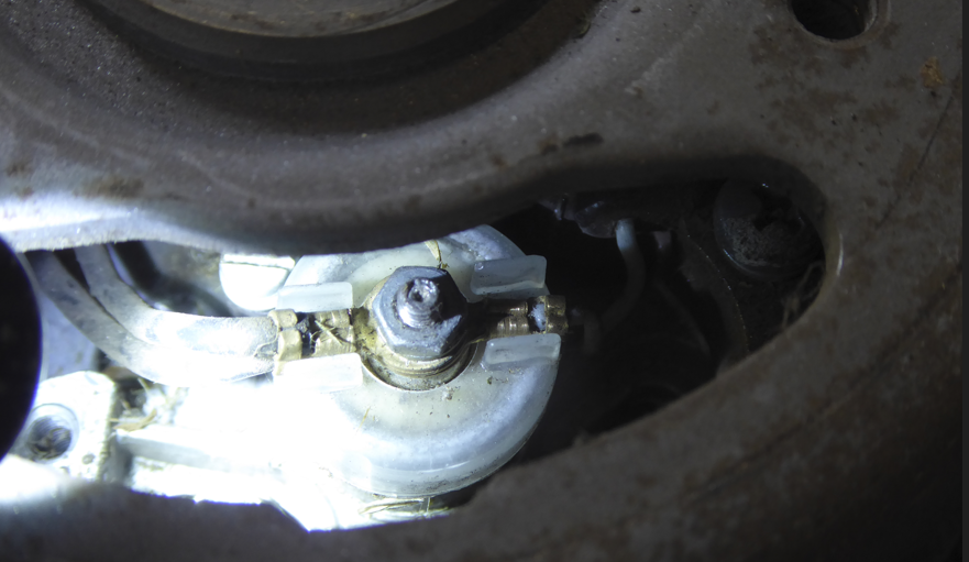

Now pictures through the openings, in some cases shining a torch to try and see the innards. I can't see anything that looks like any sort contact breakers I've seen before. The device with three wires attached might be a condenser with one of the three cables being for the cut off switch.

I think you are going to have to persevere getting that flywheel off somehow - on your second from last pic there could be some sort of adjustment for a contact breaker just visible?
You can never replace points without the flywheel off - but you can always adjust them with the flywheel on.
John :)

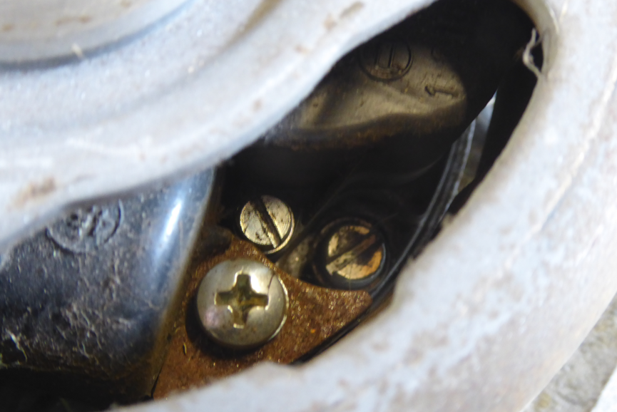

Cheers. I see what you mean about that screw in a slot. There's another on at 180 degrees so it looks like something to adjust the whole back plate ..
