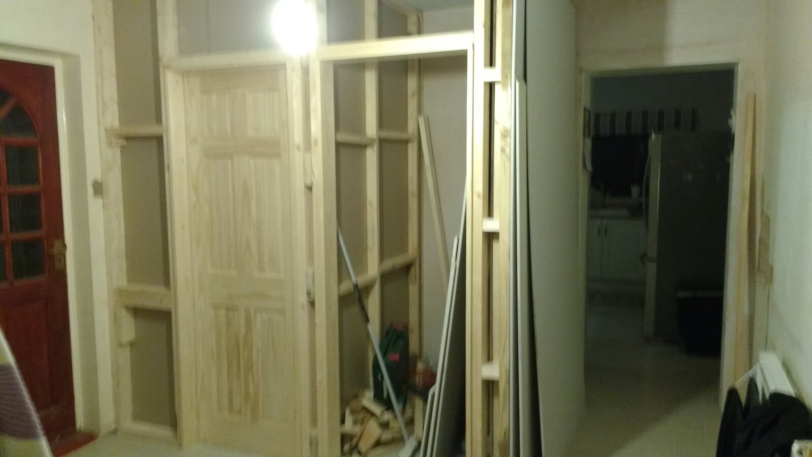

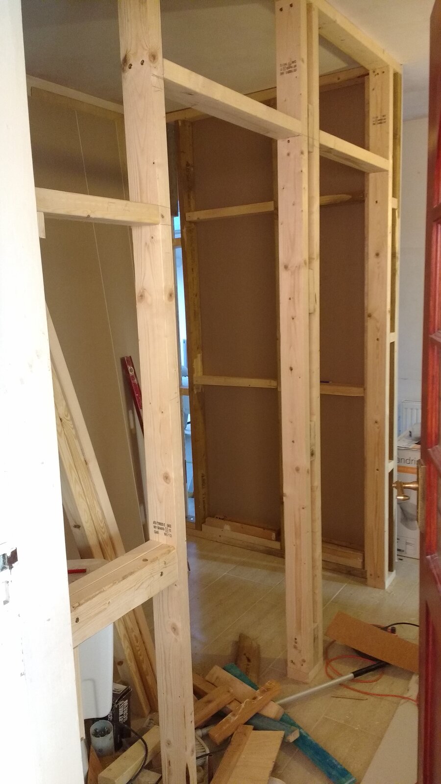

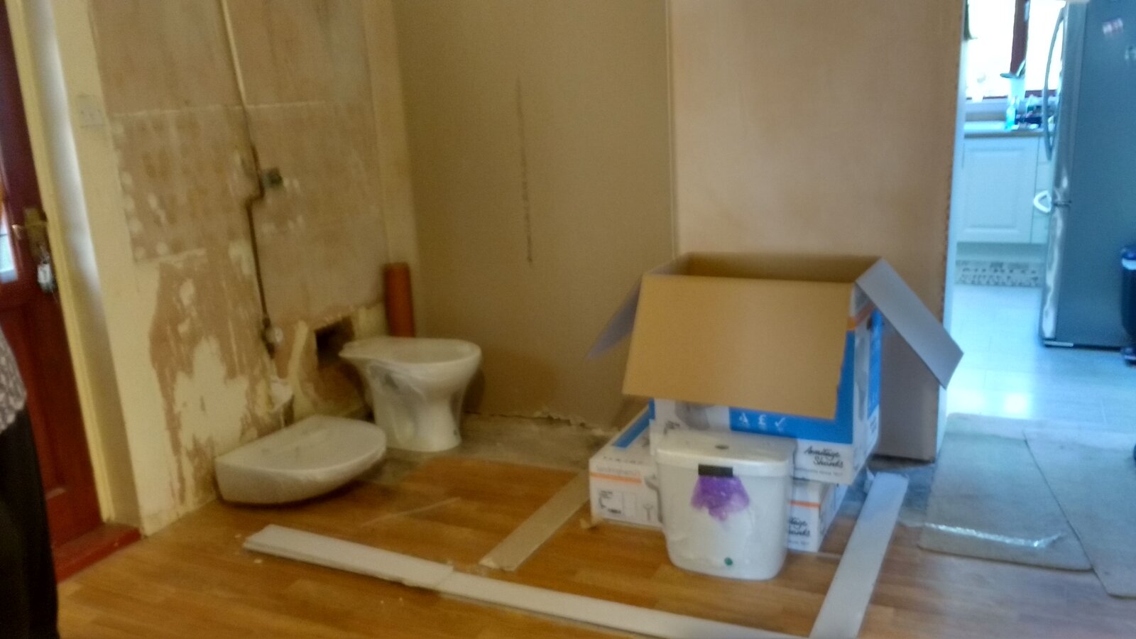

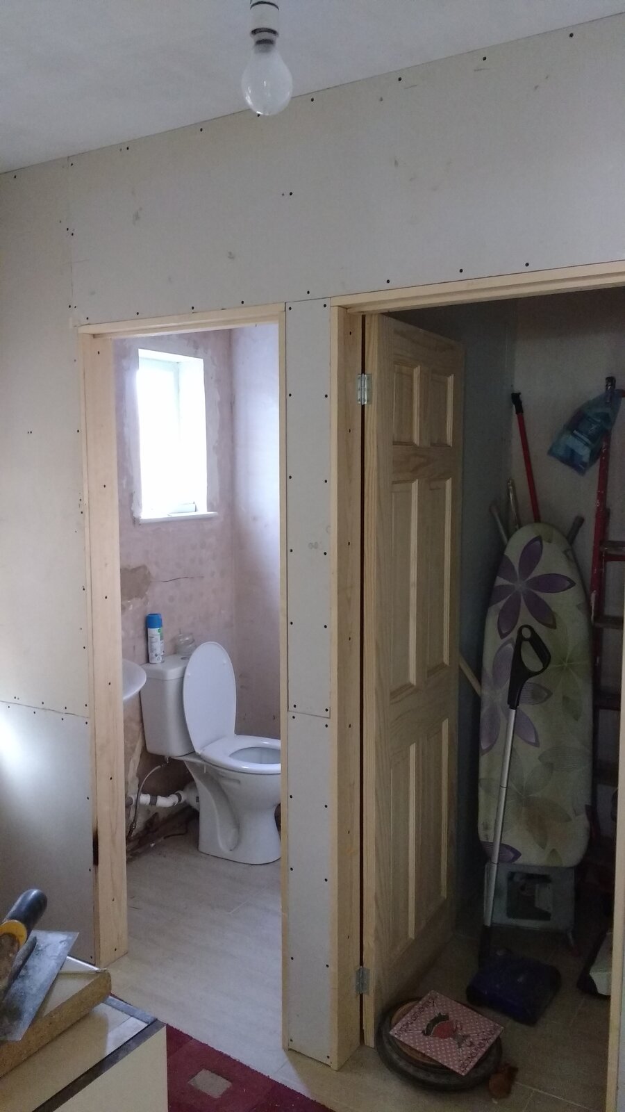

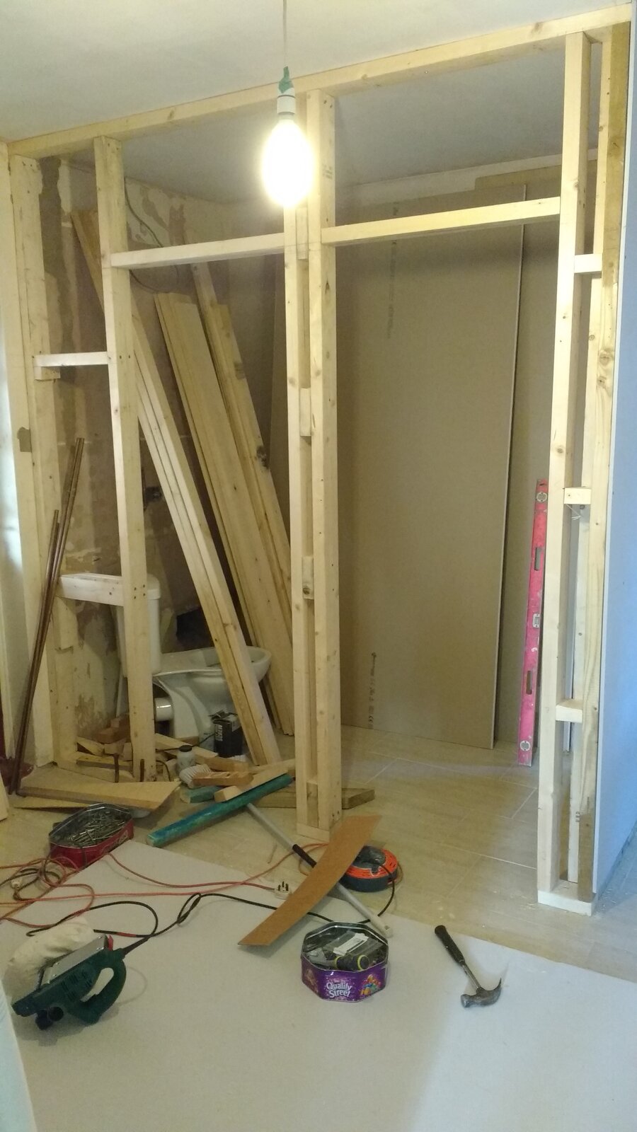

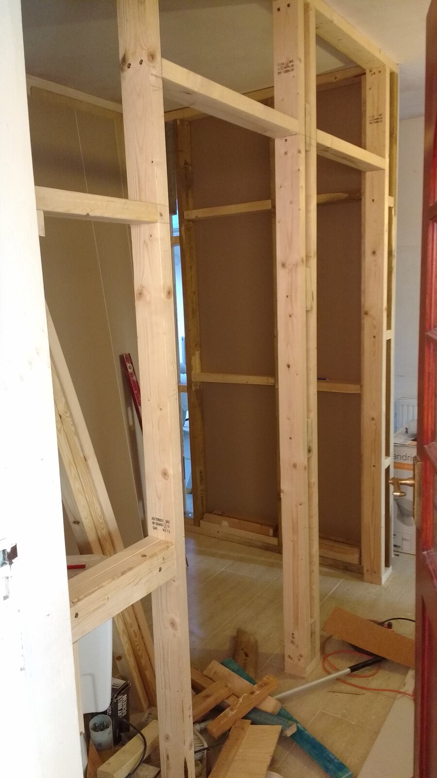

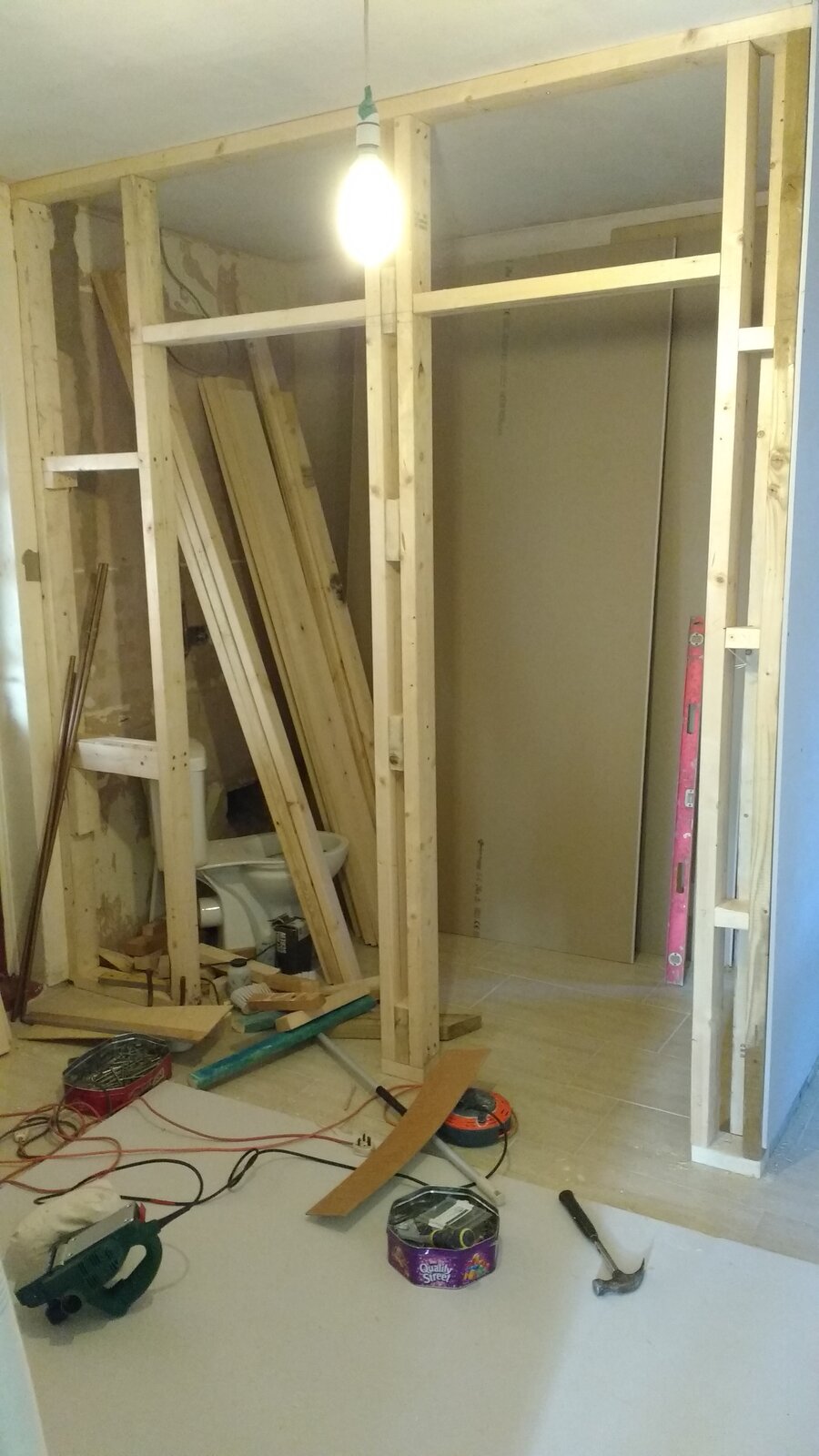

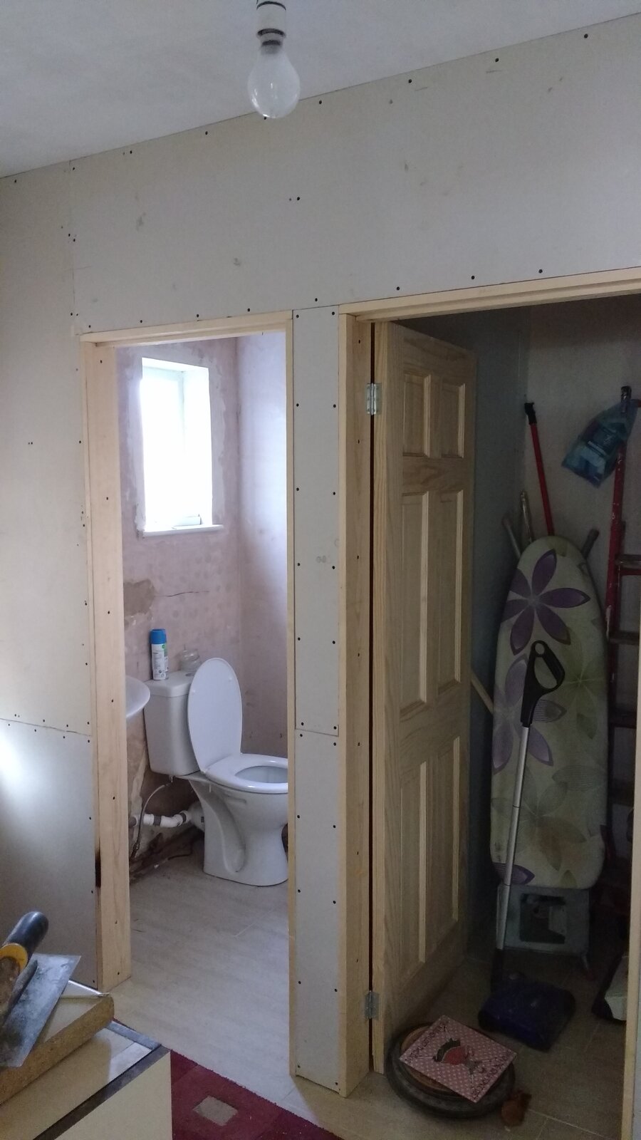

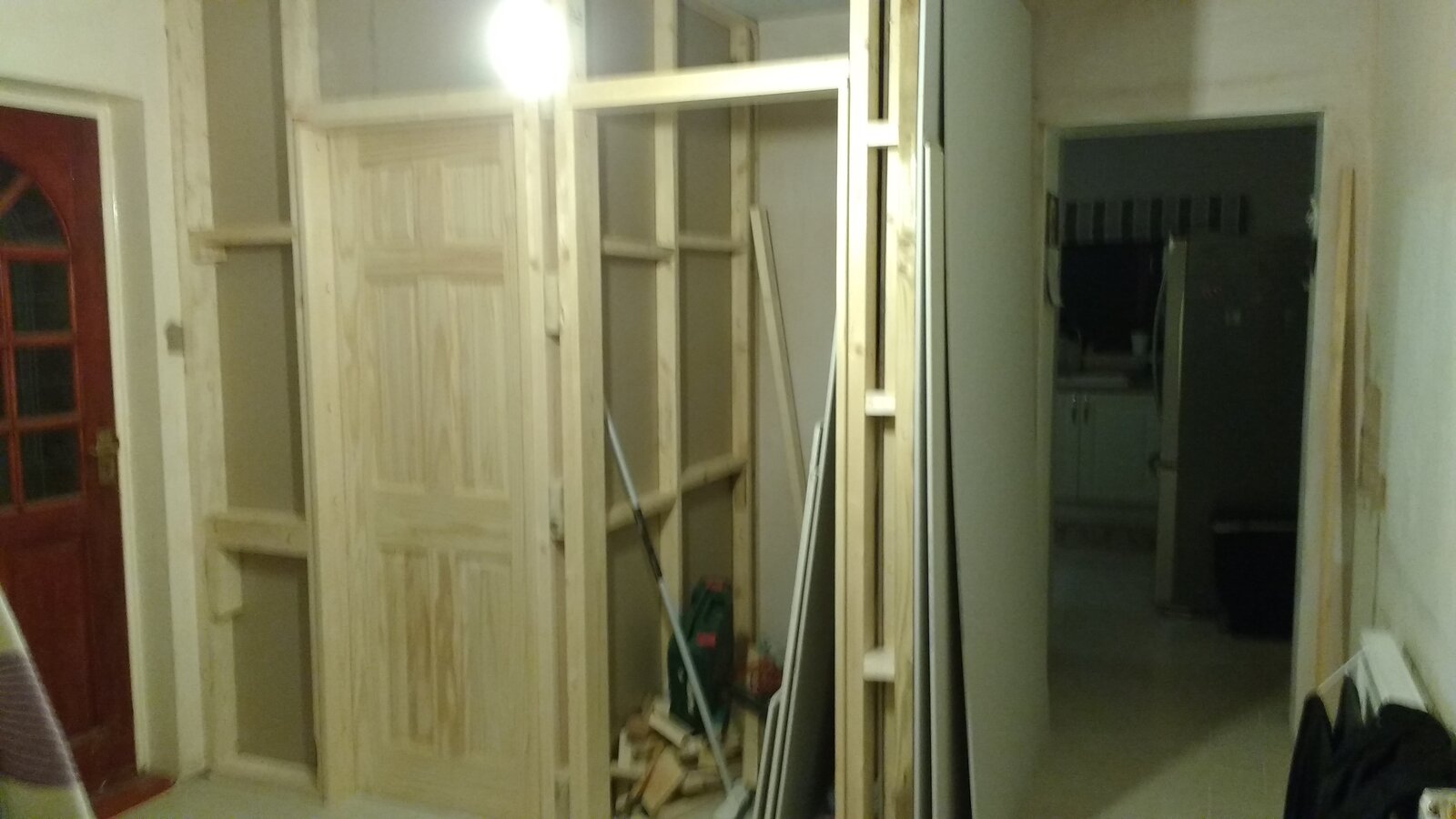

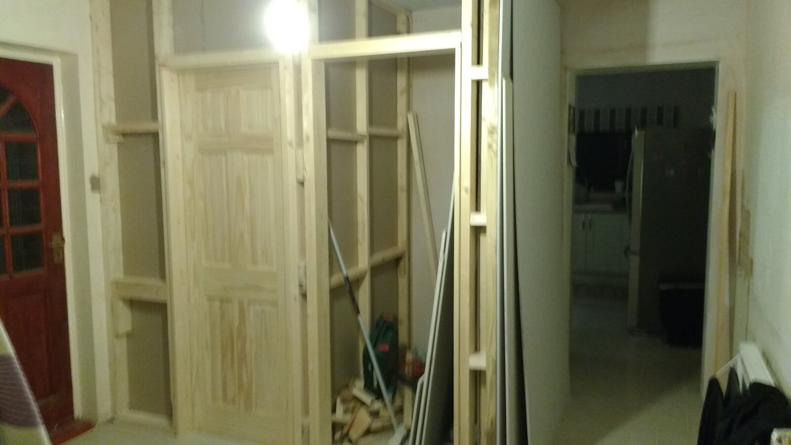

Not quite sure what why highly trafficked area has any bearing on what is proposed but stud walling would be my selection. A few pics of how I did my wc/closet. Basically 4 x 2's screwed to walls, ceiling, floor and infilled.
