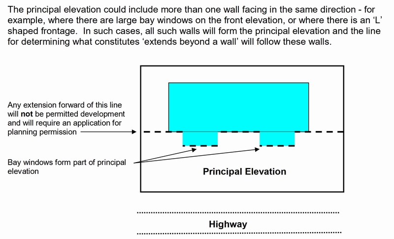

    With a house with bay windows, is the line you can't go forward of that of the main wall or of the windows?

    It's a moot point, but probably both the main wall, and the wall of a bay window.
    See page 15 (or thereabouts) of the Guidance for Householders, there's a diagram showing where you can't build beyond.

    I guess you mean this https://assets.publishing.service.g...e/830643/190910_Tech_Guide_for_publishing.pdf , and p15 says
    Its actually an idle Q, really - just curiosity. Our house looks like this
    and over the front door (not drawn) is a flat timber and roofing felt canopy. Nothing really wrong with it - its sound and doesnt leak, but its rather uninspiring, and weve been wondering what to do,especially given that it may come down for EWI reasons -

    Interestingly, an appeal case cropped up on the Planning Jungle website this morning concerning this very issue.
    An inspector determined that the line beyond which you can't build is simply a line through and parallel to the front elevation, extended to either side as far as the site boundary, regardless of the bend of the road.

    Why would it need an inspector to determine that? It seems common sense that the line would follow the line of the wall, it actually says so in the guide, and for at least as long as I've had teeth, the concept of a building line as been clear - a line that follows the building wall.

    I agree with Woody - it seems b*****n obvious that lines are wrt the building. From what Clifford says there could perhaps be some debate over which is the principal elevation, but other than that...

    Fair enough. But that does produce some potentially bizare results with a bendy road and a very long road frontage.
    A house facing the point of a U-bend for example could have a back garden with a long road "frontage" entirely behind the straight building line as defined.

    What is the principle elevation or side elevations fronting a road are clearly defined in the guidance.
