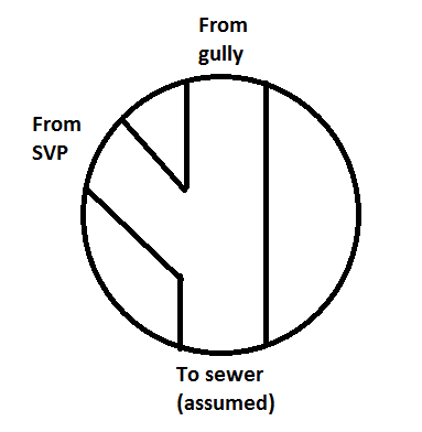

Picture of inside of the manhole may help.
Forgot to take one earlier, but have updated my sketch (see previous post). Does this help?
Sketch doesn't include Manhole, but by the sound of things, it should be OK.
As long as the Gully is trapped, it'll be fine. You may find yourself batter off by replacing the existing gully with a Bottle Gully, these have a horizontal outlet so may be easier to make a shallow connection, and means only one connection required to existing drain, everything upstream from there is new.
I have started taking things apart now and excavating. Unfortunately I will need to break up the concrete surround of both the gully and the inspection chamber, and temporarily remove them, to have enough room to line up the core drill for the wall. As this is, I may decide to relocate the gully slightly when re-installing it, and have it discharging into the drain from the vent stack (black diagonal line on first sketch).
The 'manhole' is just a shallow inspection chamber as shown below. The channels have a removable plastic cover moulded so that the channel and its cover have a circular cross section when installed.
