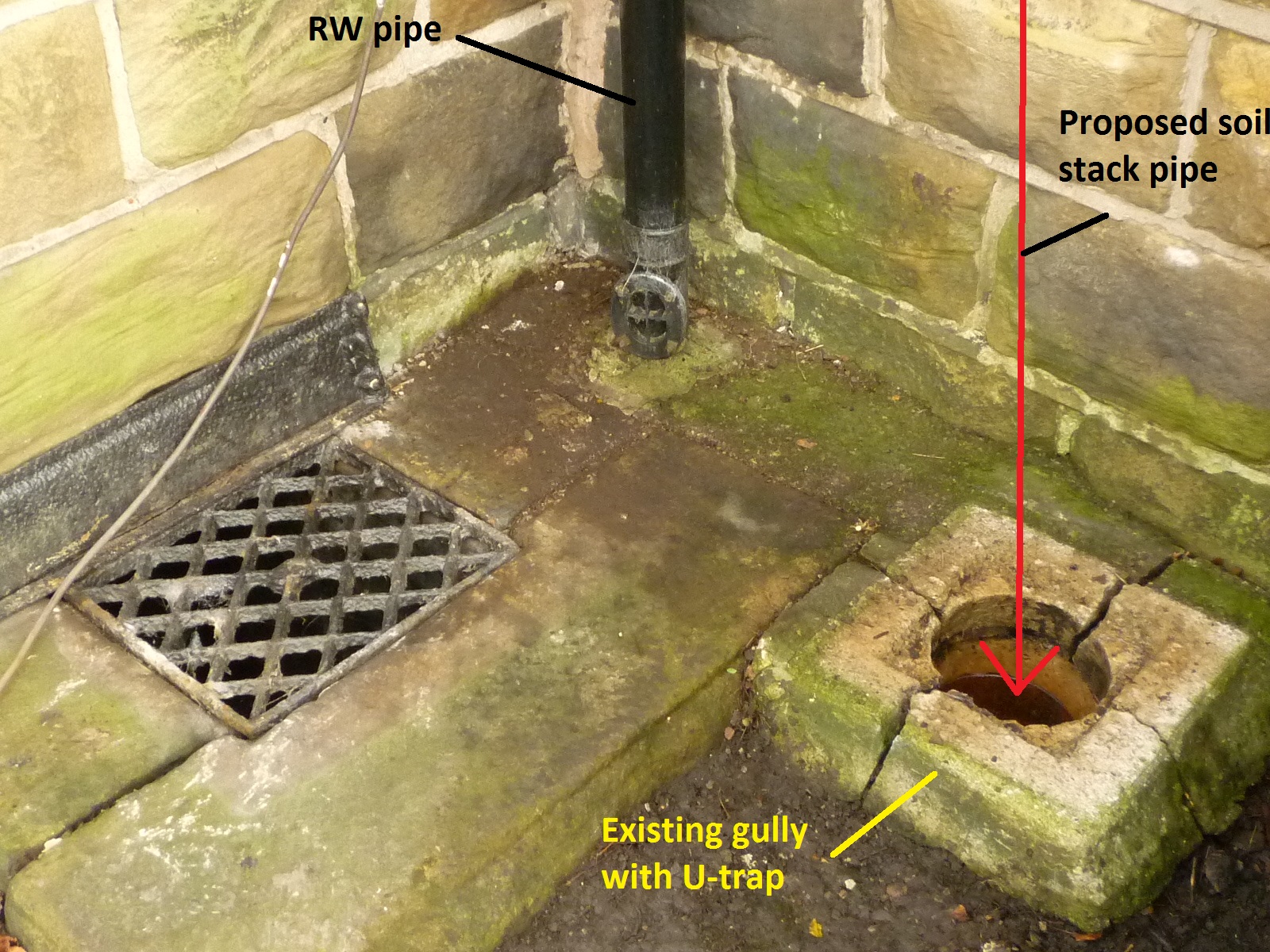

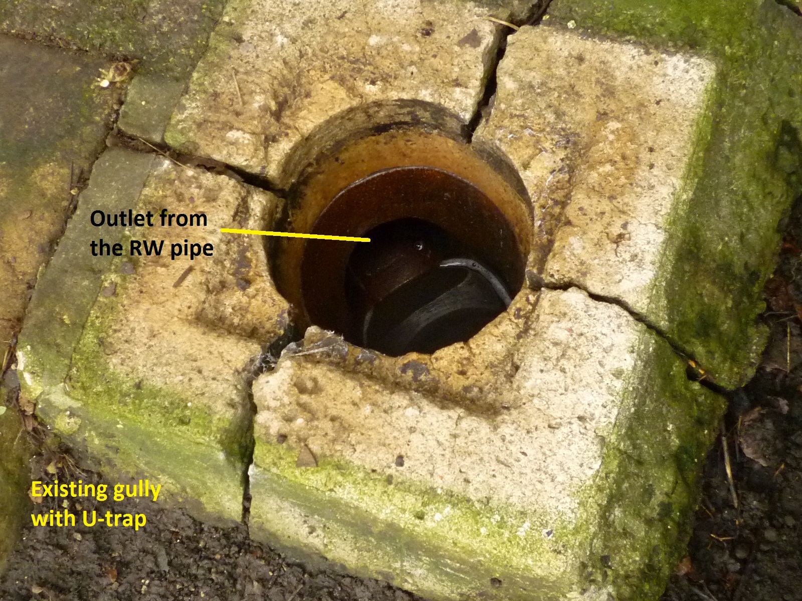

Greetings everyone.
I wish to convert one of my property's ground level open gullies (connected to main foul drainage) for external soil stack pipe use but I understand that the base of a soil stack has to be a rest bend, not a trap.
So, if I replace the existing trap with a new rest bend (200mm radius as per Building regs), how should the RW downpipe be connected?
Furthermore, I will need wash basin and bathtub waste pipes to be installed from first floor (currently no bathroom there), so if I put an external wall hopper at first floor level, how should be the base of the hopper downpipe be connected to the drainage?
Advice welcomed. Here are photos of the gully in question:

Just dig up the gulley, put in a rest bend at the bottom of the stack and a new gulley under the downpipe, then join them together with a branch into the remaining pipe stub.
Regarding this you can't put open hoppers any more like that, you'd have to either put them into the stack or have a separate 50mm stack to bring them down to the underground drains.
Dig out existing gulley, and cut back drain to a suitable point. Fit a junction, (assuming that length of drain is accessible from a manhole downstream, if not you may need to fit a mini chamber instead of a junction), take the branch across to the downpipe position and fit a new trapped gulley to take the rainwater, then continue forward to the proposed stack position, fit your bend and continue up with the stack.
As said above, Hoppers for waste pipes are illegal now under Building Regs unless as a direct replacement. Normal practice is to connect wastes directly to the stack via boss connections.

Traps on the appliances will prevent odours coming into the building, deeper seal traps are required when wastes are connected to a stack. Ideally stack needs to be vented so most odours will escape out the top to atmosphere anyway.
If using 50mm to the gulley, traps will still be needed on the appliances, the wastes are then connected into the 50mm pipe rather than the stack.

You'll probably find the old gulley is cracked and broken anyway, so you can get two jobs done for the price of one.
After you've dug it out, post some pics.
