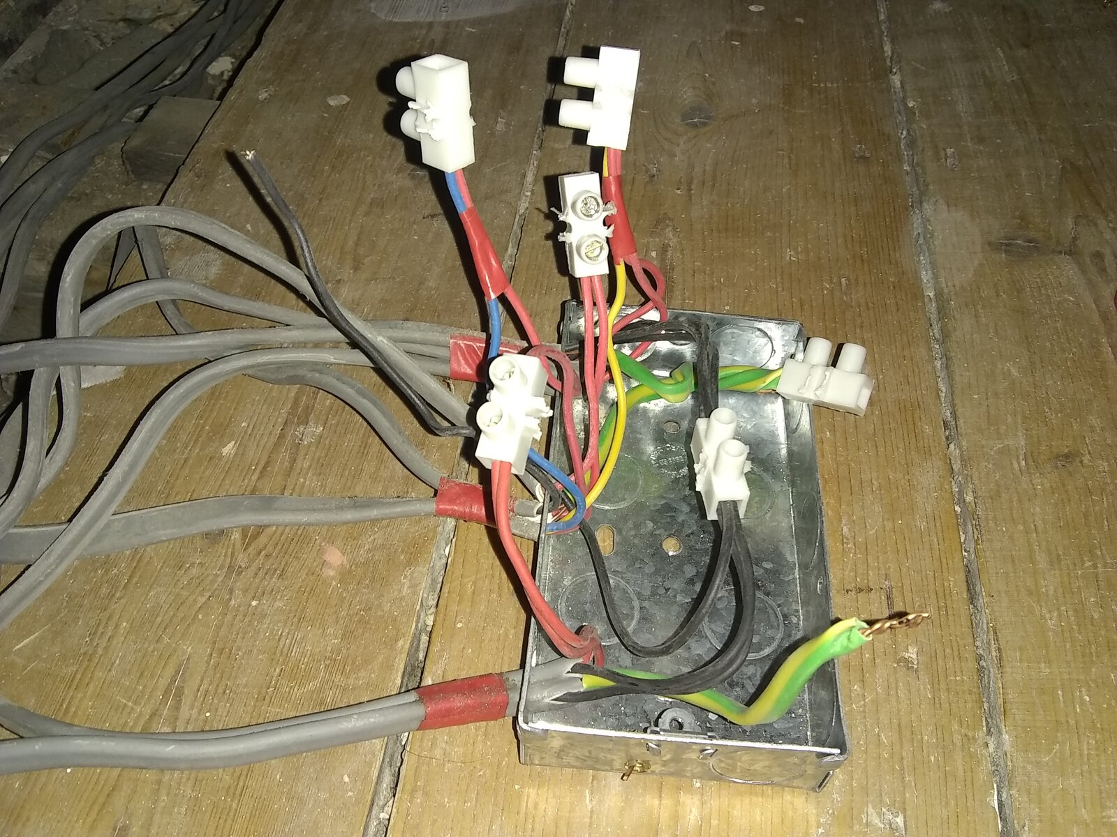

Hi, I found this (Pic 1) under my son's floorboards so I thought I'd tidy it up and put it into a connecting box (Pic2). As there are a lot of cables it was quite tight, is there a better way to do this? The cables are 1.5 T&E for the lighting. Thanks

Well, the enclosure does not really matter - back box with blank cover or junction box - but either way the cable sheaths should enter the enclosure (grommets on the back box) and cables be restrained so they cannot be pulled out, and boxes must be maintenance-free if to be inaccessible.
There are various boxes like this around:
https://www.surewire.co.uk/
Also, have you done it right?
There are two reds with the yellow in the first picture, and
what did you do with the separate black?
Looks a nice tidy job.
no point messing with it, now you have done it.
grey sheath should be in the box
Really
Yes I wired it in wrong, one of the reds is in the wrong place and the sitting room lights don't work I'll have to try and find which red it is, is there an easy way to check other than trail and error? I have a multimeter. The black was not attached and just loose so I didn't put it back, everything else works OK.

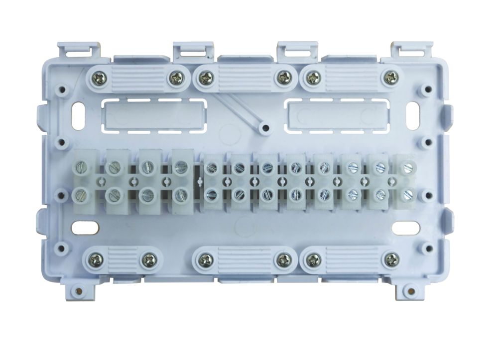

i haven't see the "surewire" product, but there is a handy surface box used by boiler fitters, they call it a wiring centre but it is just an insulated enclosure with lots of connectors inside. Some of them are groupled or labelled for "timer" "pump" "motorised valve" or something, which you don't need, but the way the cover comes off makes them very easy to use, and they usually have lots of knockouts and cable grips.

usually 12-way or more
You can write descriptons inside the lid
DIY sheds and ebay have them.
particularly handy in a bathroom or cloakroom where you want to run one or more lights, a timed fan, a heated mirror, a shaver socket etc.
or a kitchen with hood, concealed lighting, spots etc
BTW your metal box needs grommets in all the knockouts or the sharp metal edges may chafe the cables.
Cable tie anchor points with ties supplied, and / or cable clips used externally

Yes it would be inaccessible, the wago 221 series would seem a good idea, I've seen the Wagobox XL 115x135x55. Anyone have any experience with these, any draw backs?
Why we are talking about wiring centres with screw down terminals, I do not know.
If a wiring centre MUST be used, the maintenance free Wago L32 wiring centre is available, which may serve the purpose.
