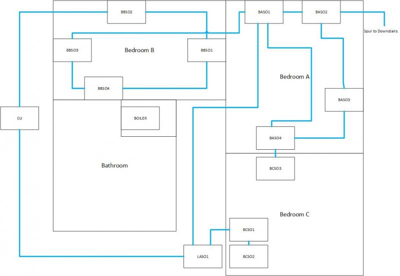

JohnW2 - The "actual", original ring that goes back to the CU comes in from the 2 sockets in Bedroom 2. ie the original ring was BBSO1 - BASO1 - BBSO2. BASO2 and BASO3 were added later and badley wired in from what I can tell. My fix is to break in to the original ring as per the second diagram
OK, but whatever re-arrangements you make, it is crucial that all the sockets end up on a single, 'closed', ring (from the CU, through sockets and then back to the CU), other than any individual sockets which are on their own spur off the ring (i.e. only one socket per spur, and no 'spurs' from spurs'). As deadshort has implied, if you do not achieve that then to have 2.5mm² cable protected by a 32A MCB (if that's what it is) would be neither safe nor compliant with regulations.

Hi Guys thanks for the input so far.
So today I have basically disconnected all the plug sockets on the upstairs ring, labelled the sockets in the back box and and labelled each cable, then used my cable tracer to to map out all the cables. The original layout is below.

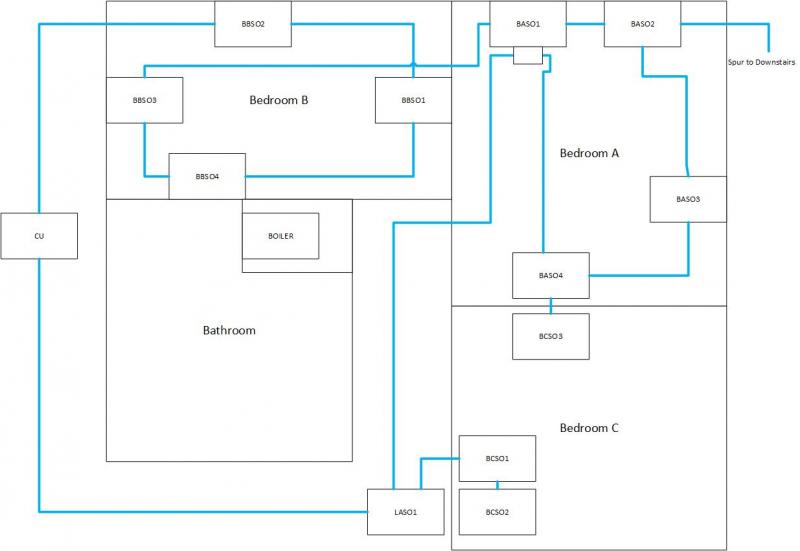

I have now crimped to of the cables in BASO1 to remove the second ring. it is now wired like this
The intention is to remove BASO4 as that will be behind our new wardrobe. I will run the ring through the wall to BCSO3 and the other sockets in Bedroom C. This way all the spurs (bar the one to the socket downstairs will have been removed and I should also have reduced the length of the ring. Somewhere there is a junction box as the boiler is powered from a fused spur. I will therefore need to find this junction make sure it remains connected
The CU has a 32A MCB
