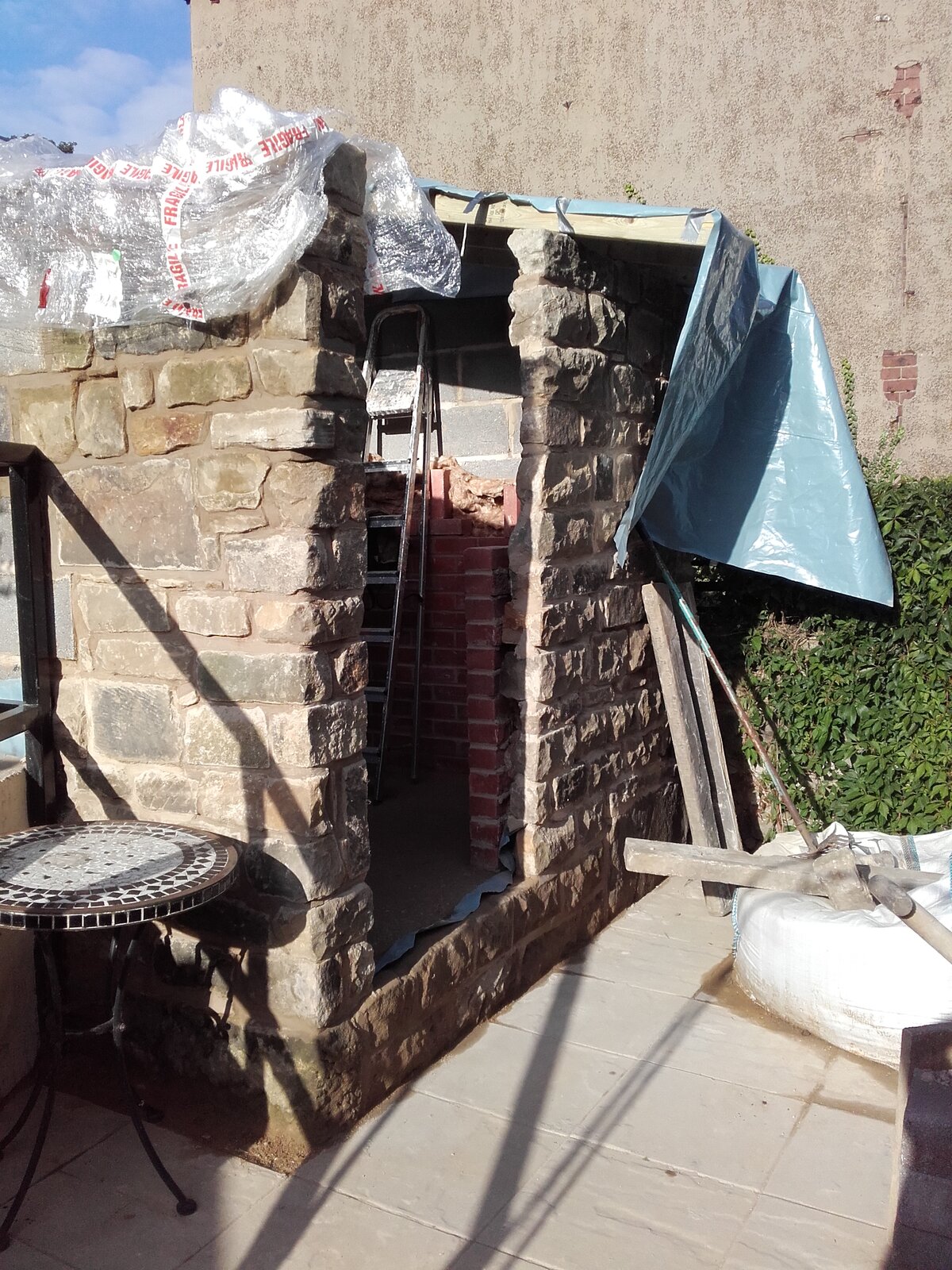

Great convo...this place is great man haha, so not sure whats my best here...going 2 inches into the harwood frame then into stone as seen attached on pic,
so is it these:
https://www.screwfix.com/p/fischer-nylon-hammerfix-8-x-120mm-50-pack/90560
or is it these:
https://www.screwfix.com/p/easydrive-countersunk-concrete-screws-7-5-x-120mm-100-pack/9008h
Either way Id take a plug from scraps of frame to cover and match color to plug counter sync.
is it 3 screws either side and 2 on top. so 8 total then sill I bed with mortar.
Expanding foam (joke)
Top ones in my opinion are better for a wooden frame. But either will ultimately work
