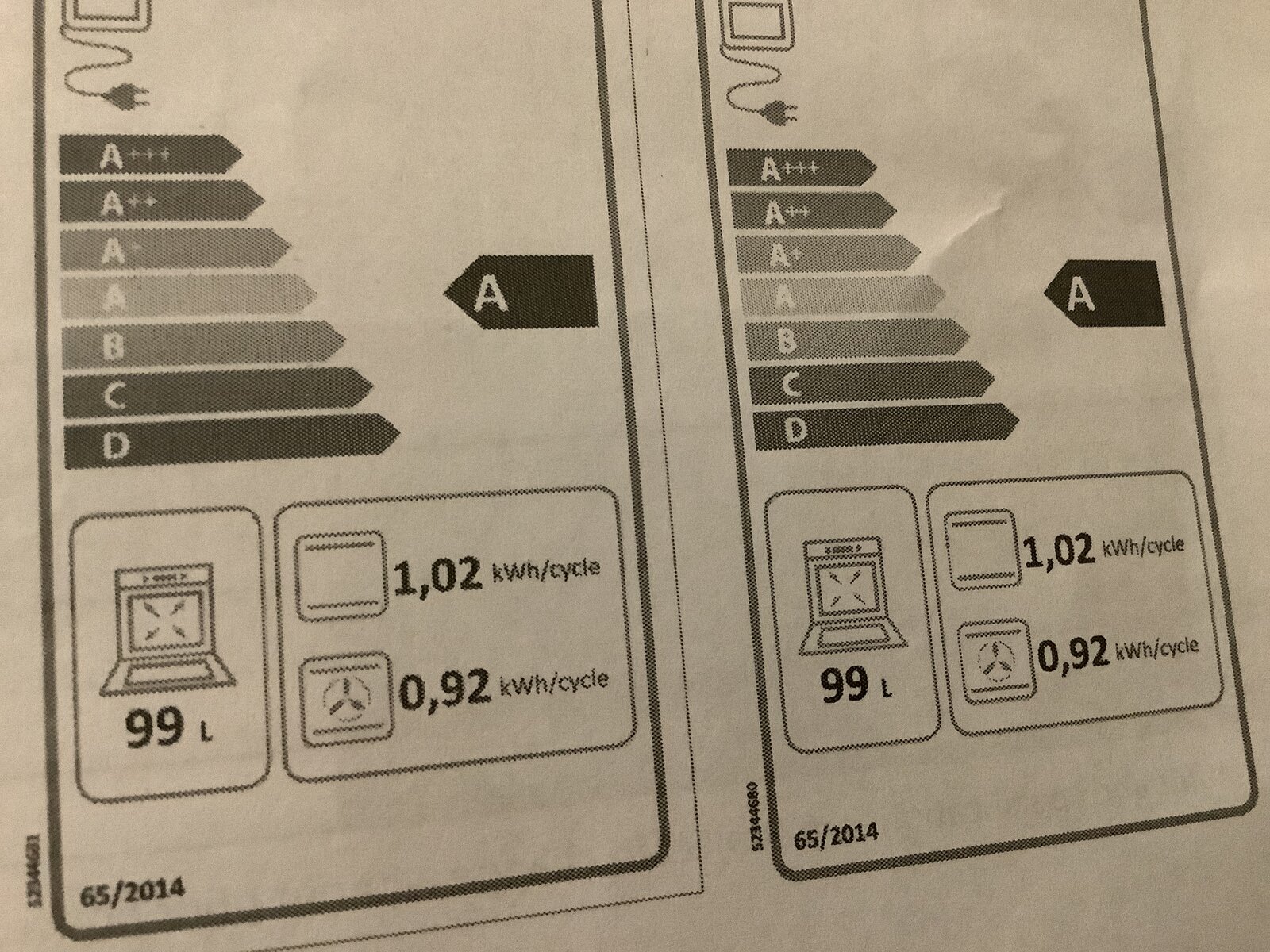

none of the setting require more than 1kw except upper lower element when combined , 2kw
How certain about this are you? Seems a bit low for an oven. Even my toaster on 1-slice mode is using about 1kW.
Manual says 1.02kw/cycle for conventional oven and 0.92kw/ cycle for Fan forced ( eco mode).
Of the three ovens we looked at this was the highest rated, others were 2.05kw and 1.05 kw. They are well insulated and A rated for power use, the 1.05 kw understandably had poor review mentioning slow heat up of the oven.

That’s what I thought , manuals are often out of date and being from Europe translations aren’t checked.
Actually looking at it again the conventional mode refers to top and bottom elements used together so even lower KW than I first thought.

Your numbers are the kiloWatt-hours (kWh) consumed and not the ratings of the elements. That kWh is printed on the label you picture.
My lates Neff double oven has similar cycle energy consumed numbers for fan-assisted and conventional heat modes in one oven, but has a 7 kW max possible input figure if both ovens are used in a certain setting iirc.
