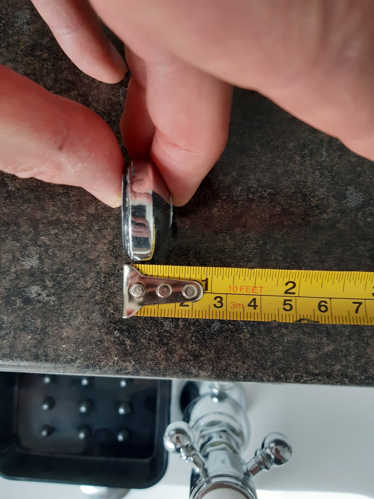

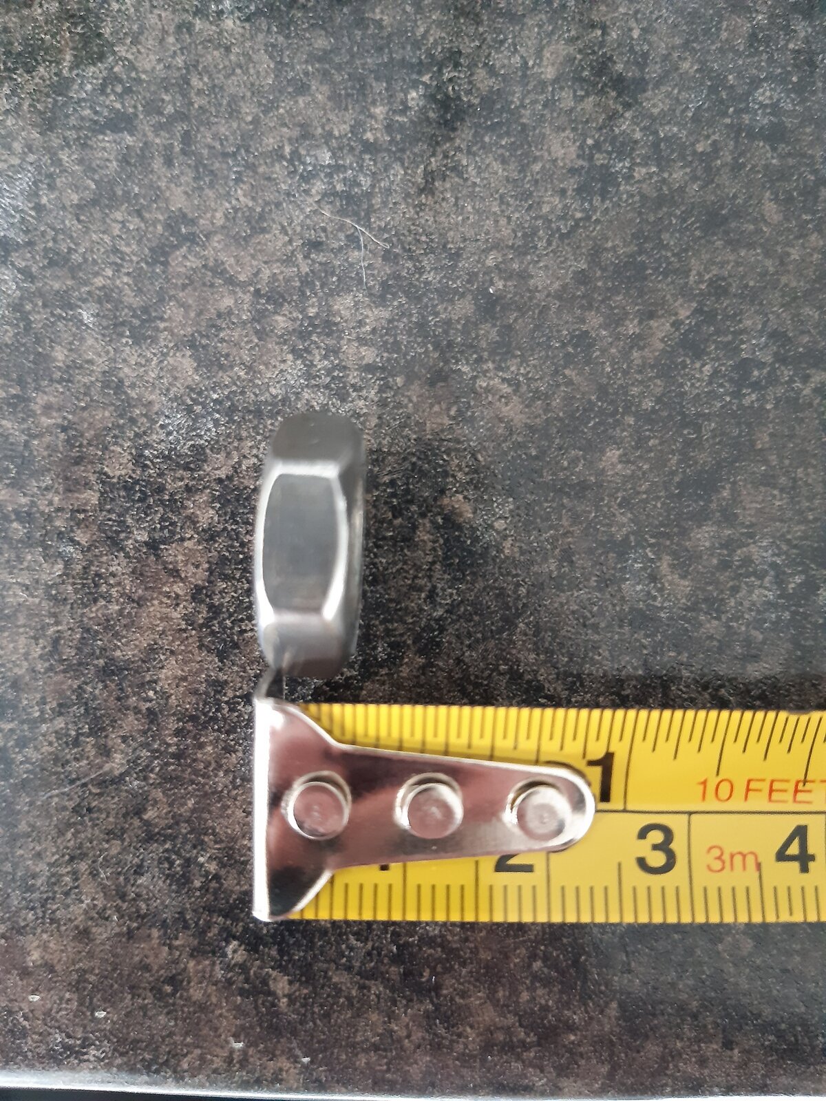

Hello,
A quick and hopefully easy question. I have a back to wall freestanding bath with chrome ball and claw feet. The fixing bolt (if that is the correct term) on one of the feet has snapped off at the head that balances the bath on the floor. After searching online for a while, I can't find any replacements, other than buying a new foot. Does anyone know the best place to get them and what the correct name is for them?
Many thanks in advance,
Kris

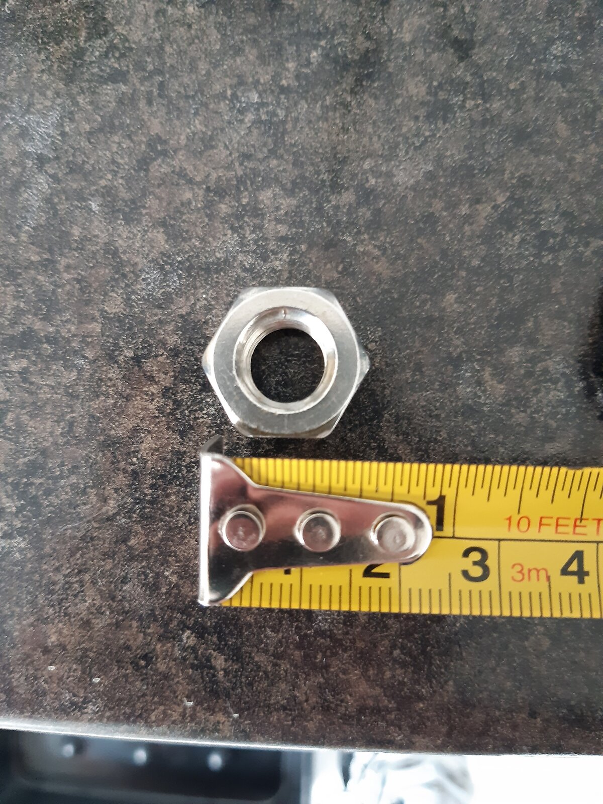

you mean a new bolt?
post a photo, with it lying on a (preferably steel) measuring rule or tape.
both the broken pieces
The precise dimensions are essential.
measure the length and the diameter, and count the number of threads per inch.
With luck it will be a metric size.
but also measure it in fractions of an inch in case not.
Was the old one stainless steel?
Do you know the manufacturer?
Thanks for replying, much appreciated.

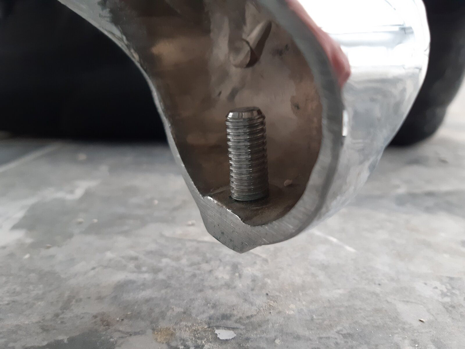

Yes, a new bolt, but starting to think it might be built into the foot as I can't remove it to take a photo.
Not sure if it is stainless steel, and unfortunately don't know the manufacturer.

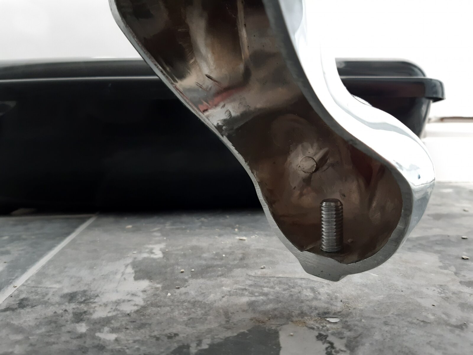

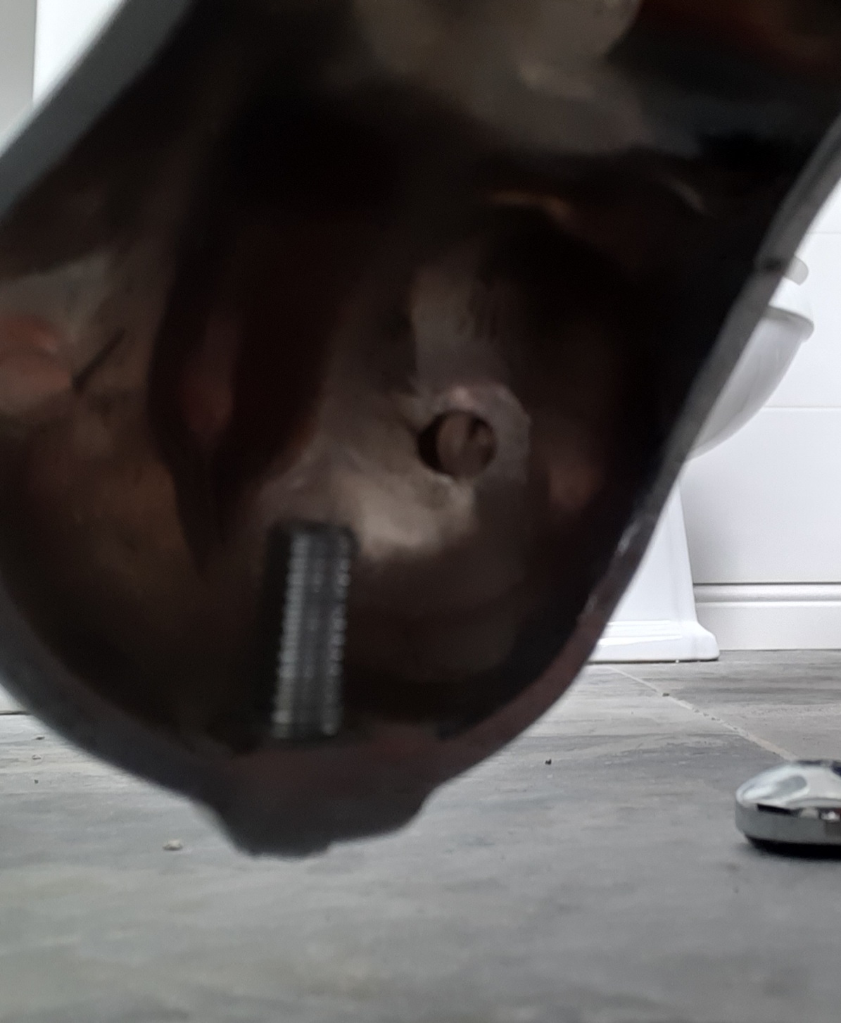

I have attached some photos that will hopefully help.
Many thanks again.
Take the foot + base metal pad and bolt along the an engineer/machinist - I would suggest they should be able to drill, tap and a splash of weld the bolt back into the metal pad (ball). It may need a longer section of threaded rod.
it does look to me like it might be stainless steel. That is in many ways an excellent material, but it is most often bought from China, where it has been cheaply manufactured for customers who want a cheap product, with poor materials, and is very weak and liable to fracture.
I don't see what would have made yours fracture, unless it was tightened or adjusted when seized (stainless needs a special anti-seize "grease") or into a poor-fitting accessory.
test it with a magnet, see if it is attracted (a) at all (b) more weakly than other steel.
if you find an engineer to repair it for you, they will probably be able to identify the reason for fracture and use a better material in the repair.
Consider replacing the other feet, or at least treating them with a stainless anti-seize and screwing them in and out a few times.

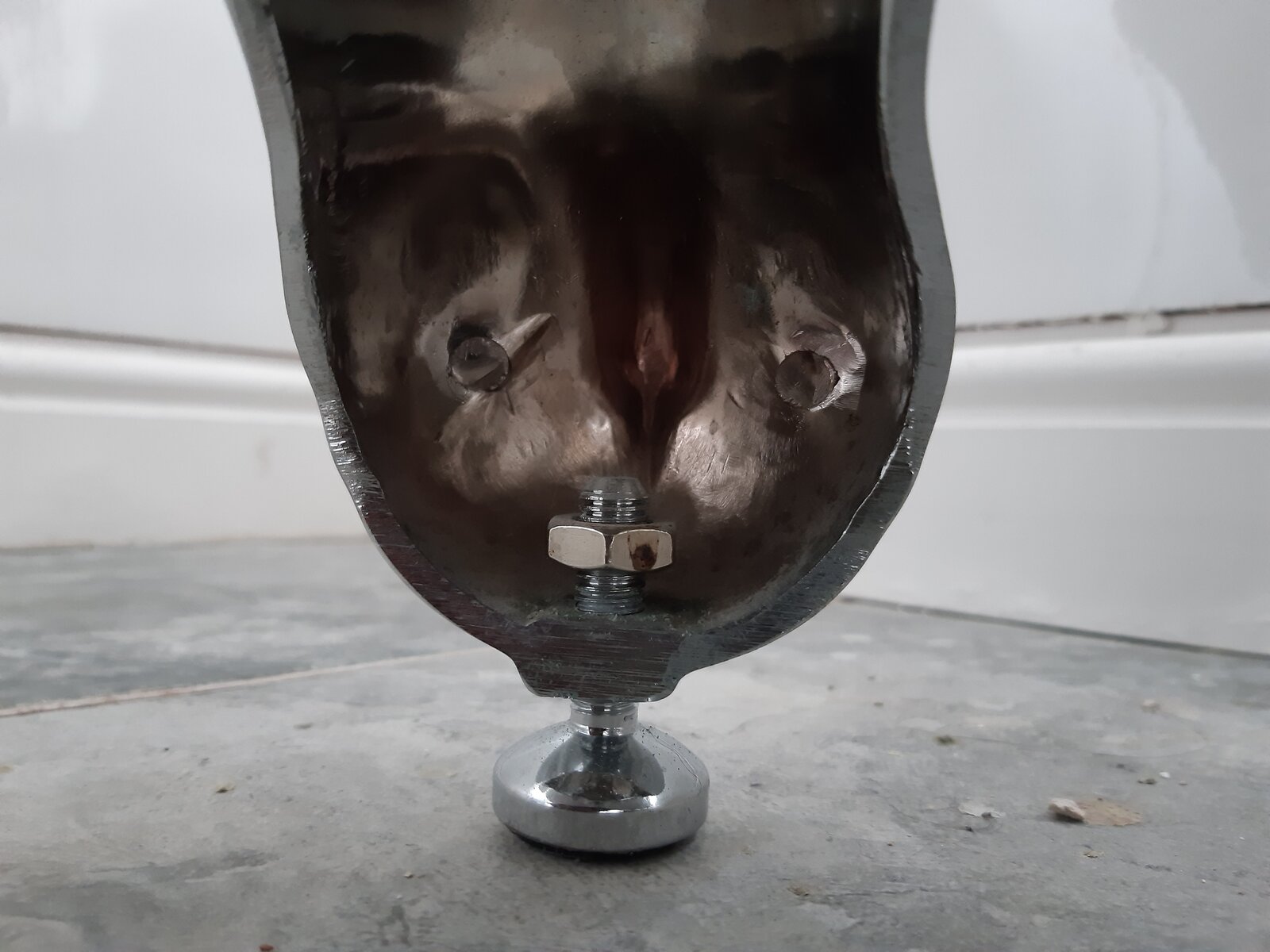

If you remove the black silicone/rubber pad from the base of the foot, would you be able to feed a new threaded bolt through it? Possibly using a nut in the underside of the domed base?

If one of the legs is in a less visible position you could make that a modified one.
Use suitable nuts and bolt and drop a Chrome cover similar to the ones on a car aerial to hide the head..
