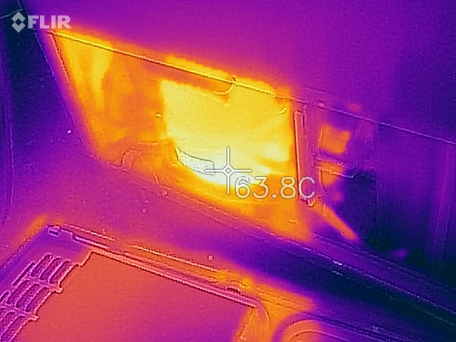

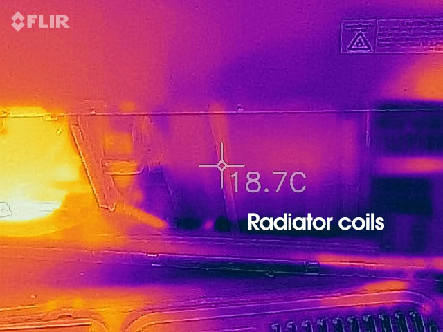

Hi all,
My Samsung American style fridge freezer has started to struggle to actually get cold. We noticed stuff in the freezer wasn't always completely frozen so tested with a thermometer to find it was only around -3C and sometimes even warmer!
The thermostat's resistance vs temp shows it's working normally. The fan is working normally, but the compressor is on 80% of the time in a regular cycle.
I have use of an IR camera and it seems the radiator coils are barely any different to room temperate but the compressor itself is around 70C and too hot to even touch.
Given it's 12 years old, I don't want to spend too much on it, but these are expensive appliances and if it's something simple like a lack of refridgerant, presumably it wouldn't cost that much to get fixed?
Anyone know if there are any other diagnosics I can do to narrow down the problem so I can get an idea of what's wrong before going down the route of spending £175 on a fixed price repair?

I took the cover off in the freezer area and there was no ice at all. I also found a way to force defost in the service mode and the heating element below the evaporator came on and appeared to work fine.
The external element was also relatively dust free but it simply doesn't get hot. Only the pipe leaving the compressor gets hot but the heat doesn't seem to flow further into the coils. So my instinct is that its a lack of coolant or coolant flow.
