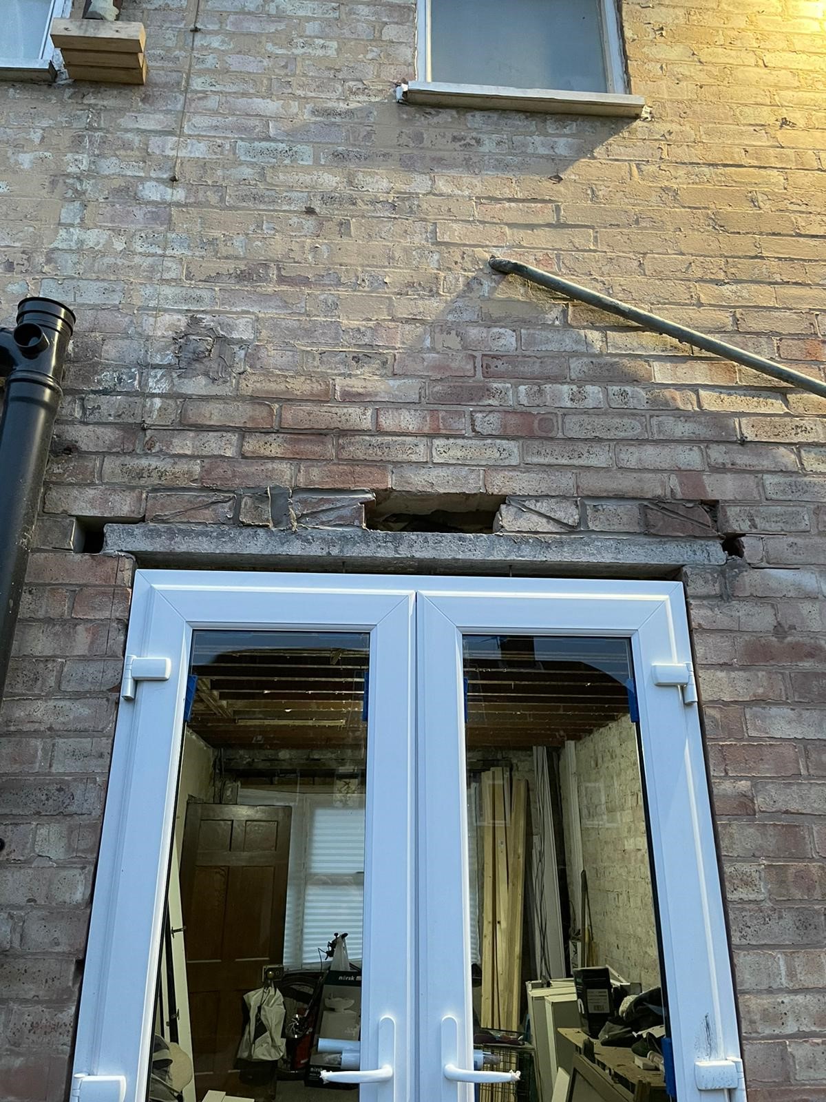

    Hello hope you are all well.
    A friend of mine has had a guy in to replace her window with a French Door and I was wondering if anybody could tell me whether they think this is a safe job please? The house will be rendered so not too fussed about what it looks like, just whether it's safe or not? Thanks in advance Doors.jpg

    Looks like there's not much end bearing and I can't see any evidence of a cavity tray. What has been used for a lintol on the inner leaf? Have B control seen it yet?

    Thanks for the message frutbunn, I've come in a little blind to be honest - I've not seen the actual work just this picture she sent to me. I will check on what you have asked about the Cavity Tray, Lintol and BC. I'm a layman really but told her I would ask as I didn't think there was enough overhang on the lintol, I was under the impression 150mm was required. Thanks again

    No it's complete shiite
    The lintel is too short
    The brick joints have not been filled to hold up the wall above
    The wall above looks like it's cracked
    The frame is too far forward which will lead to damp inside
    The doors are out of alignment
    Has he inserted vertical damp course up the sides internally?
    Has he installed a cavity tray?
    Has he applied for building regulations?
    Has he changed the internal lintel?
    Has he made good the threshold and damp-proofed it?
    Has he inserted thermal breaks into the cavity reveals?
    Has he got a well fed horse or a circus performance certificate?

    Thanks for the thoughts Woody, Seems like a bit of a nightmare, I'll tell her to get the guy back in

    Out of interest, is a 100 x 65 pre stressed concrete lintel strong enough for an opening like that, say 1350mm wide?

    UDL for that size lintel about 3.9kN/m, looks as if lintel is only supporting triangular brickwork load above it giving less than 2kN/m run loading so could well be
