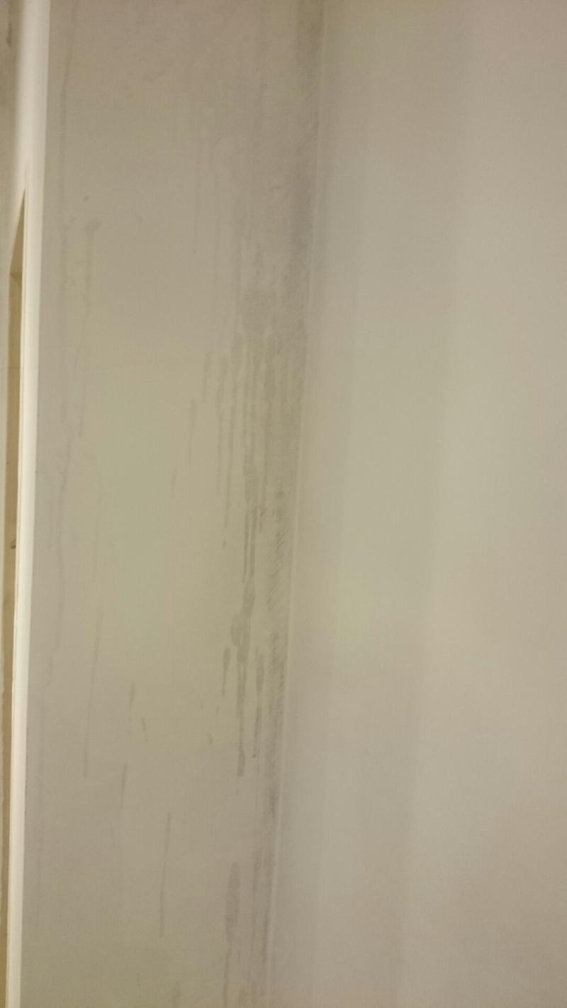

Hi guys,
I have just had the office skimmed and albeit a good job there are some water splash marks/runs where it wasn't trowled off once wet.
I have applied a few coats of white emulsion as a base coat ready to paint with the clolor but the marks are showing through the paint.
I did 50/50 water paint on first coat then a second 30/70 water paint and then a 3rd full paint and you can still see it.
Any advice?
It is fading away so should i just give it a few more coats?
It could be dilute PVA that is showing through, these can be hard to cover so need a stain block of some kind to seal over them before further coats of emulsion.
