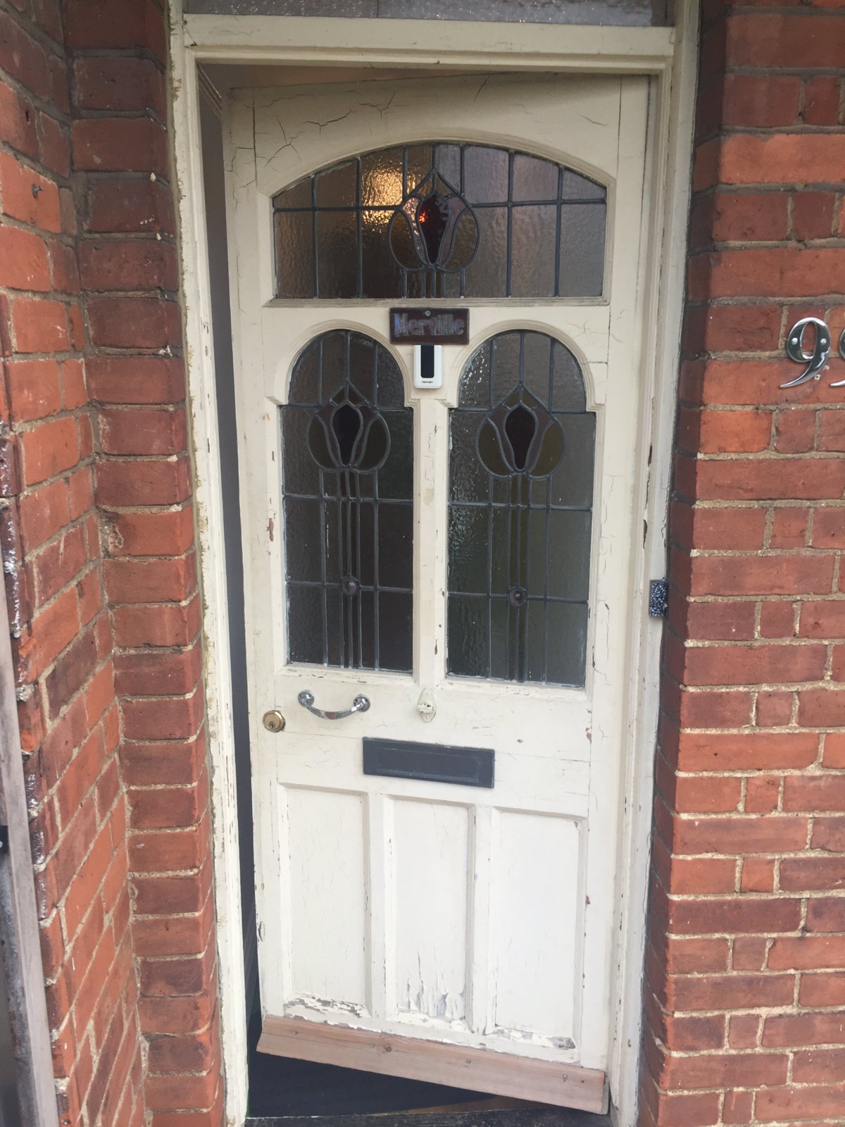

Hi,

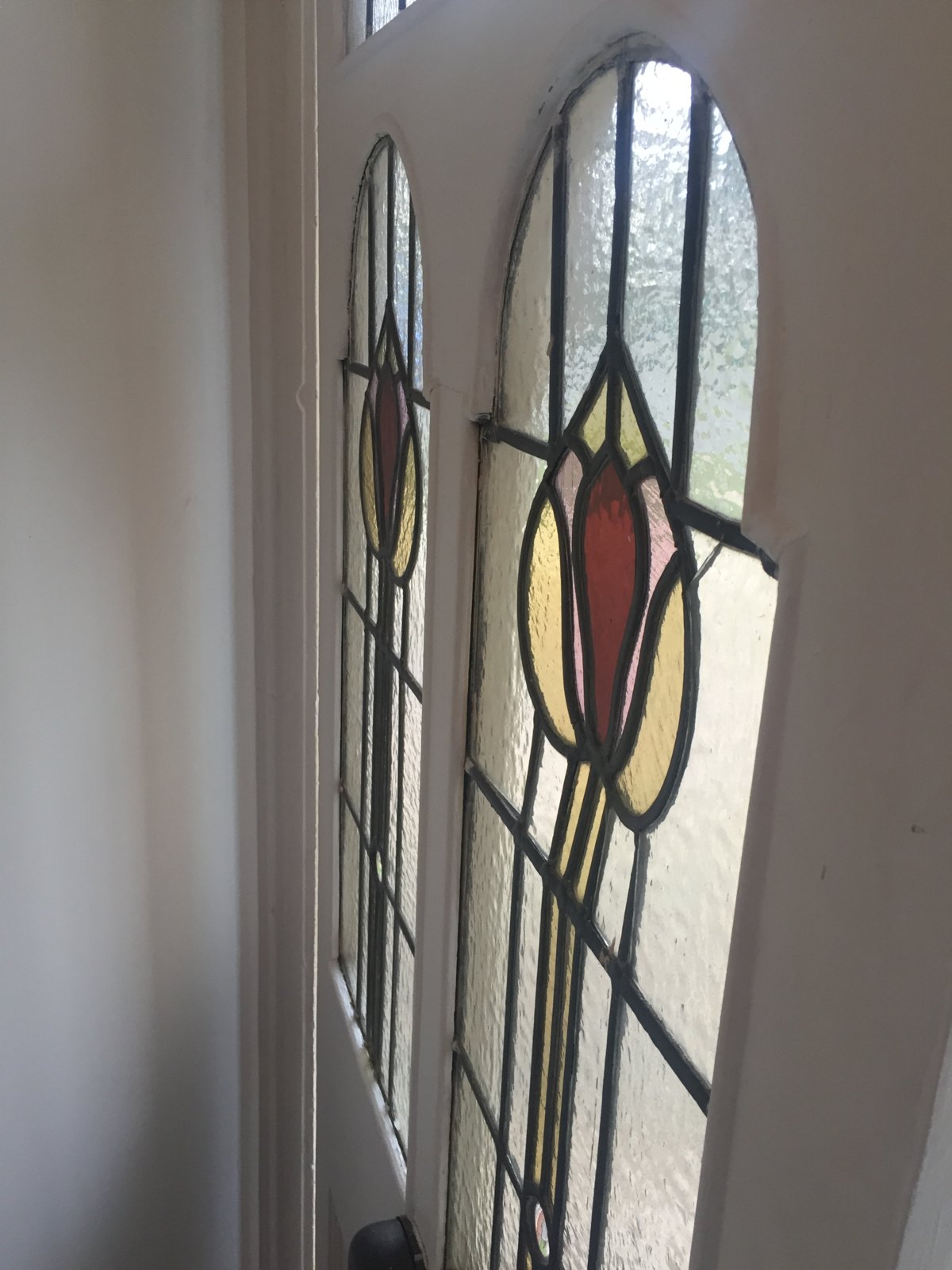

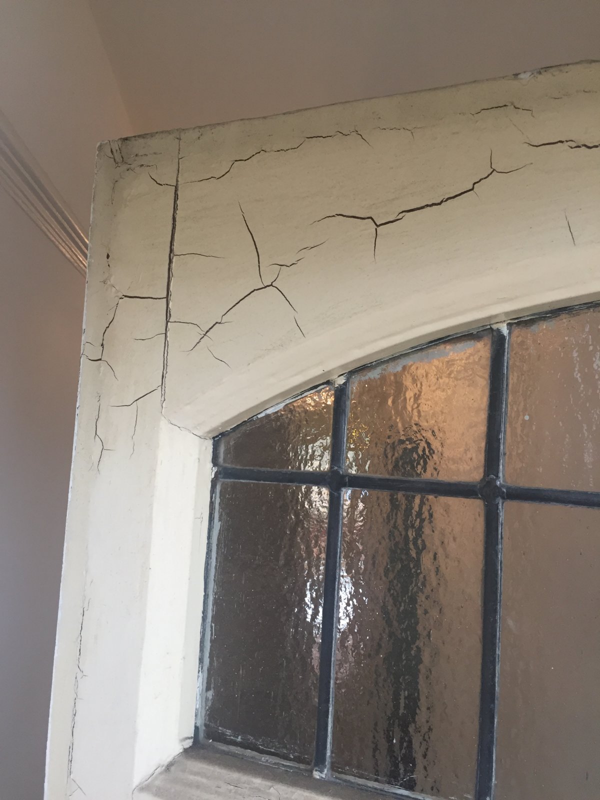

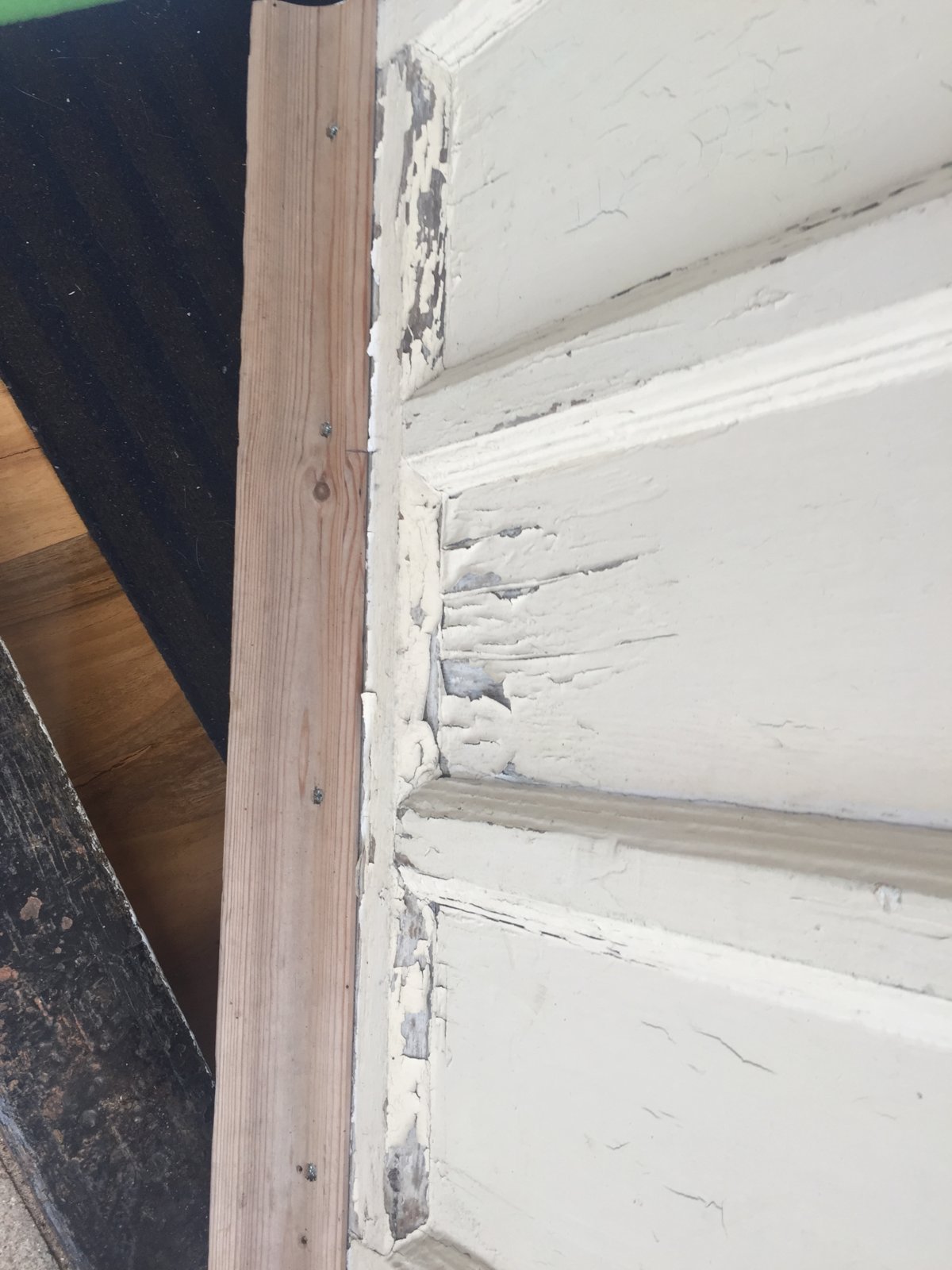

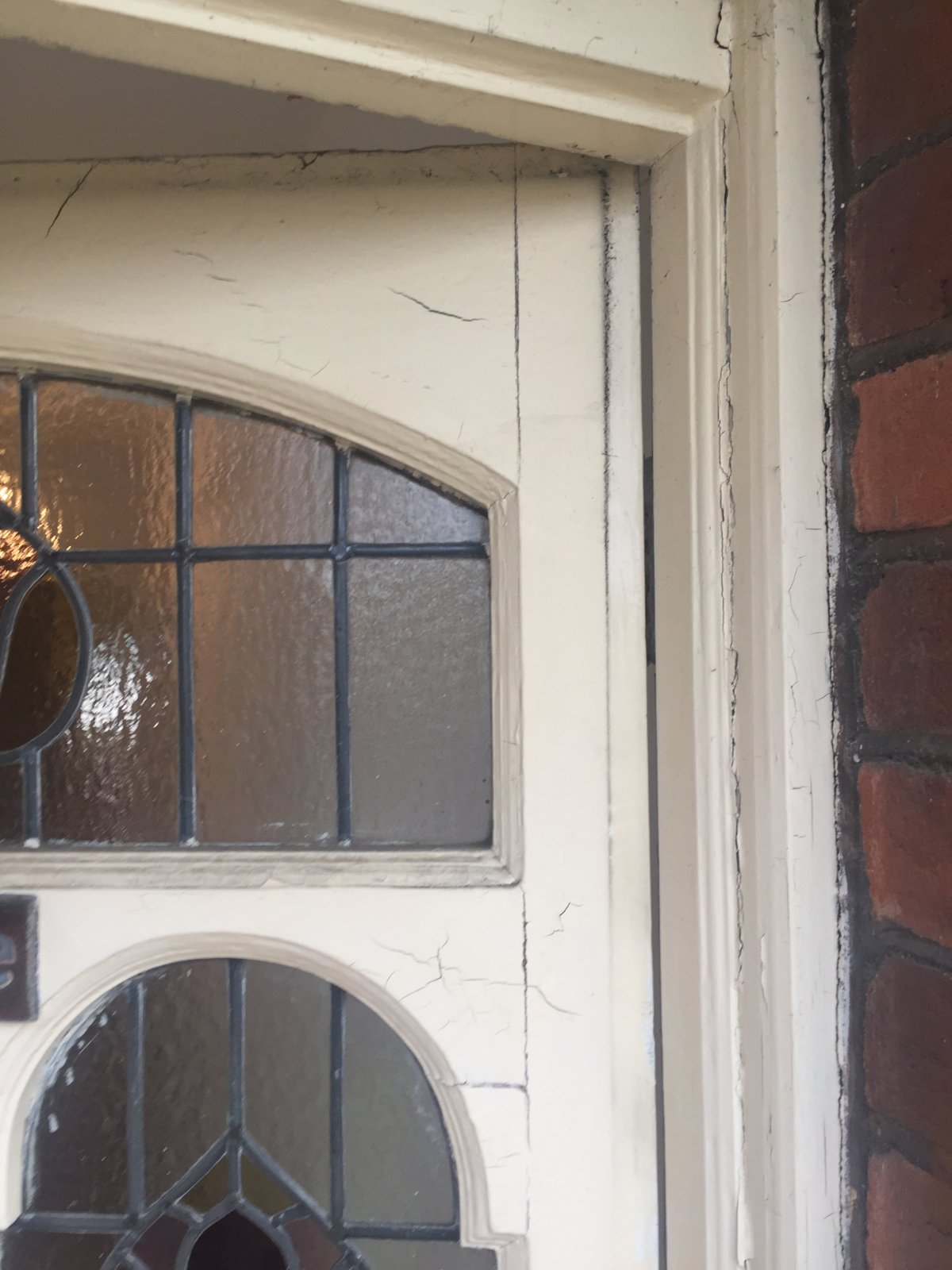

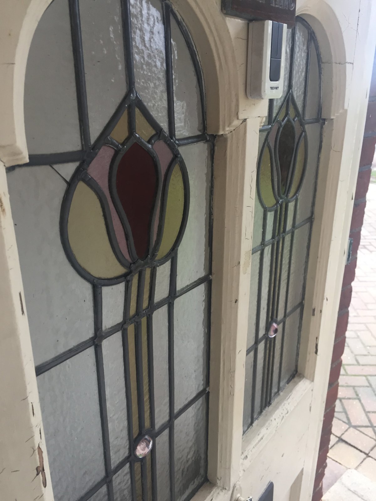

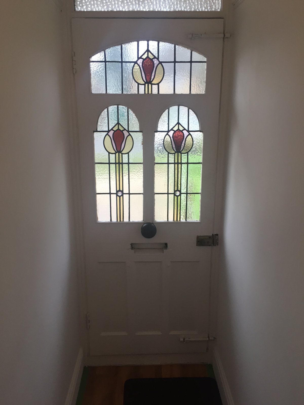

One of the last jobs I need to do on the house is the old front door which is in a sorry state. It would probably be easier to replace the whole thing but we are rather fond of the stained glass.
Firstly, the stained glass is in a bent out of shape on the left hand side (when looking from the front), but having asked around this will cost hundreds to fix, so I think we will leave it as is for now.
I had thought about getting the door dip stripped but that doesn't appear possible because of the stained glass. (The stained glass has a lot to answer for!) Therefore my current plan, after reading a few other threads is to:
1. Remove the door furniture
2. Remove the existing paint using Nitromors and a scraper
3. Fill cracks/issues with an external wood filler
4. Sand back
5. Apply primer
6. Sand as required
7. Apply grey undercoat
8. Sand as required
9. Paint in blue gloss (2-3 coats)
10. Re-attach door furniture
Given the time of year I thought it best to leave the door hanging. Does this plan sound right? Any recommendations on products would be grateful received.
Thanks in advance.
