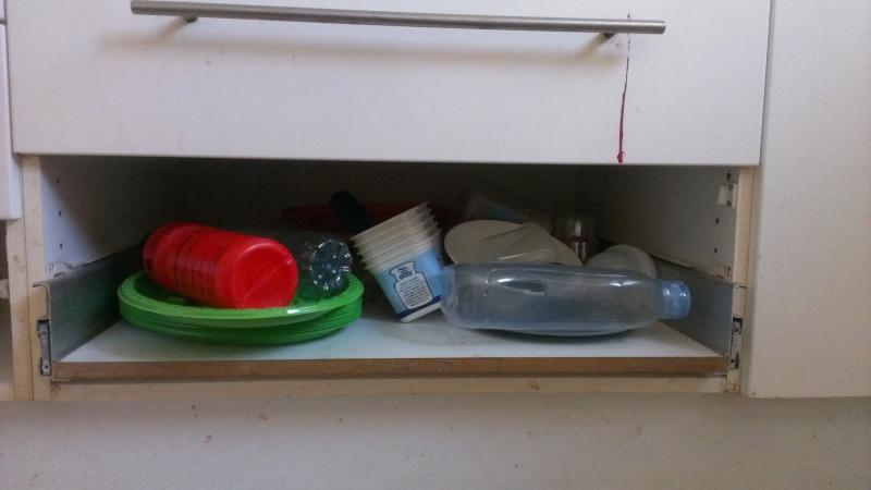

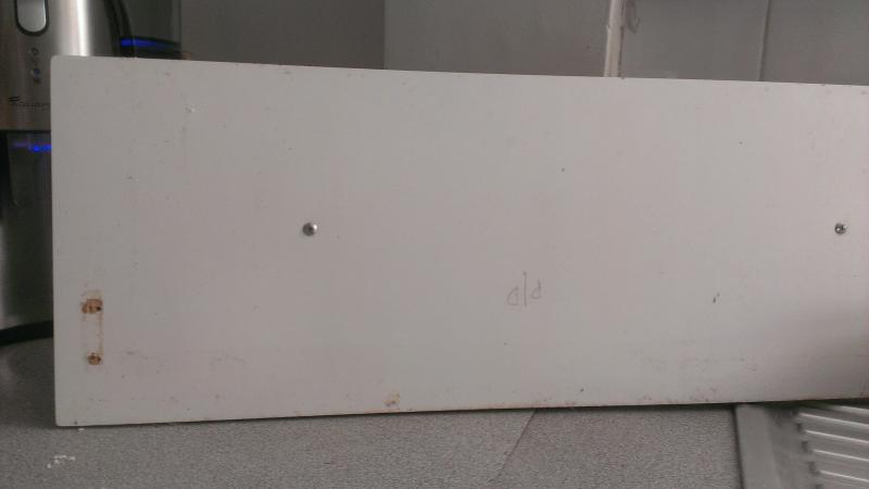

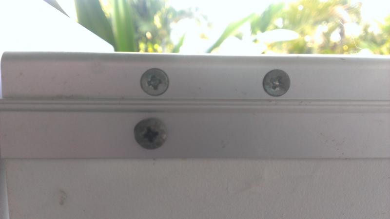

The fronts of my sliding kitchen drawers are progressively falling off. The screws that fit into them look just a touch too short, so it's no wonder.
I want to replace the screws with slightly longer ones.

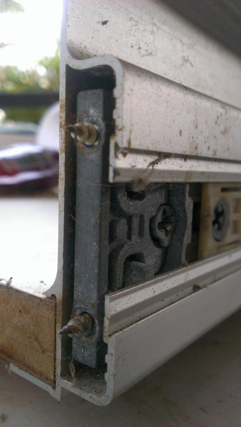

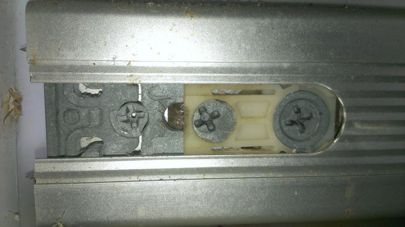

How do I remove the mechanism (in the picture) from the side of the drawer so that I can replace the screws and then put the drawer front back on again? I'm convinced there is a magic combination of the three 'screws' that will allow the mechanism to be removed simply.

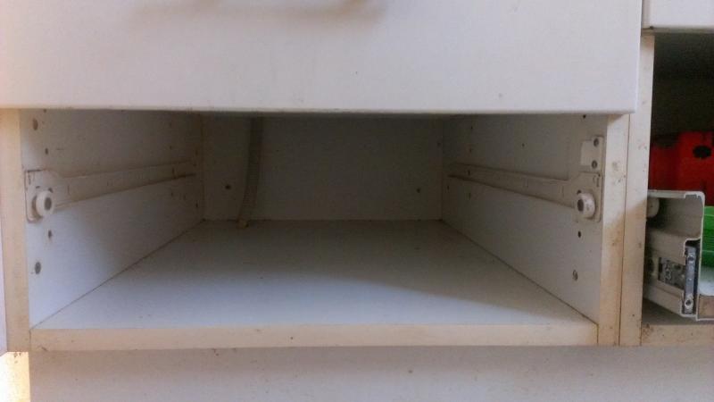

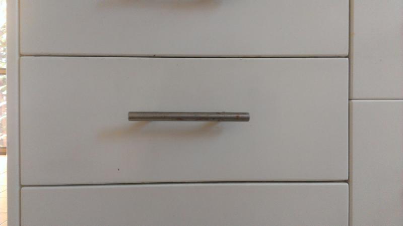

A front on picture and one of the draw front would be helpful.
Generally the mechanisms are factory fit, and the screws are used just for adjustment.
The draw fronts just generally snap into the mechanism.
Looking at the pictures, it looks like the first section, the darker section is the key component, have a look on the underside of the runners to see if there is a release catch, if not the plastic screw on the front section looks like it quarter turns in clockwise direction, this could help release this part to gain access to the screw fixings.

In response to your original question I doubt that you'll get longer screws to fit and in due course they'll pull out again in all probability. the screws are large diameter and very coarse. I'd say the best way to proceed is to bore-out the mashed-up screw holes with a Forstner bit (say 20mm or so), cut a appropriately-sized plugs (i.e a near perfect fit) from planed softwood, glue and cramp the plugs into the holes, trim back to the drawer front surface (block plane/flush cut saw/sharp chisel) then reattach your drawer fronts. At least that's how I'd do it
Either use J&Ks suggestion for the repair, or another possible alternative that occurs to me might be threaded inserts of appropriate size screwed into the front, something like these
http://www.ebay.co.uk/bhp/threaded-inserts-wood
and then use machine screws.
Obviously it depends on whether you can drill suitable holes into the front.
Either way don't just use longer screws.
