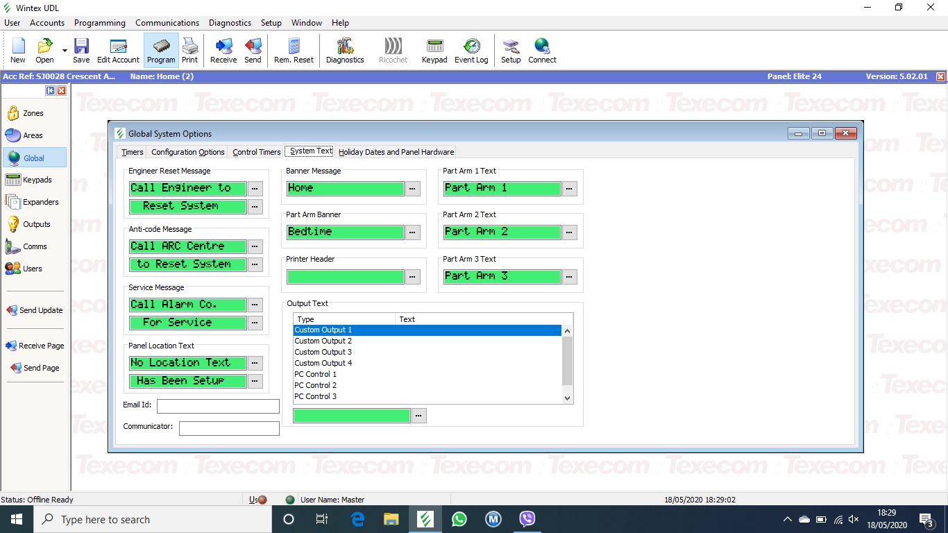

When you part set when your arming what does it say on the keypad.
What text do you have assigned to area arm suites and to part 1 2 and 3

that sounds good, like I say I believe the part set was behaving the way it was because the area arm suite was programmed.

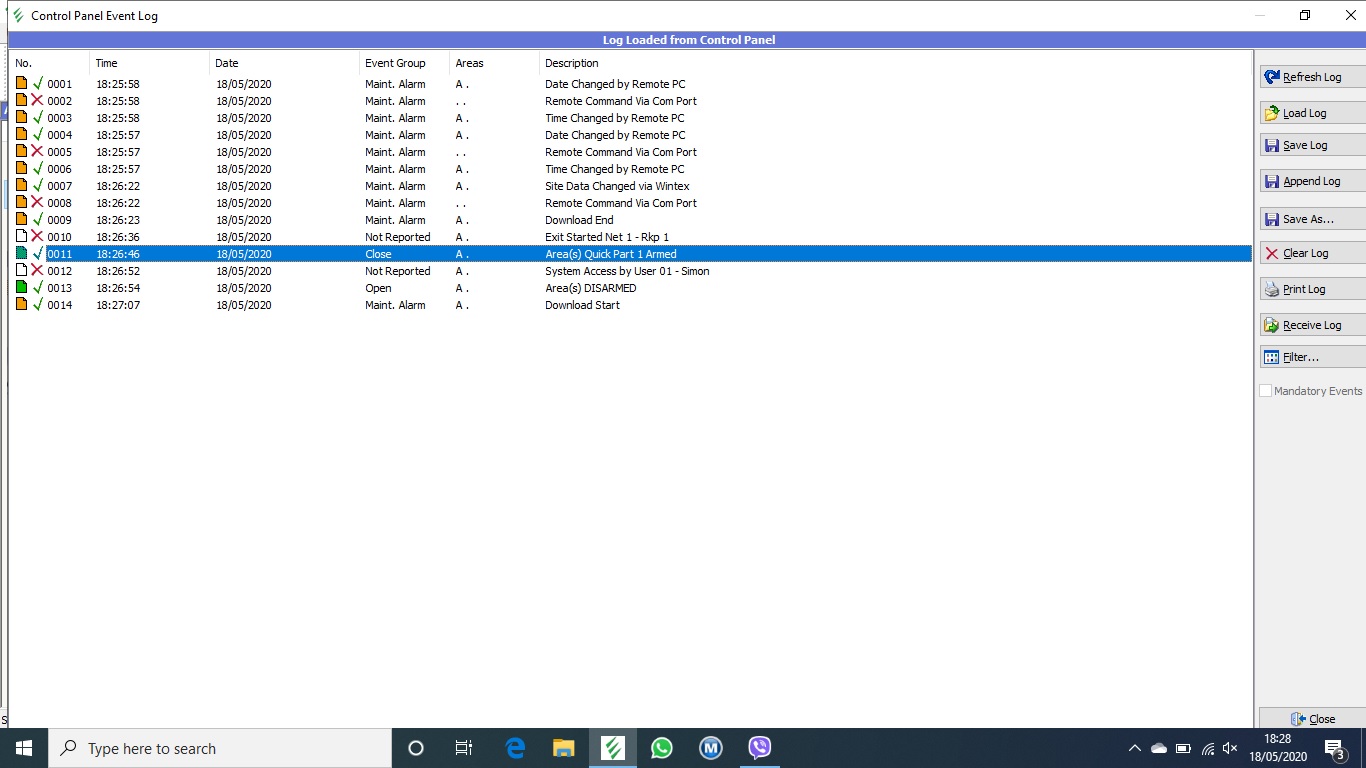

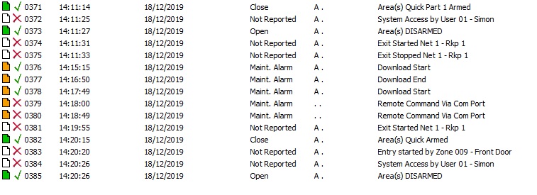

you should note what is now recorded in the log when you part arm, but if you have changed all the text entries it may be difficult to prove one way or the other.

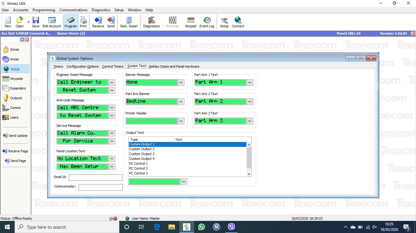

ok, i have given all text entries different wording and part set again to confirm the banner / logs
The banner on the keypad changed to Bedtime, which is the part arm banner so all good here

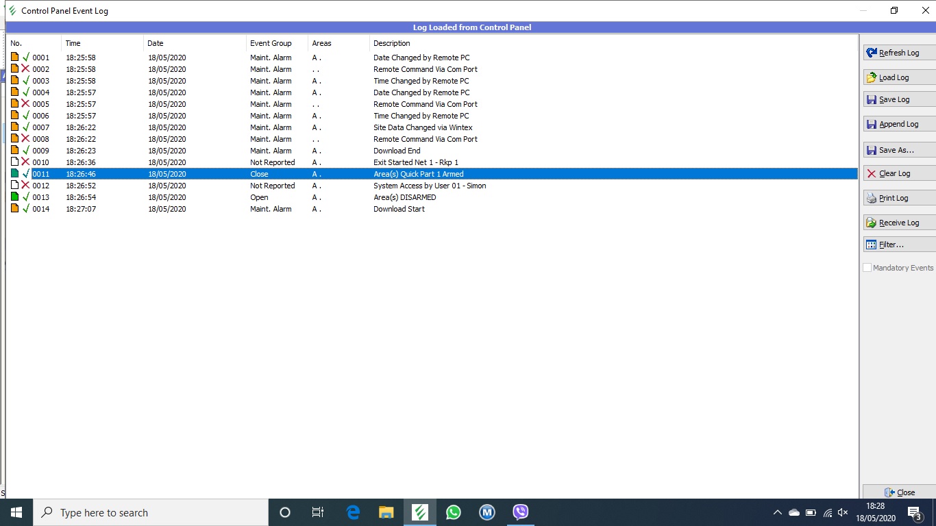

Logs say Area(s) Quick Part 1 armed

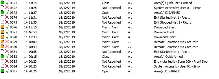

So, just need to work out why the entry / exit needs to be closed before i can full set, or is this normal for this panel?

Ok, sorted the issue with the door being open when setting the alarm
I had "view exit errors" ticked in the global options, de-selecting this solved the issue
