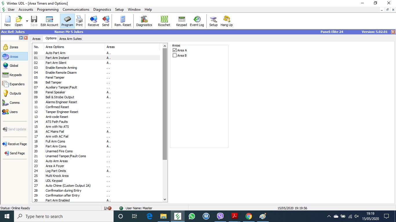

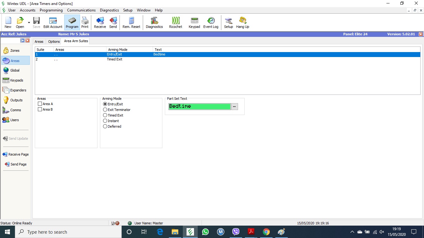

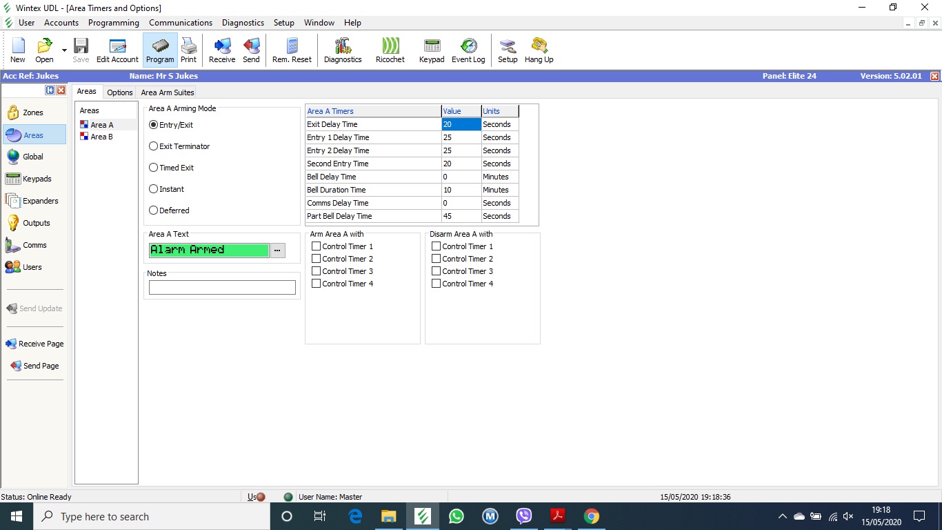

I have installed a Texecom Premier 24, 2 Keypads, Texecom Connect
Only 1 area (a) in use with no area suites configured
Simple setup
Full armed = all zones and entry/exit as arming mode
Part Armed - E/E zone changed to guard and one PIR omited
When i try to full arm the system, if the entry/exit zone (front door) is already open, i get a warning that zone is preventing setting, if i close it, I am then asked if i want to arm
If the door is closed when i full set the alarm, open it and then close it, everything works fine and the entry timer starts when i return to the property
Is this normal, I understood that the entry/exit zone was ignored during timed set?
