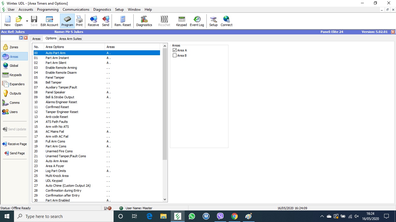

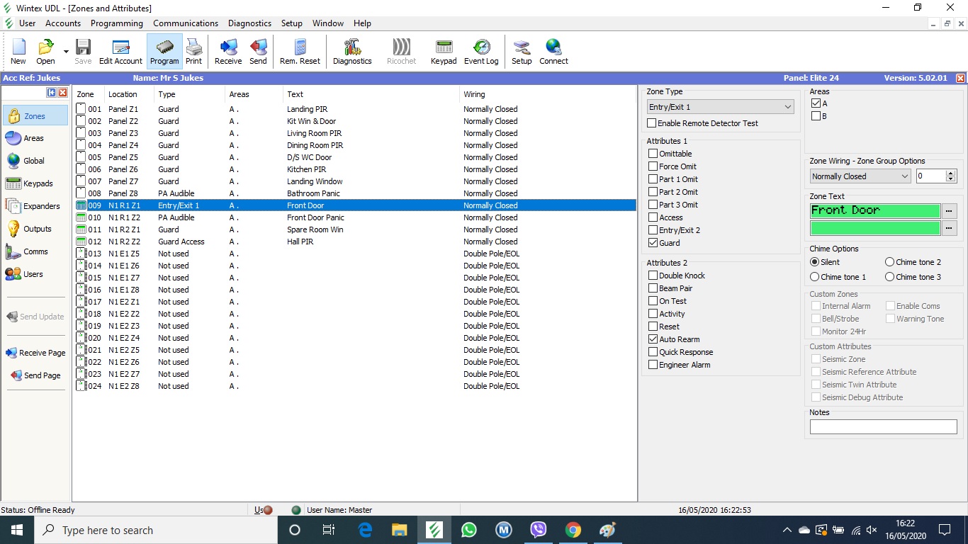

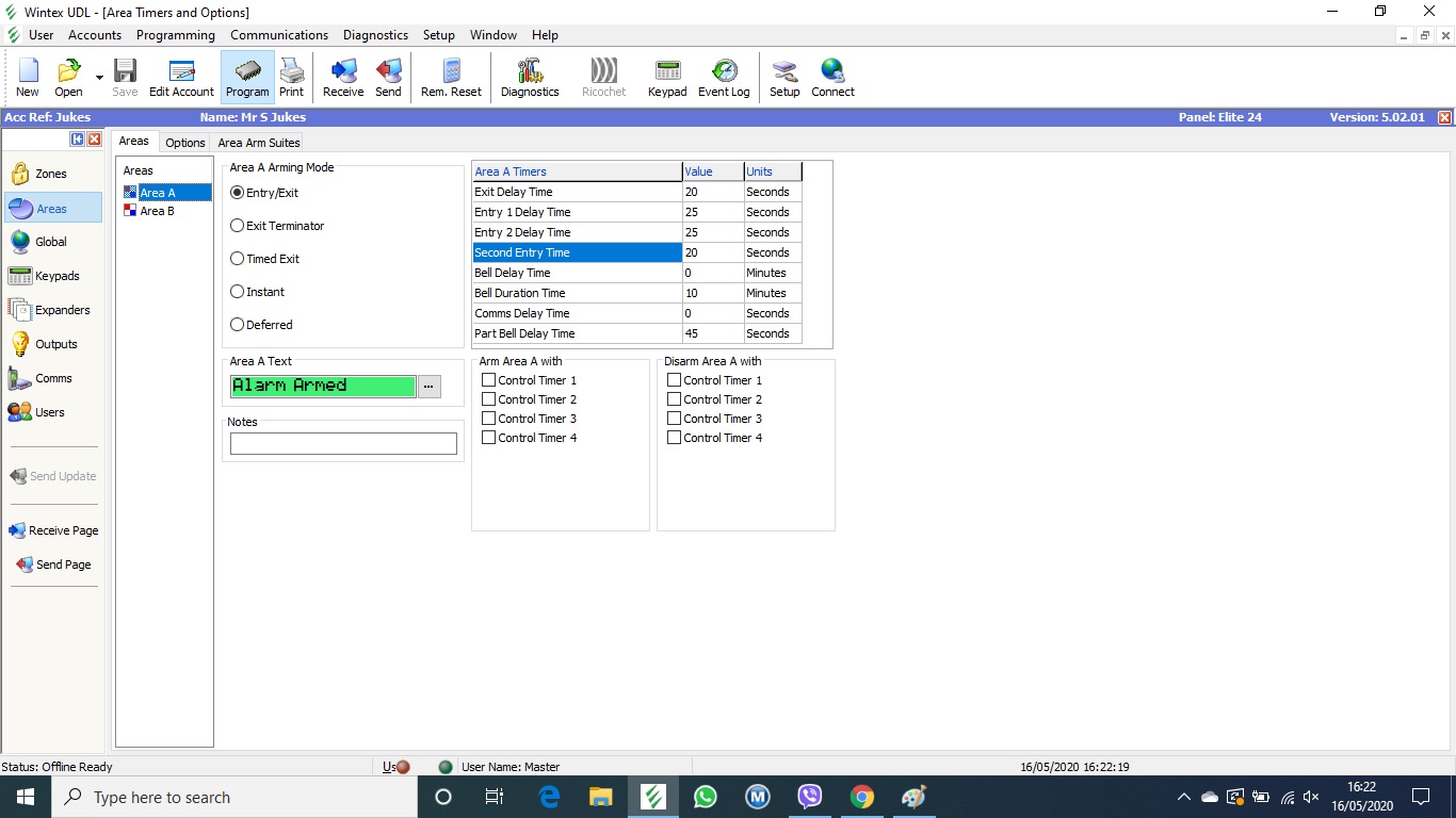

All zones are in area A, area A is using Entry/Exit as arming mode
No area arm suites are in use
The front door zone type is entry/exit with the attribute of guard (for when part set)
If i press 1-3 and then the part set button, the alarm arms correctly at night
If i full arm the system, either by entering code and selecting yes to arm or by just pressing area, if the front door is closed, I can open it, leave the premises and the alarm will full set.
However, and this is the problem, if the front door is already open, which most of the time it is due to the rest of the family heading to the car, the alarm will not set and says Zones preventing arming, so i have to go to the front door, shut it, the keypad then asks me if i want to arm
Screenshots attached of configuration

if its on timed then it wont matter.
on e/e needs to see door go open then closed.
when the warning comes on, close the door press yes and then open and lose the door how does it respond.
Are you sure it’s not because you have auto part set which automatically thinks you are part setting until you exit by the entry exit then switches to full ? If I remember correctly

silent part set could be an area issue depending on zone setup and area options.

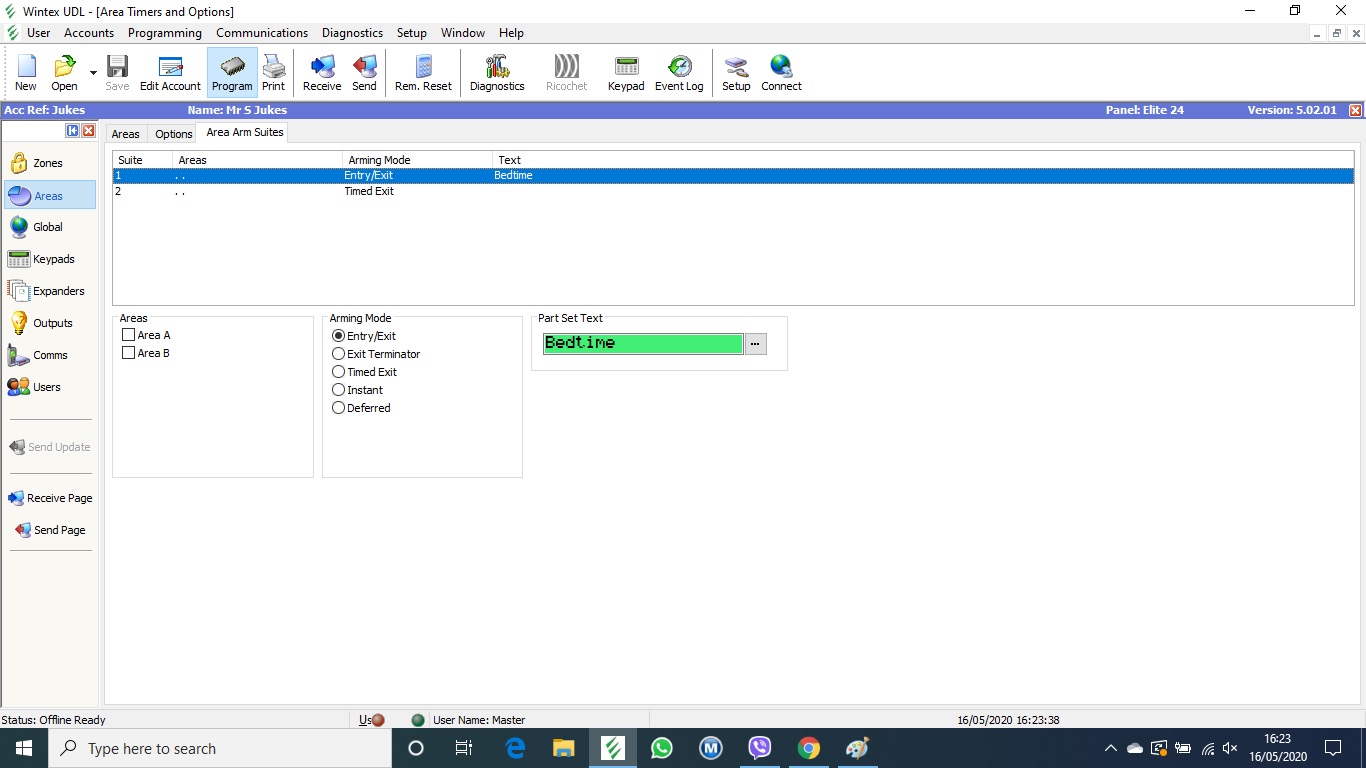

Could be area arm suites, as that is setting areas rather then part sets 1,2 or 3.
You can check the log to see what you think your are doing is different to what the panel is recording.
Agree re Area Arm Suites but not using any, going to check the logs now

Part ARM 1 evening arm at default
I think your using arm suites and the text you describe is for the part arm suite not part arm 1
Check the text for arm suites
I agree with you, but from wintex screenshot, I am not using arm suits, unless I am missing something obvious

Still think you have an arm suite programmed up rather than using part set.
When an arm suite is programed, pressing part brings up arm suites, press part again brings up the part sets.
This is where I think your at
