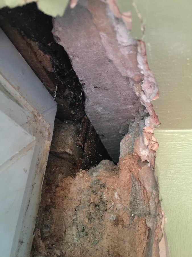

It appears to be 2 X 150mm ish wide
lintels separated by some form of DPC rather than one which should make life easier!?
Okay, you've got a gap between the inner and outer walls, so you can do then one at a time. Outside one first, then the inner one. If you use piers, you may still need a party wall agreement because you're attaching them to the party wall, but as you're not cutting into his wall, it'll be minimal aggrevation for him, and very little cause for him to complain - although he'll very likely look as hard as he can to do so. Will the other neighbor give you access to his garden to slide the steelbetween the acrows.

The strong boys sit on top of an acrow, which then sit about a foot out from the wall; they can have a tendency to twist a bit as you tighten them up if they're not pushed in very far, and that makes them even closer. Not a bad idea putting the steel on the floor, and then putting the acrows up, as long as it doesn't get damaged when the concrete lintel comes crashing down, because that's going to be heavier then the steel. Not sure whether you can get the steel done in 2 sections and bolted together and welded. Have you worked out how to get the concrete lintel out. Not sure if you could use a few acrows to support it and slowly take it down a foot so you can cut it into sections.
