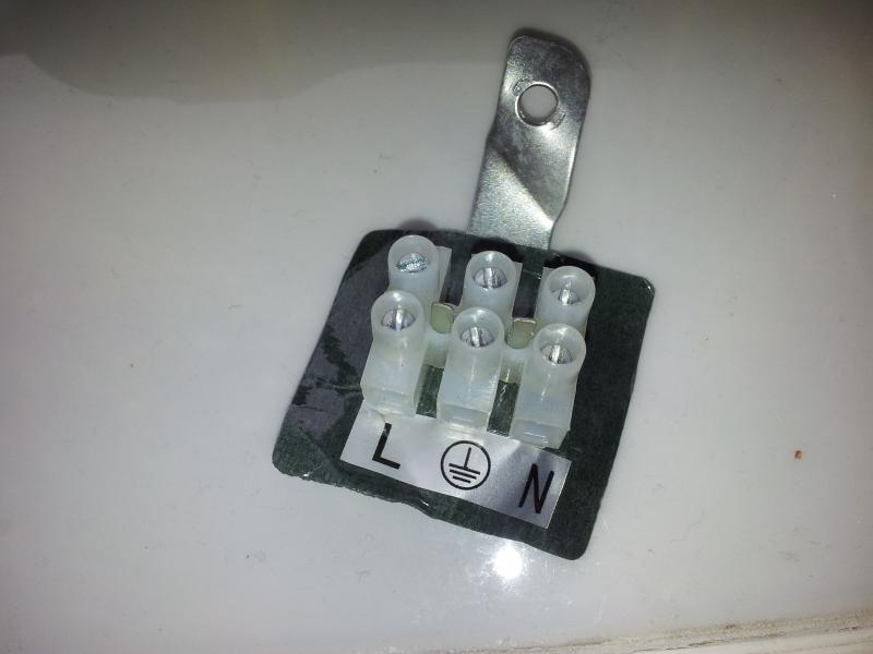

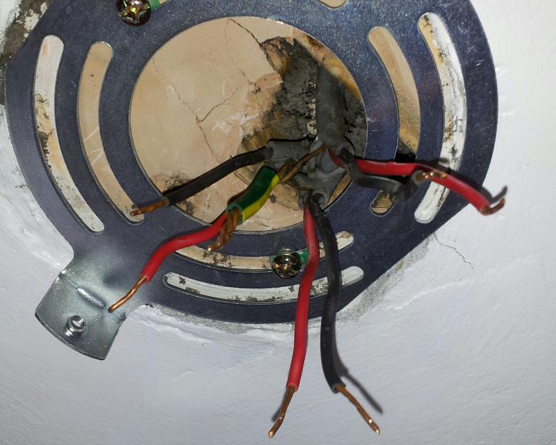

Anyway. I recently took down an old bathroom light fitting to replace with another but her dad did it cause he's better at this sort of thing. The point is I don't know what the wiring looked like previously. He left it with all the live connected to live and neutral to neutral butwhen iI turn on the light the fuse pops downstairs.
Pics attached. How do I connect this up? Three cables coming out the ceiling is confusing me....
The common problem is that all reds and all blacks are connected together, which is not what you do for lights and causes fuse/trip to go.
You need to identify the switch cable (which your father in law may have left disconnected. )
The red of this cable gets connected to the other reds.
The black has a bit of red tape or sleeve on it and gets connected into the light fitting L terminal.
A multimeter can be used to identify the switch cable.
With it set to continuity, so it beeps when the probes are connected together, with the power off, connect probes up to the red and black of each cable.
The cable that causes the meter to beep when the switch is operated is the switch cable.

Separating all the blacks and replacing the fuse wire with the correct size should get some lights working.
If this is a bathroom, there may be a loft space above.
If so, you can go up there and find which of those cables go to the switch.
Then you will be ready to connect up the light correctly.
