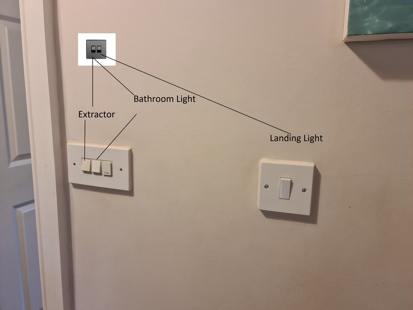

I have two bathrooms with a triple switch (extractor, lightswitch, fuse) and another separate switch for the opposite room light.
I've replaced the old extractor with an timed humidistat expelair that draws 7.7w max.
I'm going to combine the bathroom light and extractor, and remove the separate switch, moving it to a new smaller double bathroom switch as the image shows.

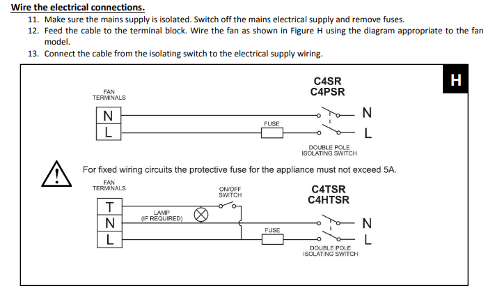

My question is about the fuse. Is it still needed for a 7.7w extractor? If so is there an inline fuse I can install behind the switch?
I am not an electrician but my understanding is that it only requires a fuse if the instructions say that it must be fused. Assuming it is on the lighting ring, I would expect that it is on a 6amp breaker.
I believe that it should have a 3 pole isolator, rather than being on a light switch.
https://www.screwfix.com/p/british-...1-gang-3-pole-fan-isolator-switch-white/69862
Yes youre correct. Should have read the manual!
This makes it a little more complicated.
I think I will have to install a separate 2 pole isolator near the floor outside the bathroom.
It is up to you what you do but, if on the lighting circuit, the fan does not need a fuse nor an isolator.
You might have to install a fused spur as well given that it specifies a 5 amp fuse...
It doesn’t. It says MAX 5 amp fuse. It is wrong anyway as the fuse is to protect the cable not the fan which should be internally protected.
His lights won’t be on a ring. Rings are for UK socket circuits.
Yeah, my bad. they are (typically) radial. I made the mistake of saying ring, when in reality, I should have used the words lighting circuit.
Sorry Winston, I do not understand. A MAX 5 amp fuse is less than the 6 amp MCB. The cable running to the device is protected by the MCB, the internal wiring? I have no idea. They specified 5 AMPs, not me.

capture-png.246734
Those instructions are quite interesting and one for Winston's "wrong instructions" collection.
They are clearly written and drawn by someone who just thinks that is what one should do with no regard to the regulations.
Usually such instructions call for a 3A fuse and people argue that there might be something in the fan that requires 3A protection rather that 6A on the circuit. If there is - there isn't - then the manufacturer should fit a fuse in the fan - that's why they don't.
Not to mention the horrible rest of the world fitting the same fans on 10A or 16A circuits with no fused switches being available.
There is no argument that a 5A fuse has any advantage over a 6A MCB so stipulating one is just pointless.
As to the positioning of the double-pole isolator before the light: this negates even the convenience of having an isolator so that, with a fault, the lights will still work - or the silly "You can work on the fan with the light on".
The Wiring Regulations do not require local isolation for any appliance; not even the cooker or shower.
So, were one to fit a three-pole isolator after the light, would one then be not complying with the manufacturer's instructions.
