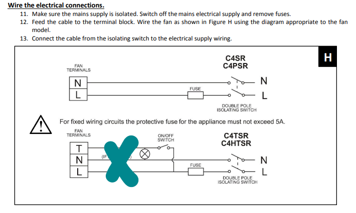

Perhaps the solution is a 3 pole MCB of say 0.5A rating to serve as an overcurrant device and an isolator.
Edit: Or perhaps a double pole with an auxilliary contact.
Assuming the wiring at the fan switch only consists of two 3 core+earth cables (feed in - perm L, sw L, N and load out to fan - perm L, sw L, N) I don't think you can connect a combined unit with 3 pole switch and fuse module so the fuse protects both lives.
Good point. I sort-of misread (or 'mis-thought about') what you'd written, and was trying to think of a way it could be wired which would not result in the switch isolating both L and S/L, not the issue about fusing to which you refer.
So, yes, I agree that with just the wiring that had previously gone to/from an isolator, one could not swap it for one of those isolator+fuse thingies and have both L & S/L protected by the fuse.
Kind Regards, John
Unless I am missing something, to make sense, the switched live would have to originate after the fuse, as in the manufacturers diagram of post #3.
Indeed, as has been said, if one really wants to add a fuse, it has to be upstream of the light switch.
Which completely negates the need for a three pole isolator! :confused:
Not in the minds of those who want to be able to isolate just the fan (leaving lights working), whilst the fan is fault or whilst one is working on the fan (as well as having the upstream fuse).
Kind Regards, John
As has very often been said, if the manufacturers really feel that the product requires 'tight' protection (0.5A or whatever), then that should be provided internally within the product, leaving the circuit's OPD to protect the fixed wiring of the circuit!
Having said that, I seriously struggle to think of what useful purpose such 0.5A (or whatever) protection would serve.
I never have, and never will, provide any of these fans with a fuse as 'required' by manufacturers!
Kind Regards, John

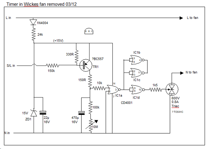

In this case: ,annotated photo of a fan timer module> (Not my work!) ... the switched live goes through the 270k resistor and a 15V zener before reaching the logic circuit. Theoretically, no need for a fuse ;)
I'm sure that I posted these a year or two back but, for anyone interested, below typical circuits (two diagrams) of these things, mainly ascertained at 'autopsy'! As can be seen, they are all very similar, the Wickes one being slightly different, in having an (essentially unnecessary) transistor.
Kind Regards, John

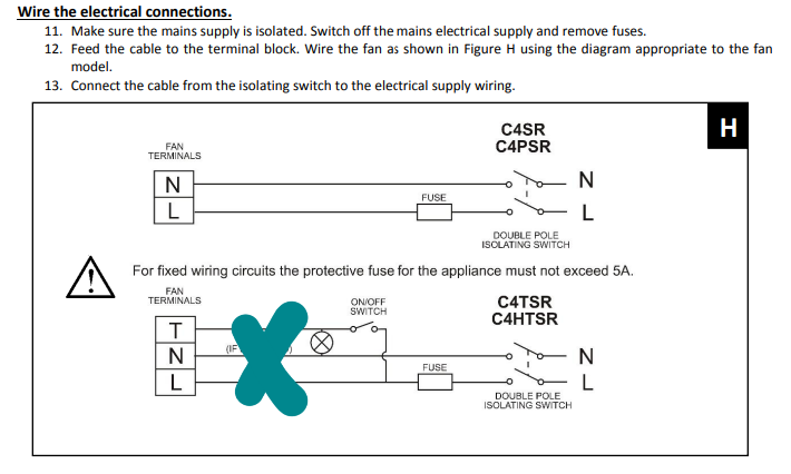

Bernard posted a diagram in another thread.
0x92-jpg.164831
As can be seen in the diagram the fuse *does* connect directly to one of the poles on the isolator.
I suggest implementing this by using the isolator/fuse plate as the junction box. The light, switch and fan can then be connected to the isolator/fuse plate using normal T&E and 3+E cables.
Only if one is happy to have to lose the light when 'isolating' the fan. If one want to have the fuse (priotecting both L and S/L) AND to be able to isolate just the fan, then one has to have the fuse and isolator 'in different places' (electrically),, not within the same 'unit' - which is perhaps your point, since you go on to say ....
Kind Regards, John
Yes, that was what I meant, but again, sorry John :)
I was tied up with the original diagram in post #3 and couldn't immediately see where the 3 pole isolator would go to make sense.
And I was just about to post my X marks the spot picture, when plugwash beat me to it! :)
He did.
... As can be seen in the diagram the fuse *does* connect directly to one of the poles on the isolator.
It does, and I don't think anyone (certainly not I) have suggested otherwise - but, as you go on to say ...
....I suggest implementing this by using the isolator/fuse plate as the junction box. The light, switch and fan can then be connected to the isolator/fuse plate using normal T&E and 3+E cables.
Indeed - but, as sparkwright said, as a 'retrofitting' exercise, that involves appreciable 're-wiring' (i.e. if being done on an existing installation).
As I've said, I really cannot get myself interested in fitting these fuses - and, if one doesn't use them, then life become much more simple, even if one wants an isolator ('for very occasional convenience').
Whoever thought up that 'isolator + fuse' combination of modules probably had not "thought it through" (any more than I did, initially :) ).
Kind Regards, John
He did.
Alternative options involving less rewiring would include,
1. Disconnect the feed cables from the light and use a JB to attach them to a new cable running to the fuse/isolator plate. Then use the existing 3+E to take fused live and neutral from the fuse/isolator to the light and switch (via the light) and bring switched live back.
2. Replace the switch drop with 3+E and locate the fuse at the lightswitch rather than at the fan isolator.
3. Locate the fuse separately from either the fan isolator or the light.
4. Cut out a larger box at the fan isolator location and fit two fuses.
