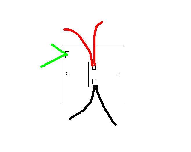

I have a little query that I have failed to get an answer to from various sources.
My house was build in 1992 and has RCDs in consumer unit but with cartridge fuses rather than MCB (which is fine)
As you would expect the lighting circuits are separate upstairs and downstairs.
However in both circuits I have a single fused plate with a 13A fuse in it. As far as I can tell the lighting circuits run into this fuse plate, but not "through" it. Ie. Black into north terminal, black out north terminal. Red into south, red out of south. So the fuse is accross the positive and neutral loops.
It makes no operational difference whether fuse is present or not and my guess is it's somehow related to safety in the circuit, but what? Do I even need it at all?

Yes, I'm not describing it very well, but then I dont really know the terminology.
I attach a rough sketch of what I saw (thought I had picture, but apparently not). I have two 3 core cables running into box connected as shown.
I agree with you though, I dont understand why it doesn't just blow? I can only imagine that it must be doing something else beyond my comprehesion but what, i don't know. Any ideas?

Do the two red wires actually go into one terminal? Do the two black wires go into one terminal, or two? How are the terminals in use labeled?
From your drawing it actually looks as if the FCU is being used as a loop in loop out junction box.

Unless you can read the terminal markings, you can't really be sure the wires are connected across the fuse as you describe.
I would expect the two reds to be in the L 'feed' terminal and the two blacks in the N 'feed' terminal.

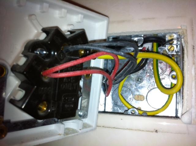

Right, after all your comments I had another look. I think I can see what it's doing now, if not why it's there.
The fused plate as (pictured) shows it's just in the circuit and just not connected to anything, as is the other one down stairs. What these were intended for I dont know. The only other oddity is the large earth connection that I think runs all the way back downstairs to the consumer unit.
Thanks for all your queries that cleared this up

That one is in the bathroom. There is another one downstairs under stairs. There is a small electric heater in bathroom but is connected via it's own 35a spur.
I guess they were put in at build time but just never used. As they are on the lighting circuit their usefulness is limited but I imagine a lit cabinet/shaver socket would be ok
How sure of that are you? Given that it's in a bathroom, it's possible that it's a 'bonding' connection to local pipework. If that were the case, it's been done in a pretty iffy way, since the conection between it and the 'earth' conductors of your wiring is dependent on the contact/screw beween the earthed parts at the back of the switch and the metal back box - it would have been better if there were an explicit connection bewteen that fat earth wire and the earth terminal in the back box.

Interesting thought, it could well be. But if so it will hidden behind all the boxing for the pipe work before running down to ground.
