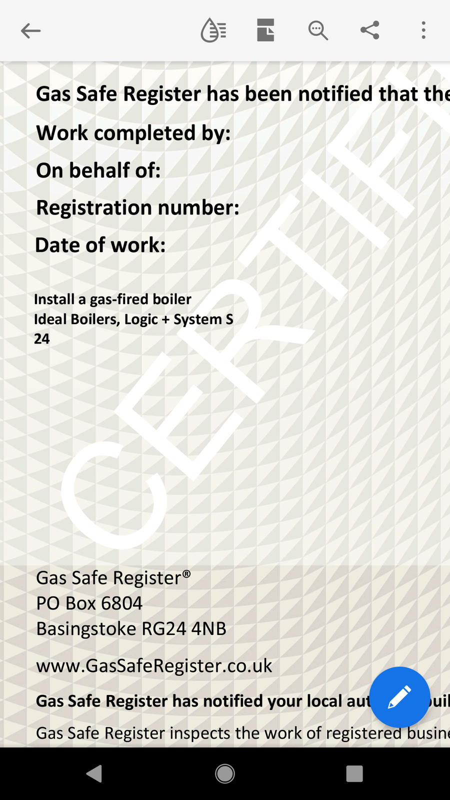

Hi, sorry for the delay. I've been trying to get to the bottom of this. So firstly, the company have said they will forward the engineers certificates to me. I guess it wouldn't matter if they aren't listed on gas Safe as having the unvented registration so long as I've seen their certificates?
Regarding the building control notification, they are saying that as they weren't the original fitters, they don't need to notify? To me that sounds odd as the relocation to the loft was pretty much a fresh install in terms of work required. Secondly, I got my old certificate from Gas Safe and just wanted to check this is the correct notification for an unvented cylinder?
Nope that is notification of your boiler not your unvented, that doesnt come from Gas safe
Oh, I'm so confused now! o_O
The council are telling me the following:
"I’ve just checked your property history and we have a record for “Install a gas-fired boiler” ref no. CP/xxxxxx/GASAFE"
Doesn't specifically mention an unvented cylinder either? Could that mean the cylinder wasn't registered and the plumber just notified about the boiler?
Sorry, this is a bit new to me.
the correct way to install an unvented is your G3 engineeth applies for a warrant from building control before any work commences, once work is complete, building control check the installation and isssue the certificate, it has nothing to do with gas safe, you can have unvented with electric heating or oil heating it sounds as if yours was never done in the first place, which to be honest is the norm unless it is a new build, most I see installed were never notified, doesnt make it right, just the way it is
