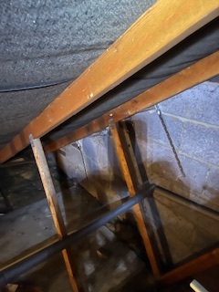

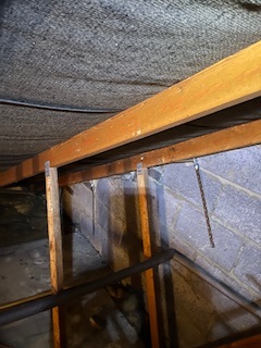

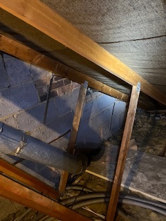

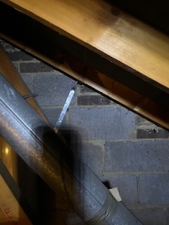

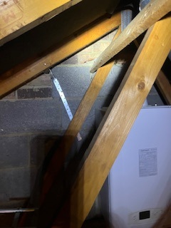

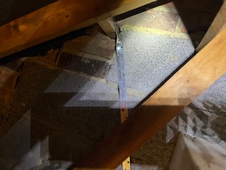

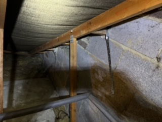

Looking for some opinions and advice please.
Purchasing a 1980s house. Surveyor has recommended lateral restraint straps are fitted within loft space to gable wall in line with current building regs to prevent wind issues.
I have had someone do this. I anticipated horizontal straps to be fixed across several trusses (ideally with large noggins between the trusses also) and then bolted to the gable wall (ideally somehow on the external side).
From the attached photos of the installation, it appears instead twisted metal straps have been used and simply the large section bolted to the gable wall and then the small twisted end fixed with one or two fixings to a single small pre-existing noggin.
Is this effective and correct? Any help would be greatly appreciated. Many thanks in advance.

The staps are wrong, and are not doing anything.
They should have been fitted on a noggin or 4x1 across at least three trusses then put into the cavity to "hook" over the inner leaf. Or some other arrangement of fitting to the gable as directed by a structural engineer.
If your trusses do not have timber bracing - which it looks like that don't, then that should have been picked up by the surveyor and recommended for fitting as that is a much bigger issue.
