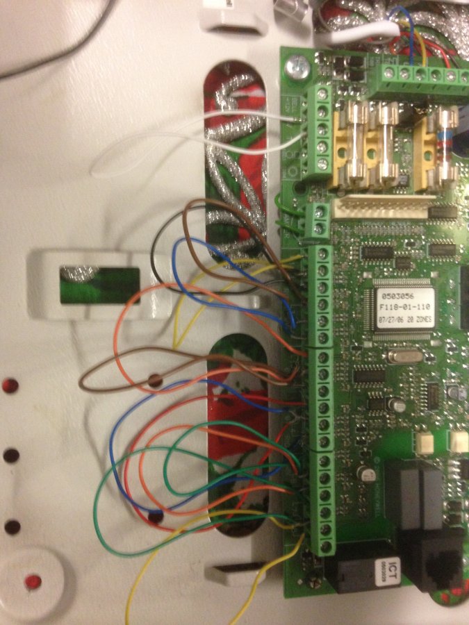

Someone told me these were easy but this is driving me mad I've looped all zones and can now set and unset I've not yet programmed each zone but I'm getting 12 tampers and 1batt fault the tampers are on zones 1001-1004 and on zones 1011-1018 any ideas how to get rid of tampers

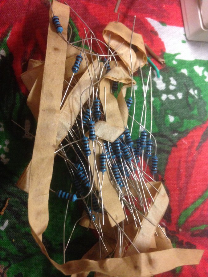

You can not link zones out with loops,you panel is EOL and you will need 1K resistor to link out each zone,that's why you have tamper faults

Replace each loop with resistor in each zone,leave loop in bell tamper

Next question I keep getting tamper on zn15 I've changed resistors but still showing on that zone is there anyway I can program it out .

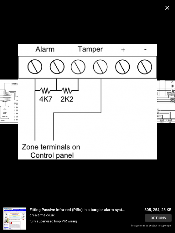

Also wiring a pir from panel
0v
2
For example yellow 0v
Blue -2(leave resistor in 1 and 0v
Pir
Yellow and resistor in alarm nc
Blue and another resistor in tampers
Would this be correct thanks
Wire your pir as above but with 1K&1K resistors and not 4k7&2k2
For zone 15go into zone programming and make not used
