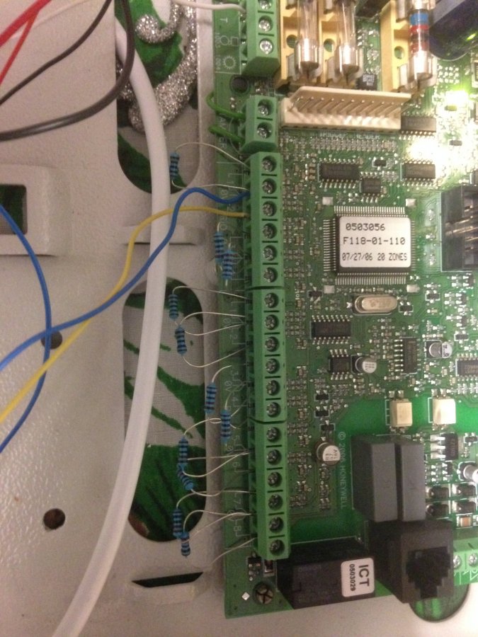

New problem think it might be the board the tamper on zn 15 and zn 18 keep coming up I've programmed the zones as inactive but the tamper still shows any ideas thanks
I've gone into 51 parameters
46 zone resistance
It's defaulted to 1double balanced
I've changed that to 3 eol
It's sets and activates
And when I go out of engineer mode it comes up
System modules
Was 02 now 02 then goes to normal screen??
Have you got resistor in panel to link zone out ?
Post photo of PCB with zones linked out
Is this right ?
Looks like you have the legs of the resistors on other zones touching each other.
The resistors are in the terminals correctly but should not be touching other resistors in the separate zones.
That could be causing your z15 and z18 issue

No just looks like that none r touching .since changing the zone resistance . The tampers are not showing
0- normally closed
1- double balance (default)
2- end of line
Set the panel back to double balanced, as you're just masking issues otherwise. Select display zones and then step through the zones selecting the hash key to display the actual resistance being read. A zone set to spare may show as tamper if no 1k resistor fitted, but it will not stop you exiting engineering mode.
Done that it flashes tamper on zn 15 and zone 18 and on bottom line says 13.42u and o/c
Okay, so open circuit. With the panel power off and your resitors still fitted, what is the resistance between the screw terminals ? If it is above 1k, then your resistors are suspect if the resistance at the screw terminals is around 1k, then the board is faulty and those circuits may be damaged. As per previous, you can just set them as SPARE and the system will ignore them and should exit engineering mode without any issues.
