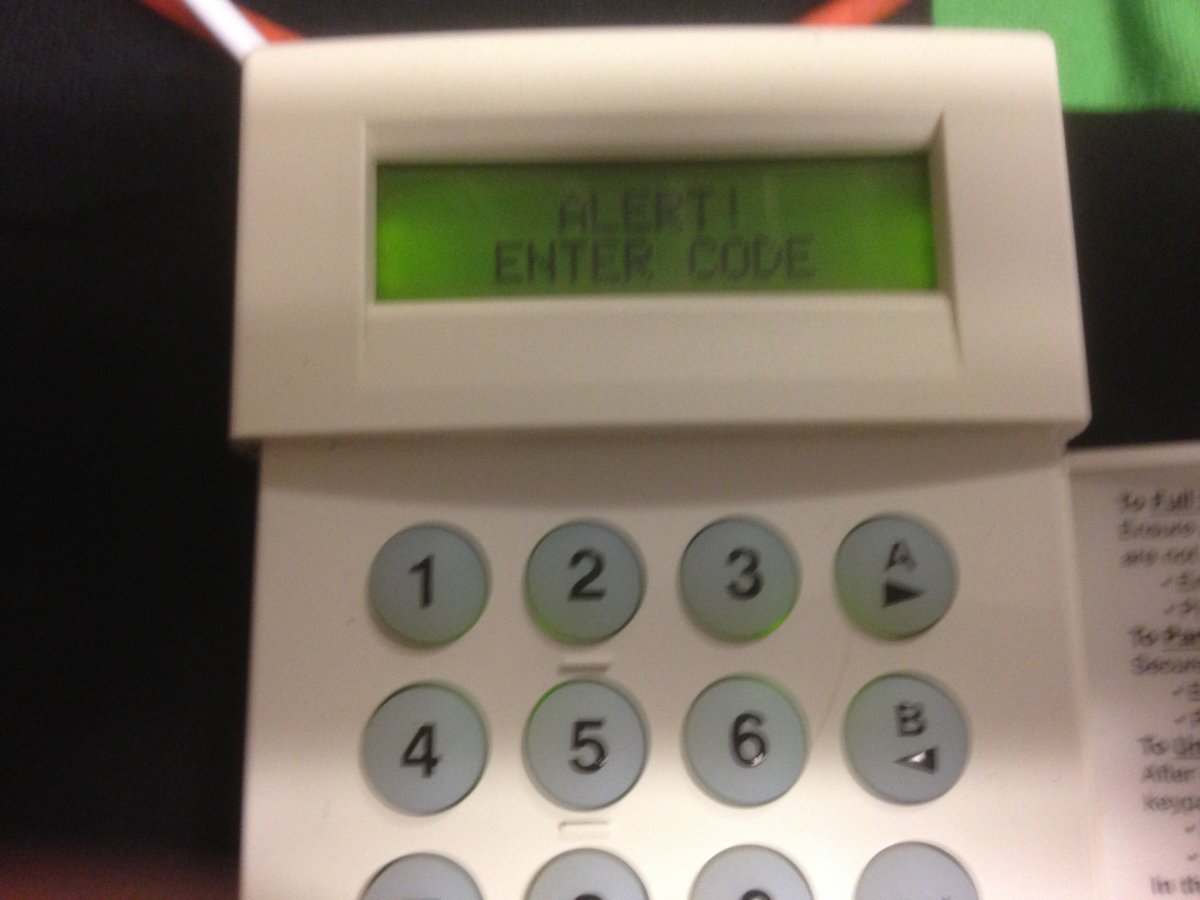

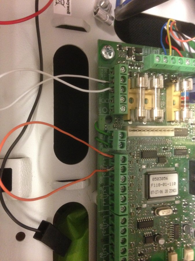

Have read that if I short zone 1 and loop 0v and tamper on bell it will default but need to know how to short zone 1 thanks
Ye its second hand just been reading around to see if I could default it tryed the tamper and 0v and think it was loopin zone 1 and powering on off etc also found some pin on pcb but they don't do much think there something do with keypad some say it works others say no so not really sure thsnks
So (just checking I got this right ) would this be right .then power up .

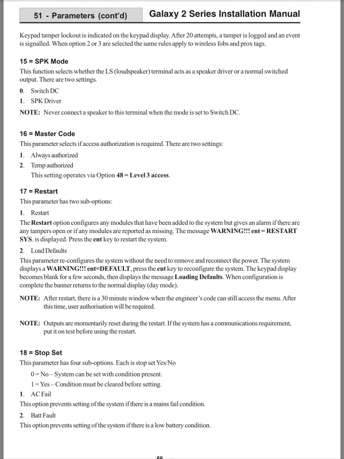

Got all codes do you know how to do a master reset thanks

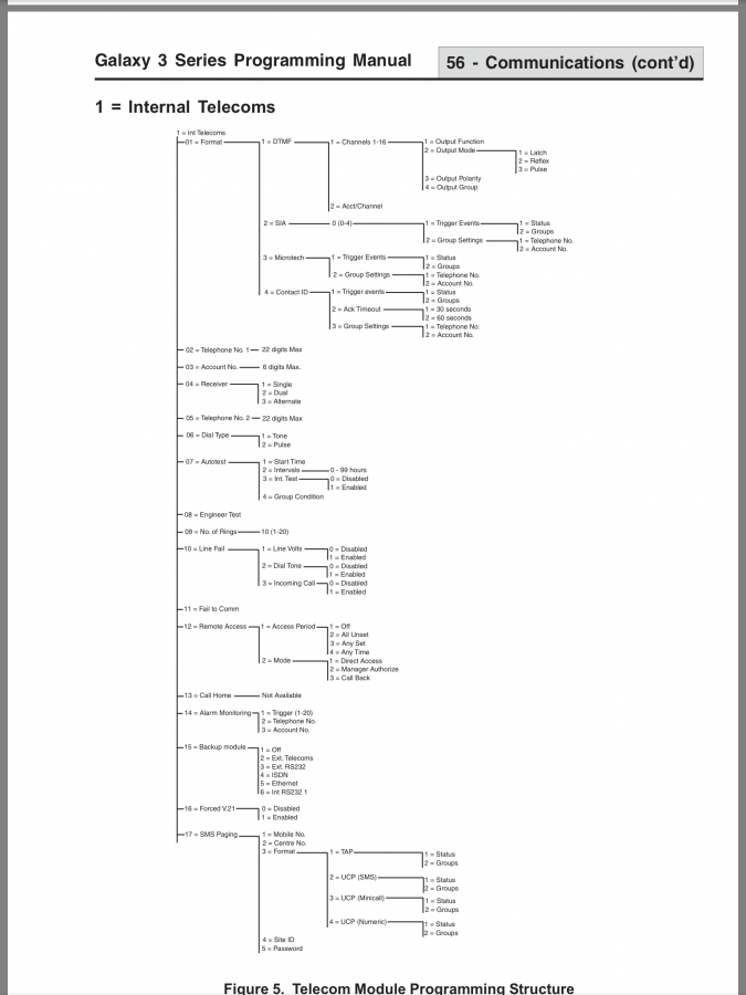

Tryed this just resets panel and codes I've read and read manual (I've been reading for Galaxy 2-20 and 44 ) I've got rid of all faults except line fault but can't seem to find how to turn off been in coms and can't get out of engineer mode ( I've tryed putting in code again and then esc ) thanks
Option 59
10 line fault
1 line volts make disabled
That will turn line fault monitor off
